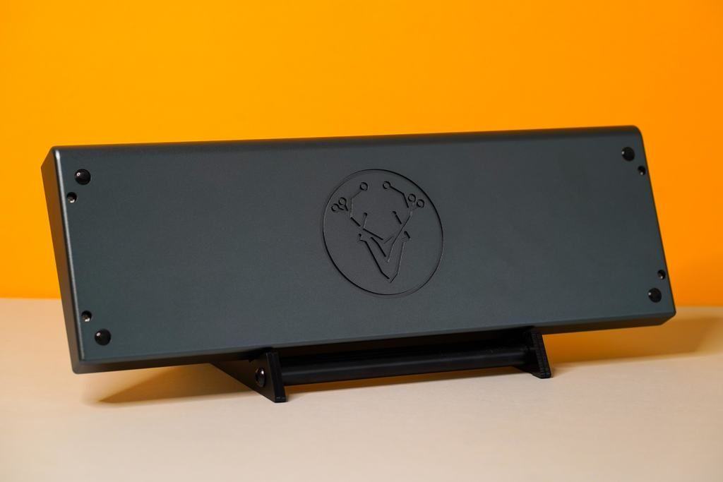

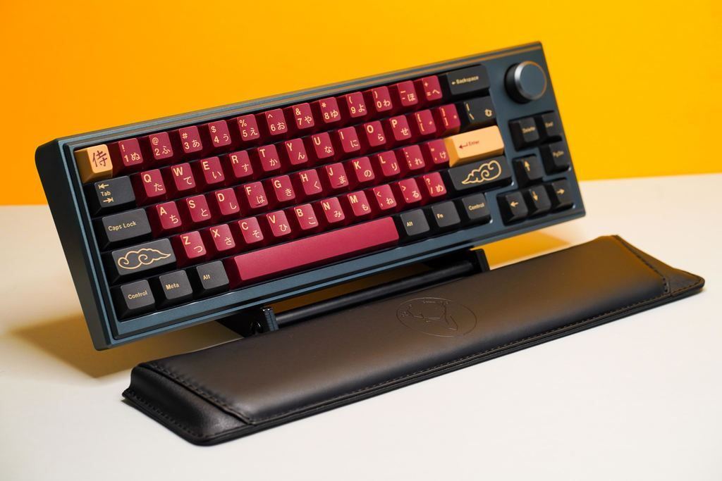

GMMK Pro seems to be a great kit. From what I hear they fixed most of the issues people had from the Group Buy launch. And personally I love that GLORIOUS carve out on the back panel. I personally dont need an F row which is the only reason I didn't get one.
My grail is this guy. Just went into Group Buy. Limited to 500 units.
Checked all my needs; aluminum, no F row, no numb pad, separated arrow keys, 2-4 extra keys, and an encoder knob. I got it in white because most keysets I like look best on white cases.
Back panel even has their logo engraved... but not as cool as the GMMK.

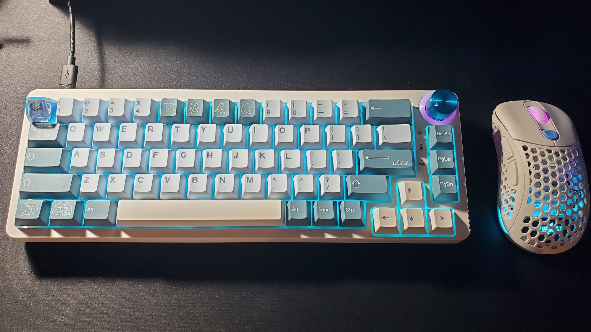

I got my first GB in. It is a mounted macropad made to mount to your desk, monitor, keyboard, or whatever you want. Had the choice between 3 key, 5 key, or 7 key. All with encoder.
I'll be using mostly while watching streaming shows and youtube so I can slide my keeb away under my monitor. That is what the left skip, right skip, and play/pause are for (right 3 switches).
As well so I dont have to worry about keyboard layers while gaming so I set a screen cap macro and F5 for quicksaving. lol
Overall I am very happy with it. Solid build. Very clean. Encoder feels down right sexual to turn. It came with Cherry MX Reds which aren't horrible. I'll be learning to solder at some point so I can swap these cherry linears out for some nice tactiles.
Created by https://www.pikatea.com/

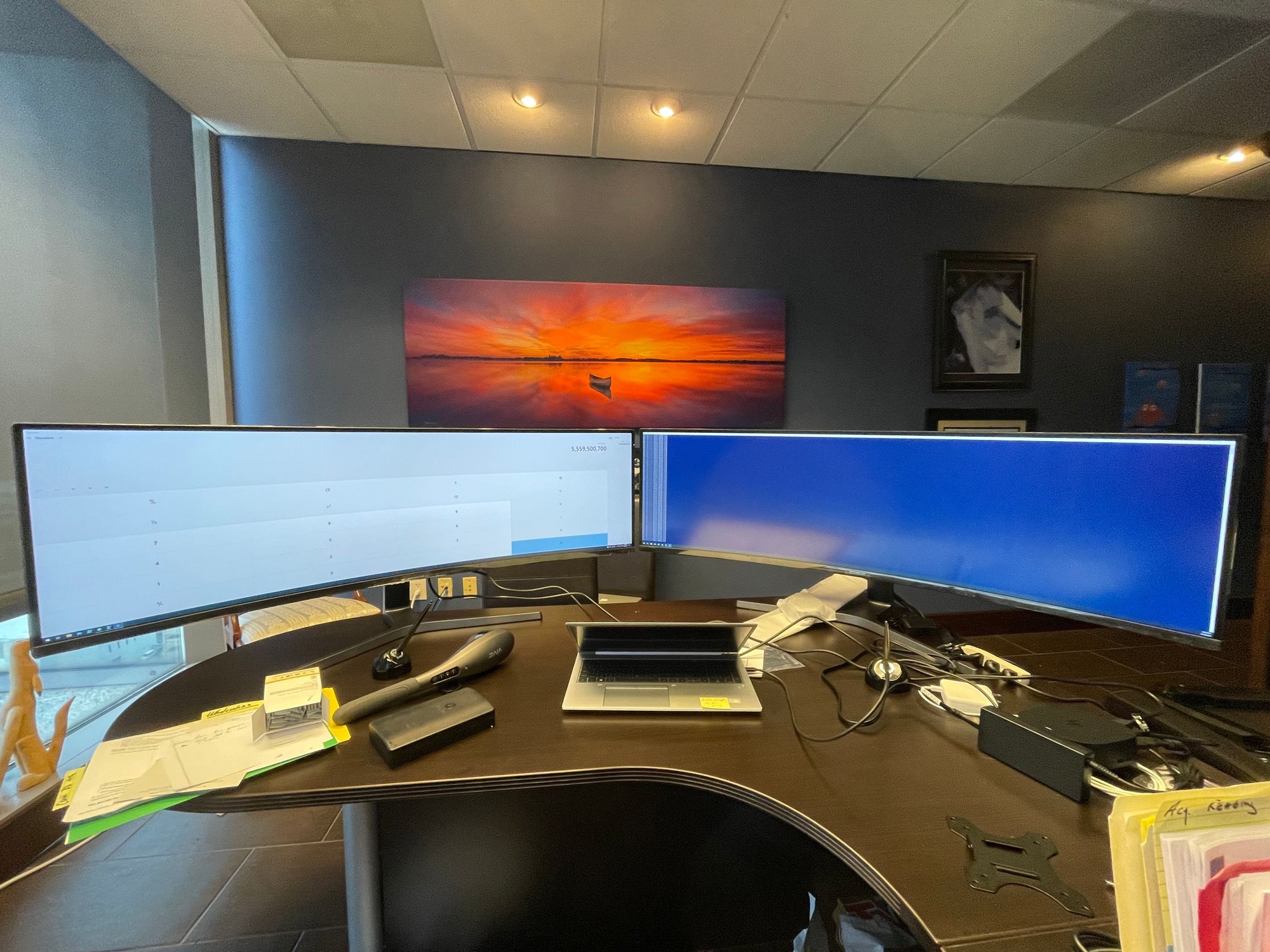

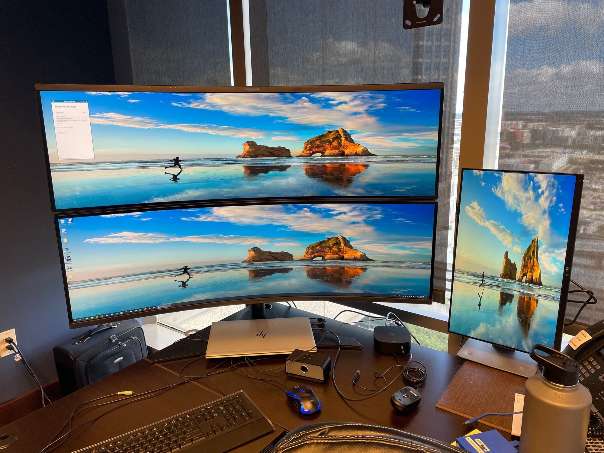

I spent a while researching these monitors for a client, got to unbox them and play with them for a little bit today. I think I might get one of these for myself, instead of the 4K model.

OMG yes the Neo G9 would be the one, might wait for it to get cheaper. I just got a 65in Samsung Neo QLED QN90A TV on a labor day sale and it is sooooo good. It's like the first TV to have little if any flaws visually, it does everything. Any TV that's better than it will only be marginally better and may only be noticeable in certain situations.
Those are the Samsung CRG9 1440P (1800R)
https://www.samsung.com/us/business/...c49rg90ssnxza/
Each one is equal to two 27in 1440p monitors. Mounting them has been the biggest issue. We're going to stack one on top of each other but normal monitor mounts can't handle them, and TV mounts are too big. They weigh 25lbs each and most monitor mounts max out at 22 lbs (10kg), I found a mount that said it supported up to 31lbs so I thought it would work, nope!
They weigh 25lbs each but because of the curve they are very front-heavy so the weight has a leverage effect that makes 25lbs seem like 40lbs (guess) on the joint that holds the monitor up which causes it to fail. We found a monitor mount that's made specifically for these Samsung 49in wide monitors, so I should be finishing this job next week. The mount was "on-sale" for $350. But it's going to be so dope when it's done. I want him to have a 3rd monitor in portrait orientation too, we'll see how that goes.
The only thing I'm concerned about the Neo G9 is the 1000R curve, I guess that's good for gaming but that might be too much for day-to-day use. I'd like to see it IRL. But mini-LED is awesome! Honestly, it's so good it makes micro-LED seem unnecessary and impractical.

I finally taught myself to solder so I can mod my corsair K65. It was just to learn to solder. The K65 is alright for a prebuilt keeb but now that I have a custom and have others planned I dont see myself ever using it again.
It is a 60% case I painted in a minty teal color.
Desoldered all the factory Cherry MX Speed Silvers. Lubed them with Krytox 205g0.
Tuned and lubed the stabilizers with more 205g0, replaced the spar bar stab because the stem looked almost melted in two spots. Must have been a bad mold.
I had one white durock stab left from my TM680 build so I used that. Clipped the rest of the factory stabs as well for a better bottom out feel and more solid thoc.
Added some sound dampening so there would be no case echo and put on the keycaps I dont think I'll ever find a good build for... turned out... well...
The mouse is a Pwnage V2 Ergo wireless. The honeycomb shells are magnetic and easily swapped out for different colors or non honeycomb shells. Im using it in all white with a blue DPI button to match the TM680 I posted before.
Currently waiting on way too many GBs. Next up is the Aozora 65% case which will be getting the Azure Dragon switched I already lubed and probably the Port caps I have sitting around collecting dust.

Finished up the ultrawide monitor setup yesterday. We had to get a mount specifically made for these beasts. It costs almost $400 but it works great, it even had us flip the top monitor upside down in order to shrink the bezel in the middle
All of those pixels running off of one USB C cable from the laptop

Geezus. So that’s basically like 4x 1440p monitors in a grid ya?
wouldn’t it have been easier to get like a 48” LG C1 OLED TV? resolution would be lower thou…..

no
ain't putting this shit in a client's office and telling them to do all this
