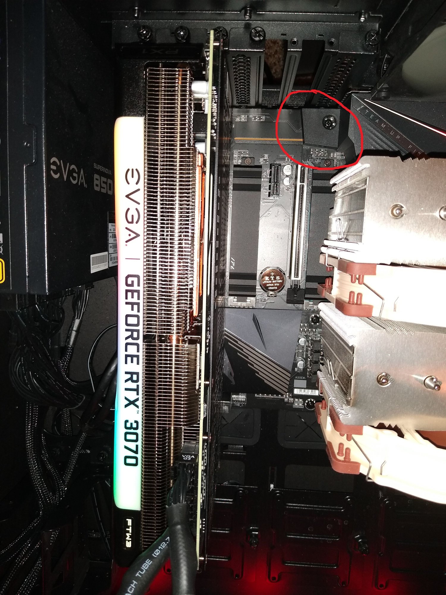

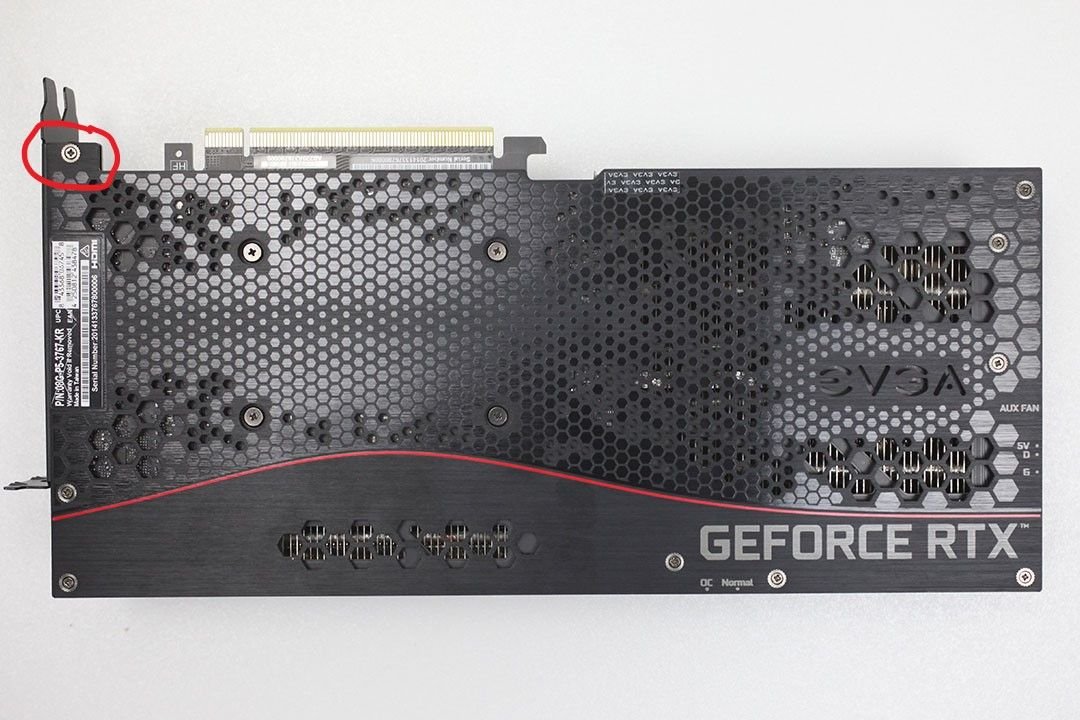

Alright....I'm gonna look real stupid right now....just realized I been running the GPU at the PCIE 3.0 x4 slot instead of the PICE 4.0 x4 slot....so trying to move the GPU over to the 4.0 x16 slot and realized the 3070 wouldn't seat fully into the slot cause damn Gigabyte made the mobo have a weird plastic part that prevevents it from fully seating:
Cause the EVGA 3070 FTW3 card has part of the board that juts out just a bit, circled red....which hits that other part circled red above...and prevents it from being slotted properly into the PICE 4.0 x16 slot.....FML....
Sigh...........not sure if that part of the mobo can be taken out or shaved down.....might need to look at another board....terrible design by GIgabyte on this.....
I was looking and saw that a PICE 3.0 x16 slot is likely not a bottleneck even for a 3070...HOWEVER the slot I'm using seems to be a PICE 3.0 x4 slot...which I assume will be a big bottleneck...x4 vs x16....sigh....

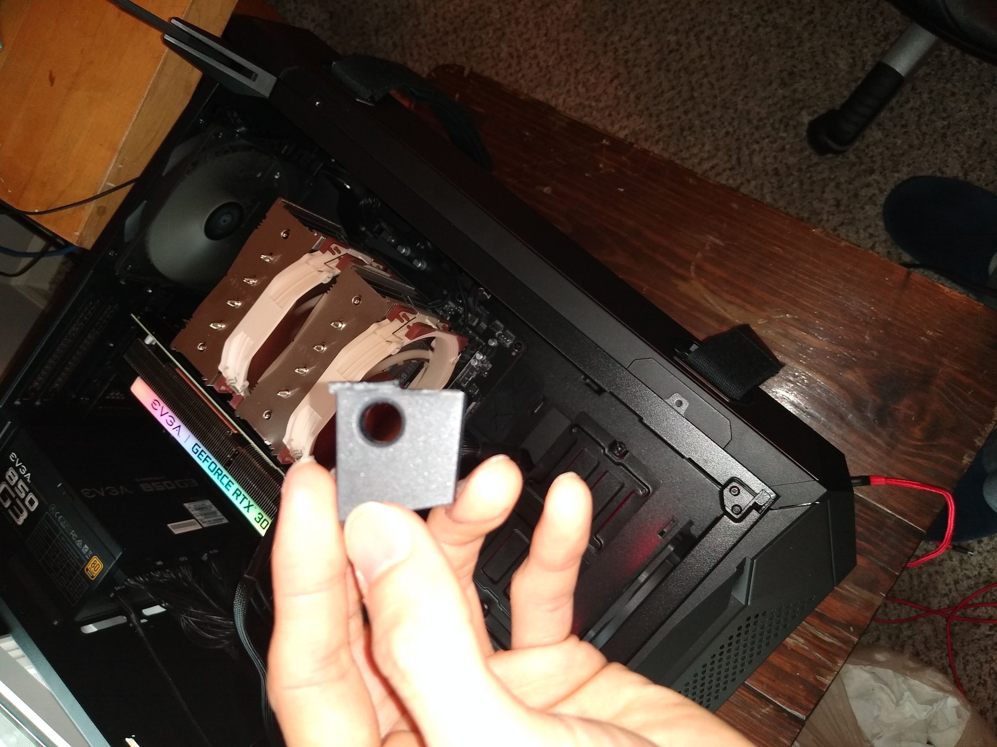

Update. Issue is fixed. I pulled out the mobo and tried to take off that plastic covering.....the main part wouldn't come off but with some screw drivers and lot of tearing and swearing...i basically ripped that plastic piece off and now the 3070 seats properly into the pcie 4.0 x16 slot and is back up and running!!! Woot. FInally. Big design flaw/fail by gigabyte. But is fixed at least

about the motherboard. i didnt know
Pics of the after?

No worries man. Just a weird quirk that sometimes happens...more annoyed that such a big computer part company would make something like that....full knowing that modern GPUs are massive and need as much space as possible. The plastic piece I broke off had NO function whatsoever...there was nothing underneath...as if it is just there to look nice I guess.

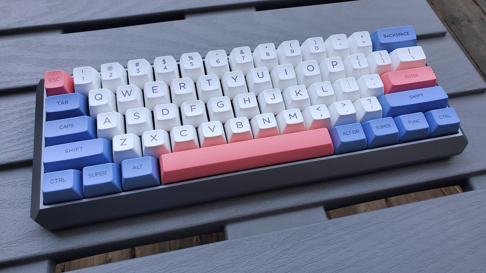

Finished my 4th mechanical keyboard.
5 Degree 60% aluminum case in gunmetal.
SA profile Violet pbt caps
Durock v2 smoked stabilizers
DZ60 hotswap PCB
HaluHalo linear switches (4mm travel/ 63.5g bottom out)
Lots of foam from KBDfans (pcb foam, case foam, stabilizer pads, and spacebar foam to reduce the loud hollow SA profile cap sound)
The case is really nice but being an older case it lacks some of the newer features like a nice brass weight but I love it's geometry.
I bought blockers to use as either HHKB style blockers or window keyless blockers but my PCB would not allow them sadly.
SA profile I don't like too much. This was my first time trying them. They feel nice for typing. But IMO they look odd in such a small case being so tall and sculpted. As well being so tall they have a more hollow sound than I prefer... even with all the silencing foam I added. Love the colors though.
Switches are really nice. Linear switches aren't my first choice but these are buttery smooth without using any lube. Stabilizers really needed some dielectric grease. They scratch like crazy without.

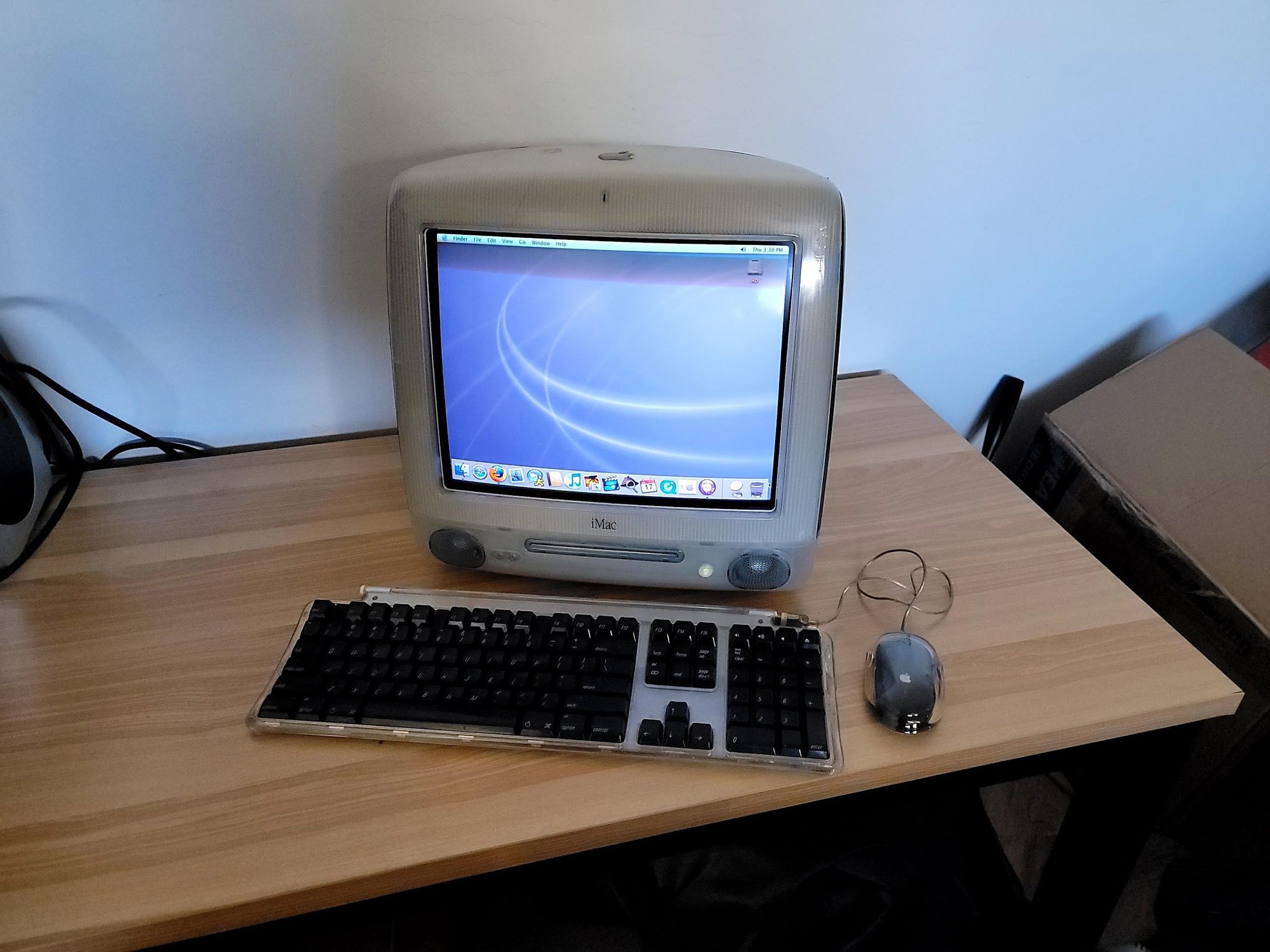

I bought one of these for my garage. Upgraded it to a solid state drive, 1 GB of RAM and OS X Tiger. Works great as a jukebox, perfect for older games and sort of runs Youtube reasonably.

Sir this is a computer building thread
kidding. Pretty cool. I’ve always wanted to pick up the lamp iMac G4.

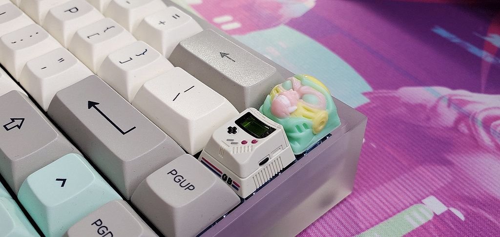

On another note... I got a new artisan cap to remind me of the GameBoy days.
The monkey is new too. I won it in a raffle. Only entered the raffle because the colors matched and my lucky-ass won.
Deskmat is also new. From the group buy Analog Dreams. I have the matching keyset also but those are being made still.
