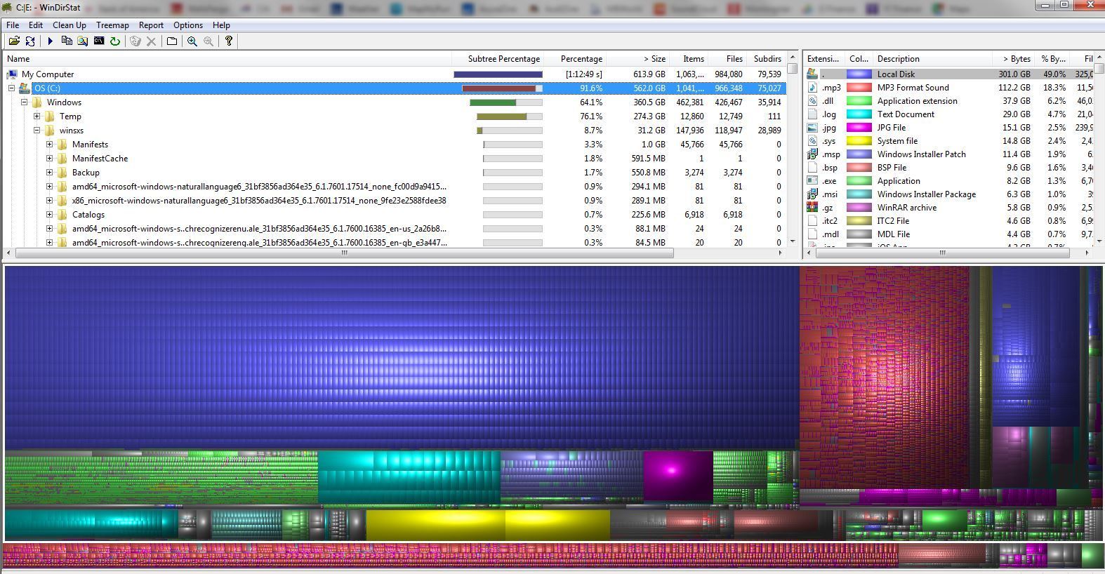

So I ran WinDirStat. 275GB of Temp files????

You should probably get rid of those...
Those two large yellow blocks are probably hyberfil and pagefile. Leave those alone. The large purple single item block, what is that?
Run CCleaner and see how much it clears up.
Having said that, I recommend upgrading only as much as you need. Start with a SSD to replace your HDD and do a fresh install of W7 (you can download the ISO, or your friend can). Find paperwork from when you purchased the original computer and you should find your W7 activation code. It also may be on a sticker on the machine itself. Use that code to activate the fresh install of W7.

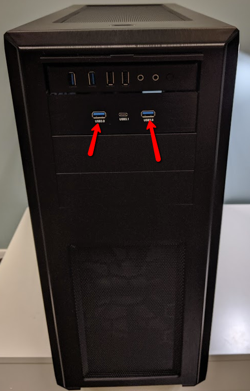

I am a little irritated... When I was assembling my last machine, there were two USB 3 Gen 1 (20 pin, blue plug) header attachments on the motherboard. One sat perpendicular to the motherboard and one sat parallel.
During install of the cable leading to the perpendicular header (the lower one in the picture), the rigidity of the USB header cable coming from the front of the case flexed the motherboard header and now the two USB3 ports associated with this header port are not working. Those two external ports are fairly superfluous, as they are part of an add on panel I purchased to get a USB 3.1 Gen 2 (Type C) port on the front of the case. There are two other USB3 Gen1 ports on the front of the case that are using the top header in the pic and work fine. I will probably just buy a $20 USB pcie card to allow use of the other front ports, but overall I am disappointing that I flexed that connector too much. I wish cable manufacturers made the sheathing less rigid, for sure.
Dead ports with red arrows:

I believe the pink box is pictures. I have a ton of music.. like 40GB and all songs have an album image, so I'm guessing that is what it is.
I ran disk defrag, disk cleanup and CCleaner and available space went from 321GB to 639GB. Jeez.

I dropped a PCI USB3 header into the i9 machine and connected the front plate so those ports now work, although slightly slower than the other set that connects directly to the motherboard. Using the W10 onboard drivers, I get about 40MB/s from the non-broken ports, and 30MB/s from the now repaired PCI bus ports... I will live with it.

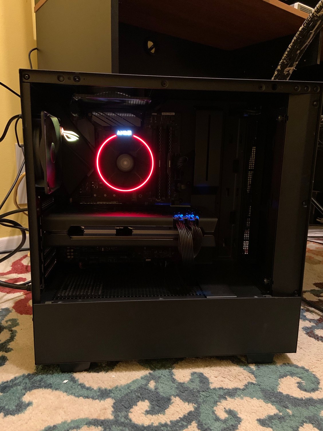

Here's my new build. There's not a lot of RGB in this one. I may kill what little RGB that it has and go for a dark theme.
I ran a Heaven benchmark on the RX5700 to see how it compares to the RX580 in last year's build. The RX5700 does about 90fps more at 1080p than the RX580. (~190 vs ~100)

Looks nice! POST OK?

Yup, jumped up and did its thing on the first shot. I just had to tell the BIOS to get the memory timings from SPD. I don't know why the BIOS doesn't read the SPD by default.

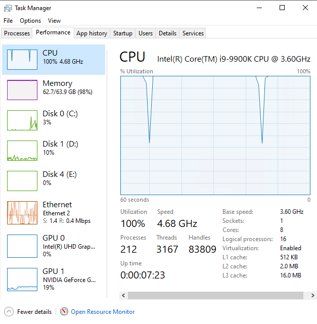

The new i9 heating my office nicely...

That memory usage too

4.68Ghz on air cooling, nice!

Shoulda gone with the 256GB option.
