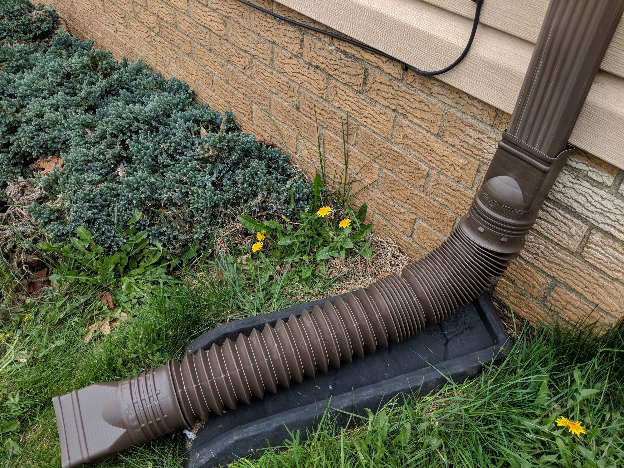

Got the drainage issue on the back corner of the house fixed, hopefully... Had to cut about a foot of the downspout off to get it to fit, but I got the water routed out and away from the house, hopefully this fixes the drainage issue that I was having in the back corner of my garage

I can't tell from the picture did you put any screws in to hold that extension on to the down spout? If not you might want to cause I have had mine forced off in heavy rain when it didn't have screws holding it on.

I didn't, I've had one on the front of my house for about a year and a half and never had any issues, but now you've got me thinking I should...

The house had two of them when I got it. Neither were screwed in but one day after a big storm I found one disconnected and the spout just pointing straight down. They both now have two screws in them just in case for piece of mind.

I'll definitely keep an eye on it since I cut the grass every week and I'm working on de-molding the damn garage wall currently.... I'll probably throw some screws in it just for peace of mind
