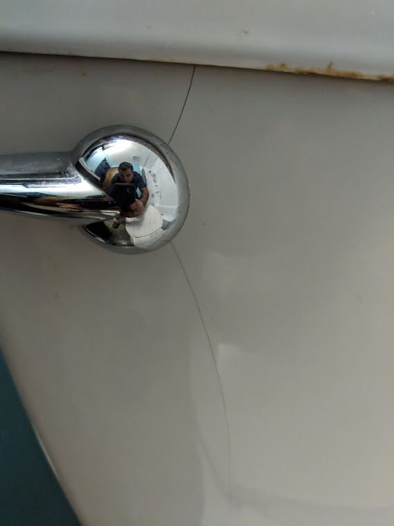

And here's the crack that I found yesterday, no clue how it happened or where it came from

was the nut for the handle on the inside brass? Looks overtightened to me...I cracked the bottom of the tank by overdoing it before and let me tell you that was with a 1/4 ratchet...
since then I only go snug then a little more and call it a day...and keep in mind what material the hardware is as far as the bolts and washers because if there is no give, you will crack it
with a quarter turn.

It came preinstalled

they overtorqued from factory then and when you flushed it did it.
