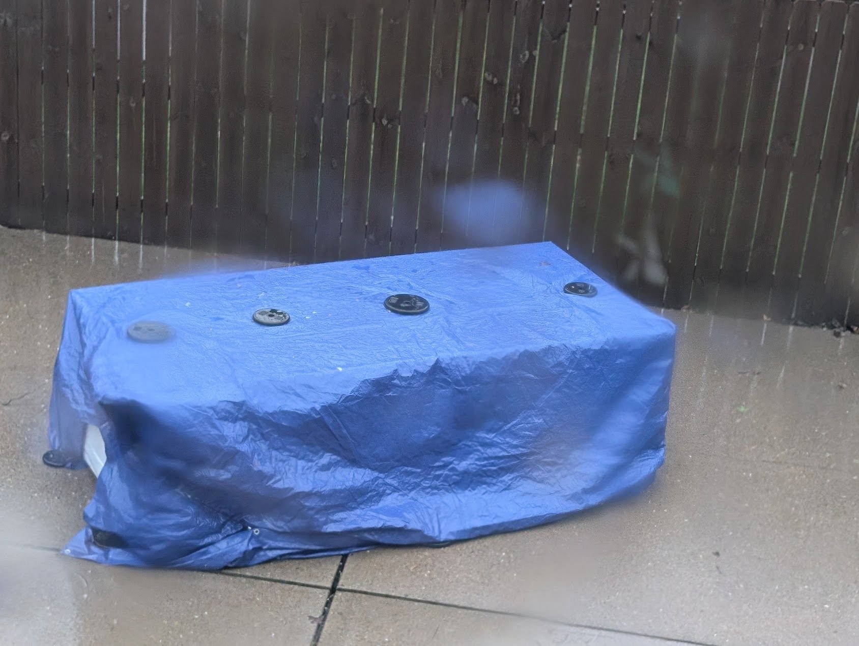

Pretty big update here, when we bought our house it came with this cheap plastic shed. While we were in contract some workers hit the back corner with an excavator and caused damage which we weren't aware of until later. For several years I have been patching this thing back together to keep it from collapsing, but it was on borrowed time. Here's a before, note this was here before the fence was put in.
This is some of the damage I am referring to, the walls kept separating despite my best efforts to glue this thing back together. This was after a big storm.
So I finally bit the bullet and purchased a new 12x10 ft wooden shed. This was delivered back in April on a flat bed
This kit came with everything, including a roof and floor kit.
The day this was delivered we had a severe storm warning, so the wife and I wrapped it in a tarp and tried to protect it....
That night we had a pretty big tornado hit our neighborhood, and ironically the 150 ft Oak tree right behind our shed fell thankfully away from our yard and old shed and destroyed my neighbor's wood shed.
It took out a lot of trees at the bottom of our neighborhood, but the damage near us was pretty limited minus that giant oak....
This is during the tornado/storms, and thankfully our tarp job stayed in place.
