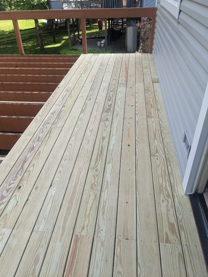

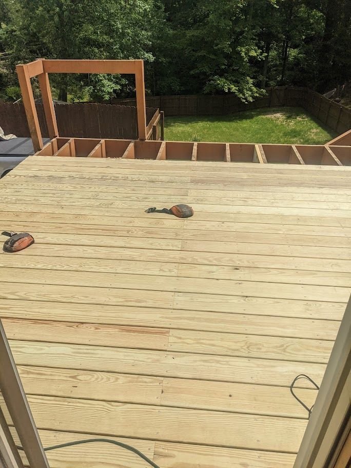

Here's some more updated pictures, they started laying the decking yesterday, this was where they stopped for the day.
About a quarter of the way done yesterday
And this morning more progress, about halfway
Lunchtime, getting close
And the decking is finished! Nice and new, and really sturdy!
The deck feels so much bigger without the benches. It's 22 ft wide by 14 ft deep, which is a pretty good size.
Railings will be tomorrow

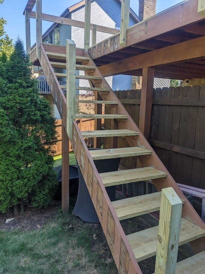

And finally some progress, they took a week off and got back to work on the deck yesterday. Finally getting all the posts and stringers up.
Nice and sturdy!
RIP ugly uncomfortable benches
Yesterday they got all the posts up
Today the got the rest of the stringers up and now they're working on the railing. Nice to see it coming together finally!
I'll have more pictures later, just wanted to post some updates since it's been over a week lol

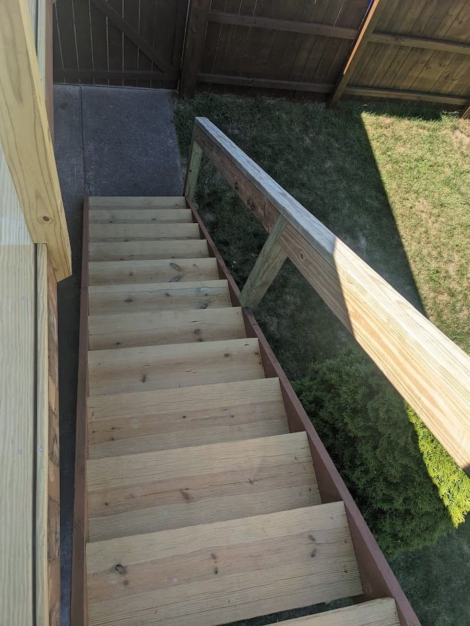

Deck project is complete! They finished all the railing, and they are super sturdy.
All new railings
Yesterday the got 2 sets of balusters up, and the finished look looks SO good
They also were able to work with the siding and replicate what was there when the vinyl siding went up, looks perfect.
And here's the finished product!
All brand new, and looks so nice
It's nice having it all rebuilt and sturdy, knowing that it will last now
And here is where they tied into the siding on the other end
The stairs all finished
And here's a couple pictures from the back. I will need to powerwash the remaining paint off the lower beams before we stain it, but for now it's whatever.
The plan is to stain it the same color/stain as the fence so it all matches in the fall or spring

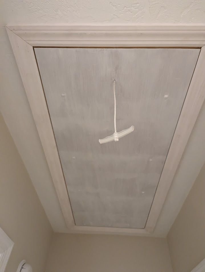

Also our attic only had an access hole and a piece of plywood so we added a fold down ladder. We had to remove the trim and widen the hole by about a foot and brace with some more 2x4's
The legs had to be cut and shortened
All mounted up!
Finished product, we also put new trim molding around the bigger hole,
Still needs primed and painted, but happy with the ladder addition. It also has a nice gasket seal and some insulation foam so it helps keep the heat in the top floor way better than the piece of plywood that we had before

Looks awesome! Word of advice for painting MDF, make sure you brush on some wood sealer like you would for staining pine or whatever before painting it, especially on the outside edges. Makes the coats of paint go down super easy otherwise MDF just soaks it up and it looks like sh1t.

Good info thanks, I did some research after reading your post and found a primer that works well with MDF, hoping it will do the trick

Definitely do the stain sealer before even priming. Trust me, it makes a HUGE difference for MDF.

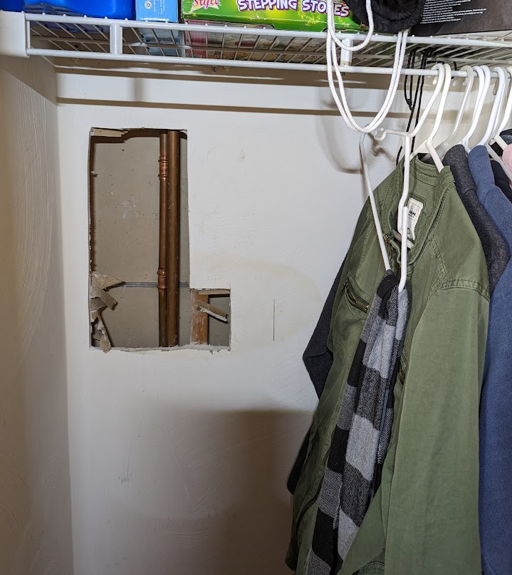

Realized I haven't updated this thread in a while, today is our 3 year anniversary of closing on this house and we've been doing lots of fixes and updates so figured I'd post some updates.
In December and January we had 2 pinhole pipe leaks about 10 feet apart so we had to cut out the wall in the closet and ceiling to replace the bad pipes. (fun times)
This is the ceiling in our entryway....
Both the wall and ceiling had different textures so matching them was a bit of a challenge, but we were able to get pretty close.
And here's the finished product, just needs painted

For the attic ladder, we did seal the MDF with multiple coats of primer (Thanks for the recommendation SamDoe)
And then I painted it with a couple coats of ceiling/trim paint, and it looks great

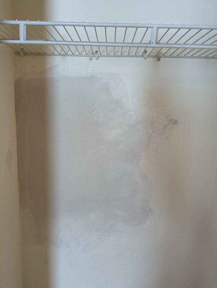

Another update is in May, we ripped the old mirror off the wall in our daughter's hallway bathroom. The mirror chrome was starting to peel all around the frame, and needed to go.
The mirror was glued to the wall with 40+ globs of construction adhesive
Those holes all had to be patched and sanded... I didn't get any pics except this one, and since we removed the light fixture I got to paint in the dark lol. This was the first coat
First coat completed
Second coat completed
All dried up
