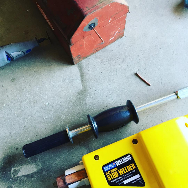

Stud welder, check.
Slide hammer, check.
Body filler, check.
Sanding block & copious amounts of sandpaper (200-2000 grit), check.
These 3mm studs can really take a punch, I'm feeling confident that I won't need to use much body filler fixing my rocker panel this weekend
Paint will be addressed next weekend.
Wish me luck
