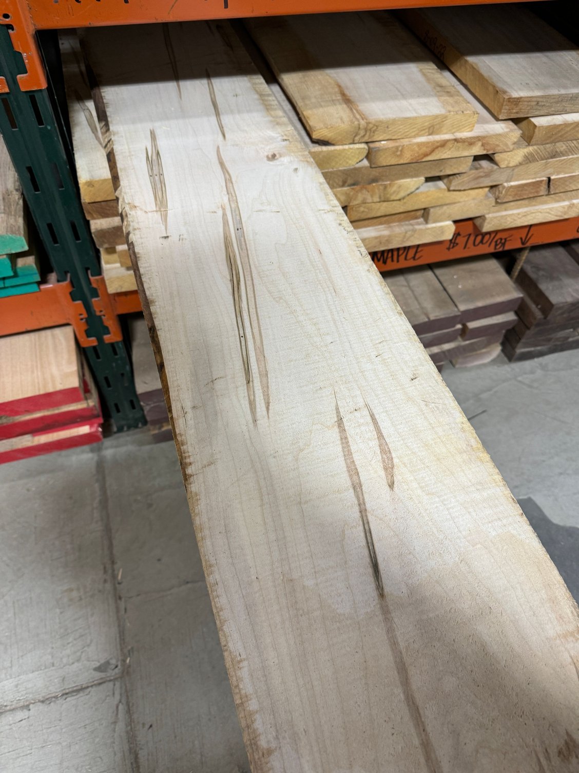

While this project is not nearly as cool or large as the new garage build, I've finally started on my first actual furniture project in my new shop. I made my daughter's crib for her 3.5 years ago and she has now started to outgrow it and has requested that dad make a big girl bed for her...so that's what we're going to do. Plan is to make a full size bed frame with a relatively simple design along with a matching nightstand (to be made in the future). I got a set of plans from foureyes furniture because I suck at the design side of things and have gotten to work.
First step was to go get lumber to make these. Buying hit/miss planed full length lumber is MUCH cheaper than buying finished/processed lumber but requires the tools and time to process it at home. Thankfully I have the tools but need to find the time...I'm cheap though so we continue. I really wanted to do this cool ambrosia maple for the head/foot board parts but the wife shut that one down.
The initial plan was to do white oak (on the right) for the whole bed but it's expensive, almost 2x the cost of the plain hard maple (on the left) so that's what we went with. Total cost of lumber was about $410 so far for the bed alone.
Got all the pieces home (beyond thankful for having a truck now) and got to work milling it all close to final dimensions. All of the parts are left a little long and a little thicker so I can fine tune it closer to assembly time. The widths don't matter because all of these will get glued up into panels. In this pic you can see the hit/miss planed rough boards on the left vs the processed ones on the right (that I've written/drawn on). Some time with the track saw to cut to width, then the jointer for a clean face/edge, and the planer to clean the other face gets us most of the way. Then run it through the table saw to clean up the other edge and we're ready for panel glue up.
This thing is crazy expensive but is basically a cheat code for woodworking. If you have the means, it's worth every penny. Cutting in dominos for the panel glue up. These will hold all the boards flat to each other and eliminate much of any bend/bow between boards.

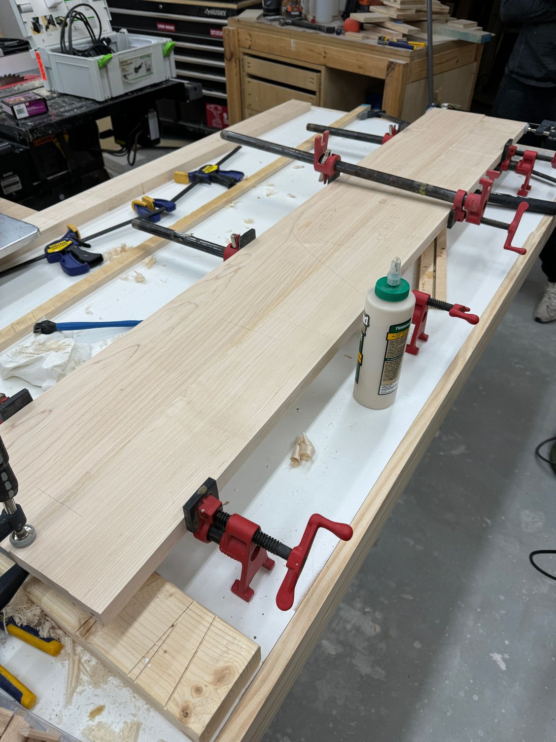

And that's where I left off last night. Turns out I ran out of glue and need to get more today lol. Thankfully HD is pretty close to the office so I'll swing through over lunch. Want to get the panels glued up tonight then cut to width and planed tomorrow night.
Just going through this process has highlighted a few flaws with the layout of my shop that I need to fix in order to be more functional. Something I plan on doing after this project is over...that and organizing everything after the move.
Stick around for the rest of this one!

First few panels for the headboard and footboard glued up. Next step will be to cut these to width and then a quick pass through the planer to even everything out. I have one more panel to glue up before I can start on the legs. Unfortunately don't have enough clamps to do more than one at a time...

After a week of funerals, travel, and being sick, I'm now back into working on this bed. Got the legs cut and shaped. Used a table saw sled to cut the joint faces and a router to template route the final shaping. Also realized I need a better band saw but that's a problem for the future.
Next step will be to do a quick pass on the jointer for the faces to remove the burning and any saw marks before cutting in dominos to get the head and foot boards completed. Hope to get the panels ready for dry fit and sanding this week and weekend...then there will be hours and hours of sanding to do.
Also, routers are messy. Unfortunately there's no good way to have dust collection on these things.
