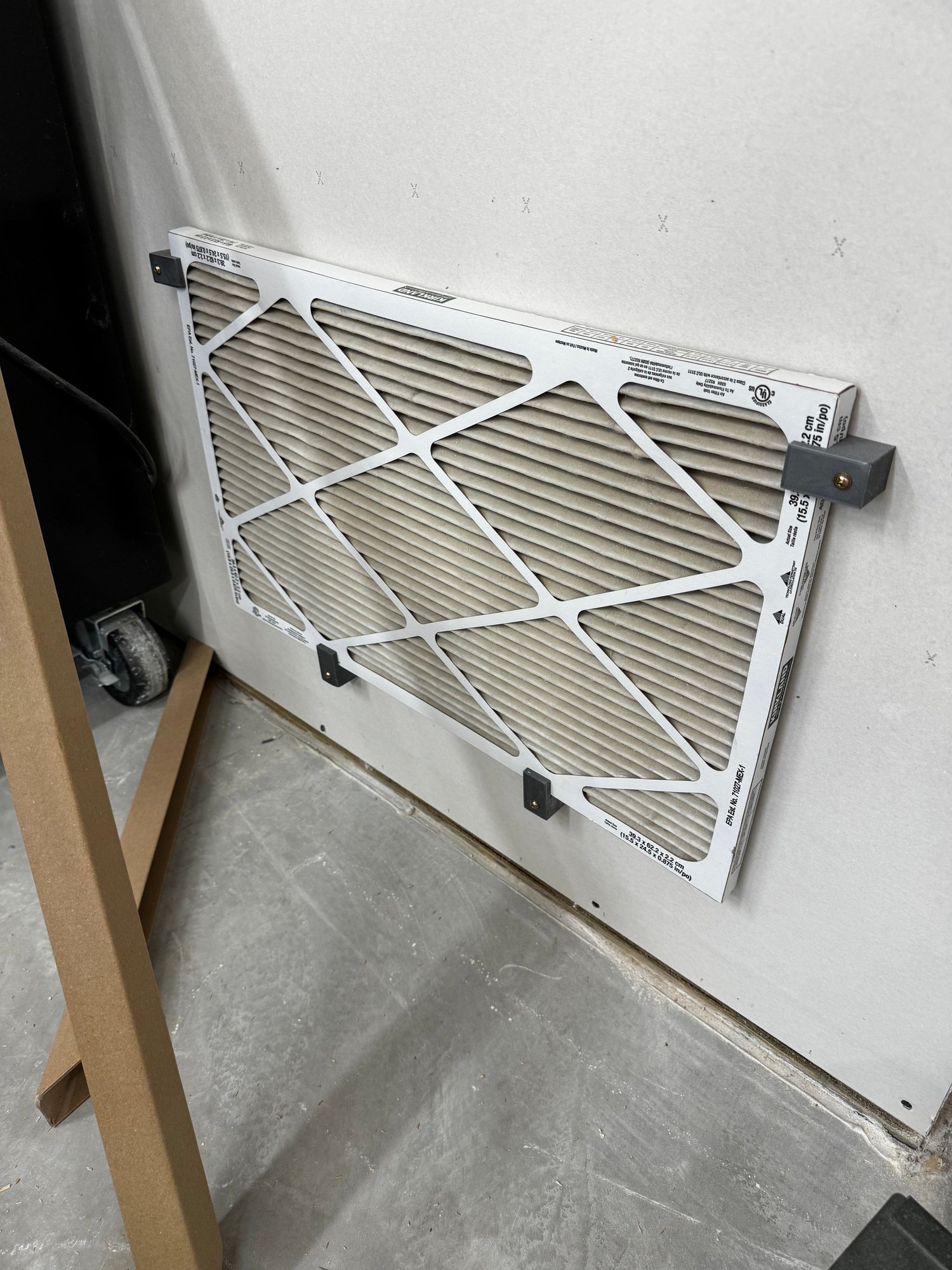

Because the shop is built out to potentially become a bedroom in the future, there is a return air duct in the room. Since I don't want to get sawdust and shit sucked up into my HVAC, I put the old furnace filter that I remove onto the wall in front of the duct to catch all that before it goes in. I was thinking about trying to make some elaborate system to hold the filter to the wall but thought I'd go simple. 3D printer to the rescue with some easy mounting brackets.

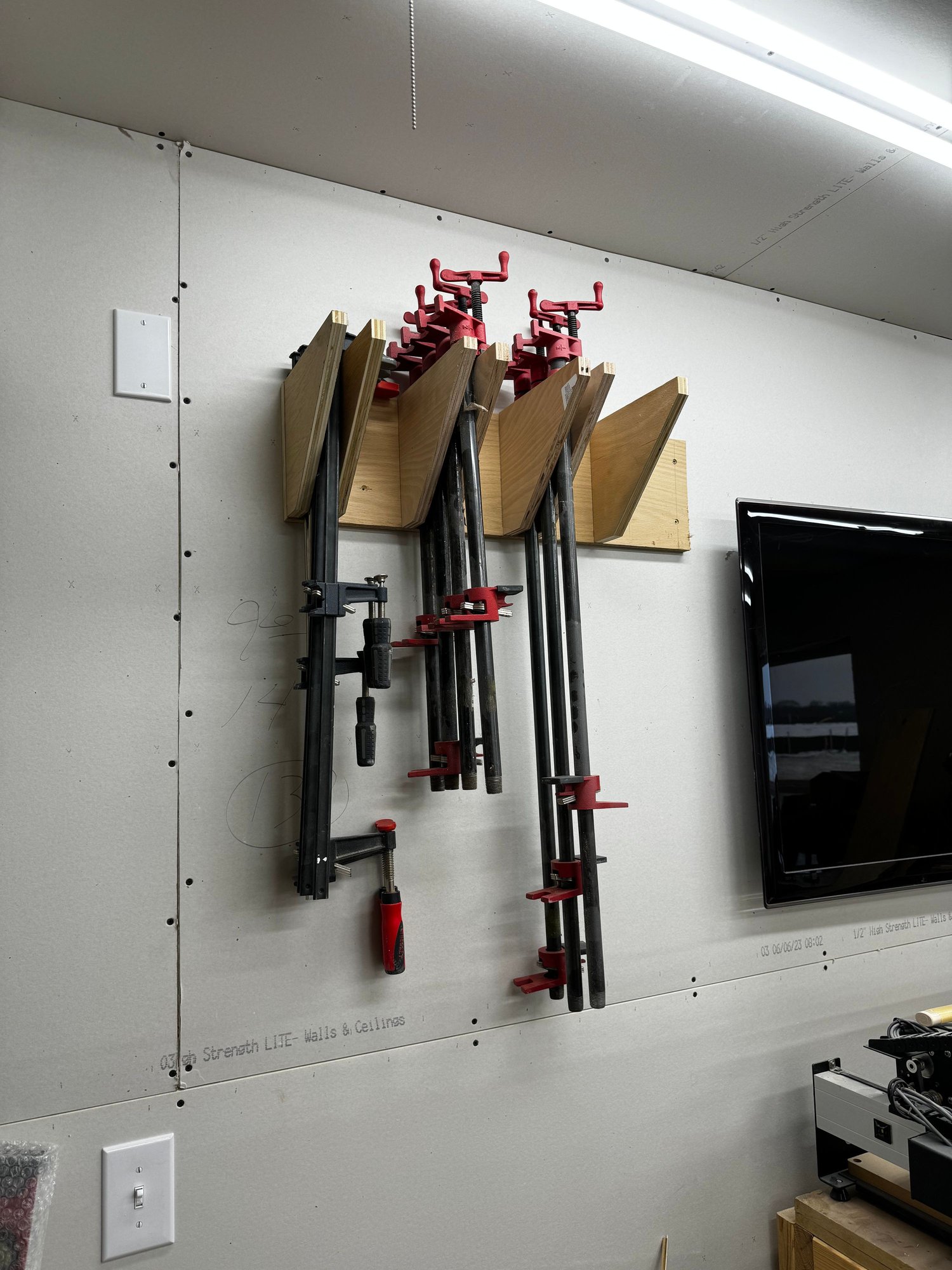

Needed a place to hang all my clamps so they get off the floor and stay out of the way. I apparently took this pic before it was done, there's one half of the hanger on the right missing that has since been installed, but it holds all my current clamps. It's easy to build another one of these in the future out of some simple scrap plywood as my clamp collection inevitably expands.

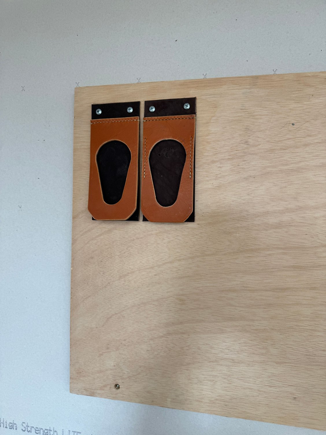

Quick update, first project(s) done. First up is a hand tool wall mount thing. Mounted a nice piece of oak veneered plywood on the wall to put all my nicer hand tools up. Decided to try and find a way to blend my leatherworking habit hobby into the shop the best I could so I made these leather plane hangers that hold the big planes on the wall. Now I need more hand planes...
I then needed a place to store my block plane that's easy to access so I put it on the same wall. Wet molded a piece of natural veg tan to fit the block plane and mounted it on a backer piece before putting it up.
Where we stand now, looks kind of bare, need to fix that. I do have a shoulder plane that I need to make a spot for still but that's all that's left. Might put chisels up here too but kind of want to keep those in a drawer near the workbench.

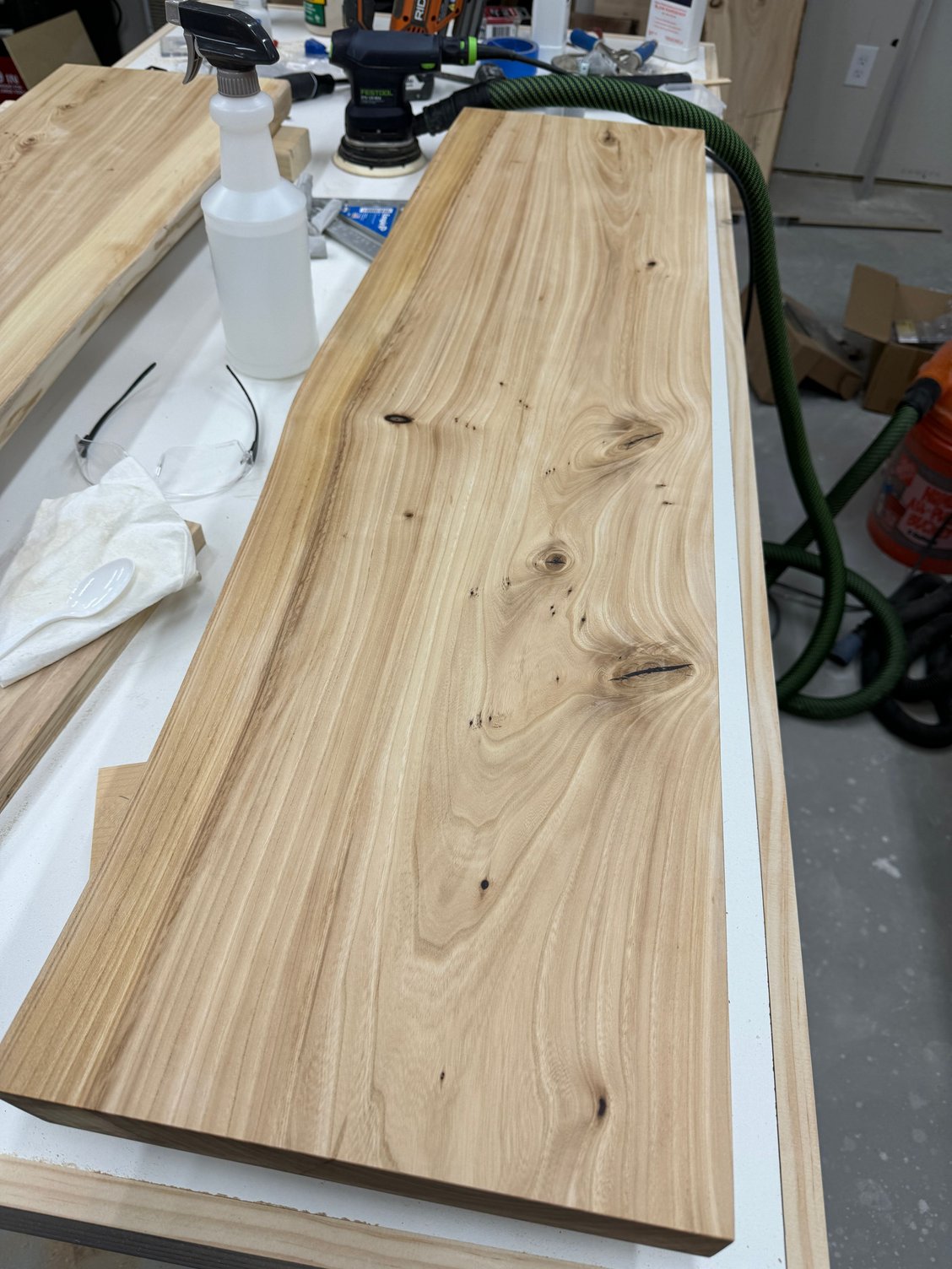

First actual thing done. These two elm slabs will become shelves for my bar. Bought these rough so flattened them, cut one edge clean (thank you track saw) and squared off/trimmed the checking off either end (thank you again track saw). Then had to go through and clean out all the bark and knot holes before filling with tinted epoxy...and then back to flattening again before sanding and hardwax oil finishing. These are now done and will go up on the wall either tonight or tomorrow!

Really like the grain in that elm!

Elm can be really pretty, especially with the right finish on it. I probably wouldn't use it again for anything other than a shelf because it's pretty stringy and hard to get a perfect finish on. I would much rather use ash or maple for actual furniture. Elm is cheap though and no one touches a shelf so a perfect finish isn't critical.

Super cool pieces of elm. Those are going to look great. What ting color are you using with the epoxy?

I'm using black diamond pigments in brown with total boat epoxy and slow hardener.
I have used Rubio and probably won't do it again. It's expensive and I don't think it works that well. The advantage of it is that it comes in a billion colors and tints so if that's what you're looking for then it's great, if you just want clear then there are better options. It's also not nearly good enough with one coat so you're going to be doing two anyway.
I personally use Osmo PolyX oil for nearly everything I do. It's a good bit cheaper and is a one part coating rather than a two part. There are a couple nuances in which ones to use, can talk more about it if you want, but they are all (except for one) just clear with different sheens. The one I used for this project is the one that's not clear, it has a very minor white tint to it to mitigate the yellowing you get when you put oil on light wood. I use clear for other woods though. You still have to do two coats to get good protection and can do more if you want more sheen.

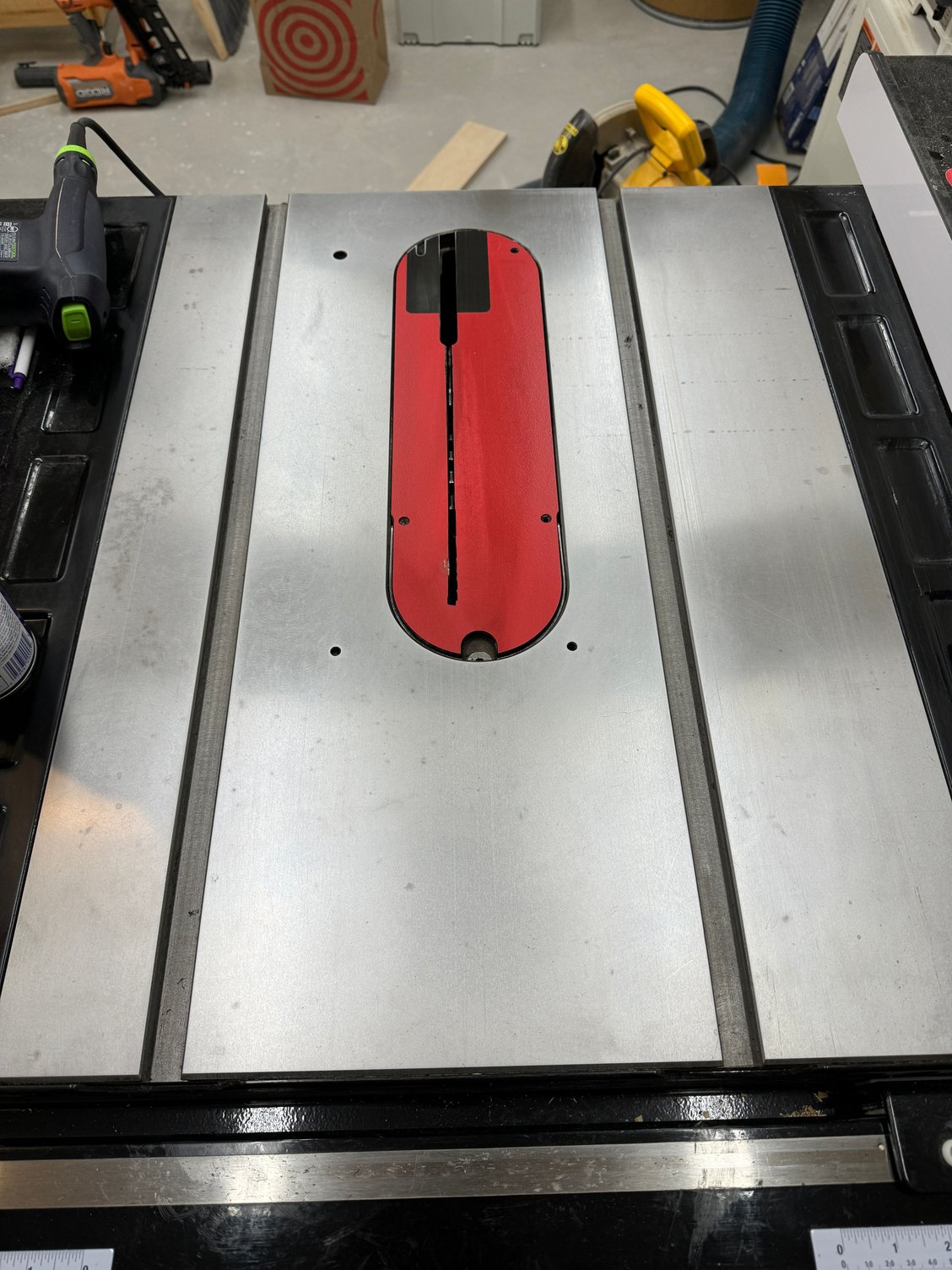

After living in my garage outside exposed to the cold/humidity/etc my table saw top was looking pretty sad so now that it's an indoor saw I took a few mins to get the rust off and get whatever oxidation out of there. Not going to be perfect by any means but definitely way better than before. Will have to do this for my jointer and band saw next.
Before:
After:

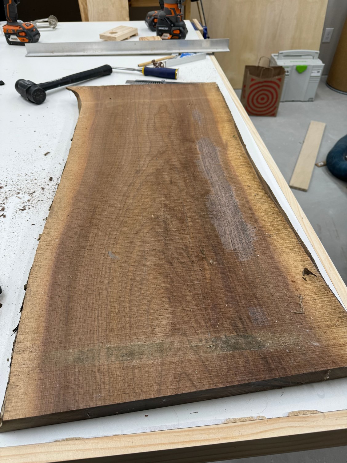

And the next patient to go under the knife. You can see a small section that I planed quick to take a peak at what was hiding underneath. This is going to turn into a shelf unit to go upstairs in our kitchen. TBD on whether I'll keep the live edge or not, leaning towards not.

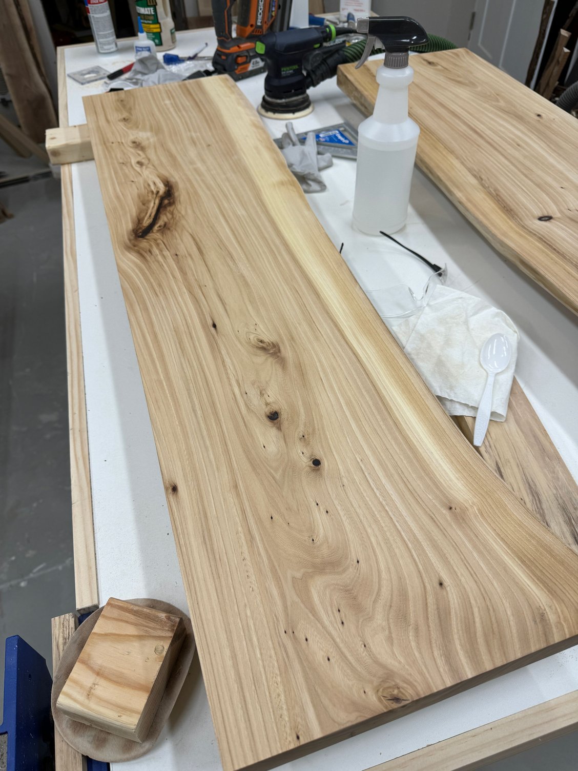

Old Feb 13, 2024 | 10:23 AM
  #1157
Posts: 48,314
Originally Posted by SamDoe1
That's a sexy piece of wood
