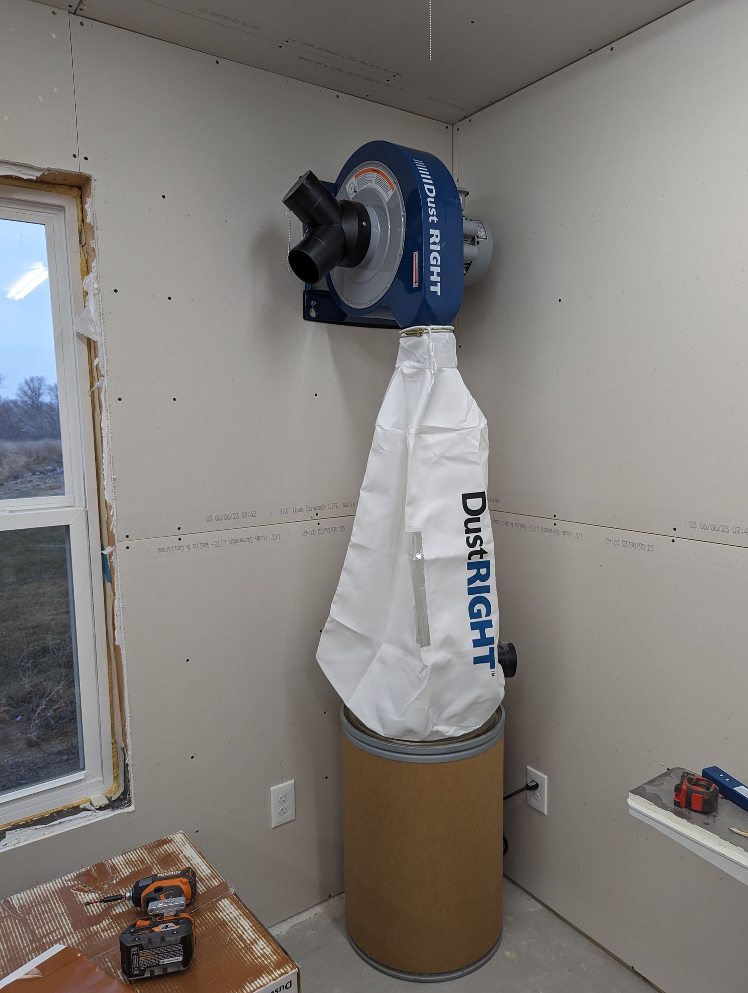

Big boi dust collector installed. Turns out the hose I had for this wasn't long enough for the new install so I didn't really get to run the damn thing.
Next up is work bench construction as soon as I can get this dust collector going and table saw operational. I guess it is right now but would make a huge mess without the vac connected.

Yup, 20ft of pipe is a lot. Remember that's just the main run, you'll have more losses from the main trunk to splits, tools, through connections, blast gates, hose size differences, etc.
I also looked into doing the same as you're suggesting with one big ass unit but it was just not worth the cost of doing it that way vs 2-3 localized units.
