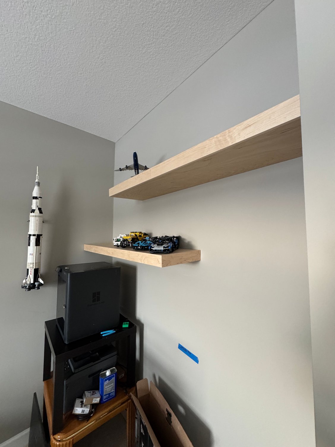

Quick update on office stuff. Still haven't installed those cabinets yet, they are just sitting in my storage area and probably will continue to do so for the time being lol. Instead I got the floating shelves mounted up and the speaker wires run through the wall, you can't see them in the pics but trust me lol. The plan is to have the paper printer in the cabinet and the 3D printer sitting on the counter top.
Peep that grain wrappage. Also I'm just now seeing whatever flaw is in the finish from this picture...I will have to fix that ASAP because it cannot be unseen.

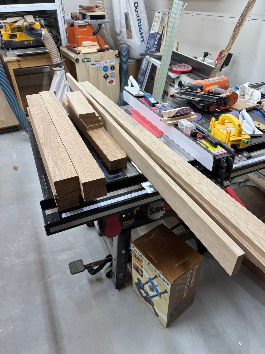

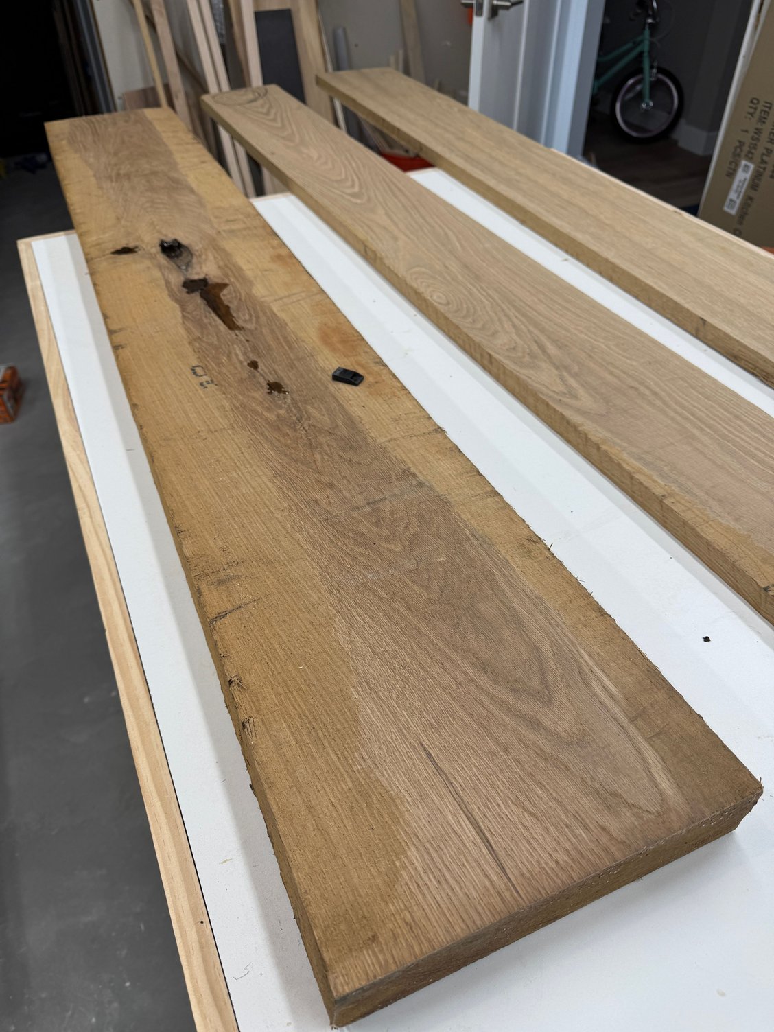

New project kickoff. Hoping to wrap this up over my holiday break but we all know how that goes lol. This one is going to be a Parsons style sofa table made out of white oak. Just made the lumber run this afternoon, again thankful for truck life lol, and got a bit of prep work done ahead of tomorrow.

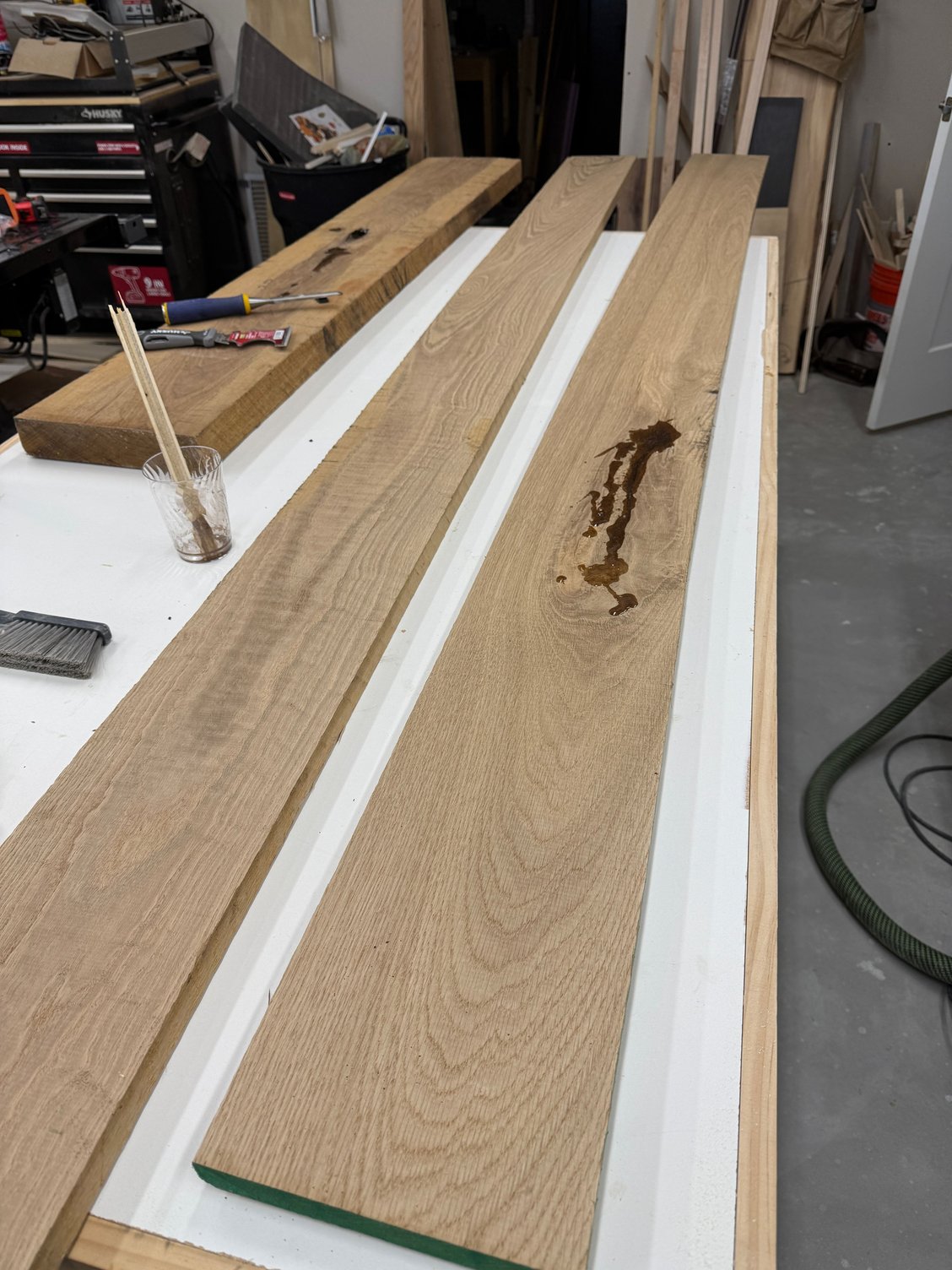

This slab will become the one piece top. I'm going to rip off the live edges and have it be a square. I honestly think the live edge fad is over haha.
These thinner pieces will become the long and short stretchers while the thicker pieces will become the legs. I started the epoxy fill process to fill in some of the defects in the boards. The epoxy will be on the back side of the piece and not visible but I wanted to make sure it all got stabilized properly.

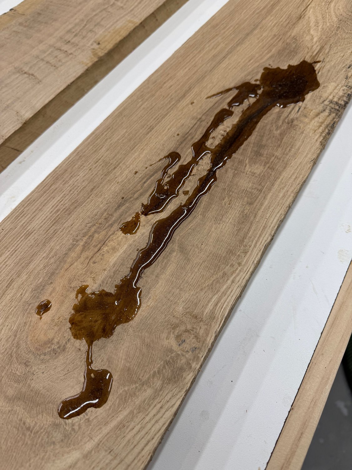

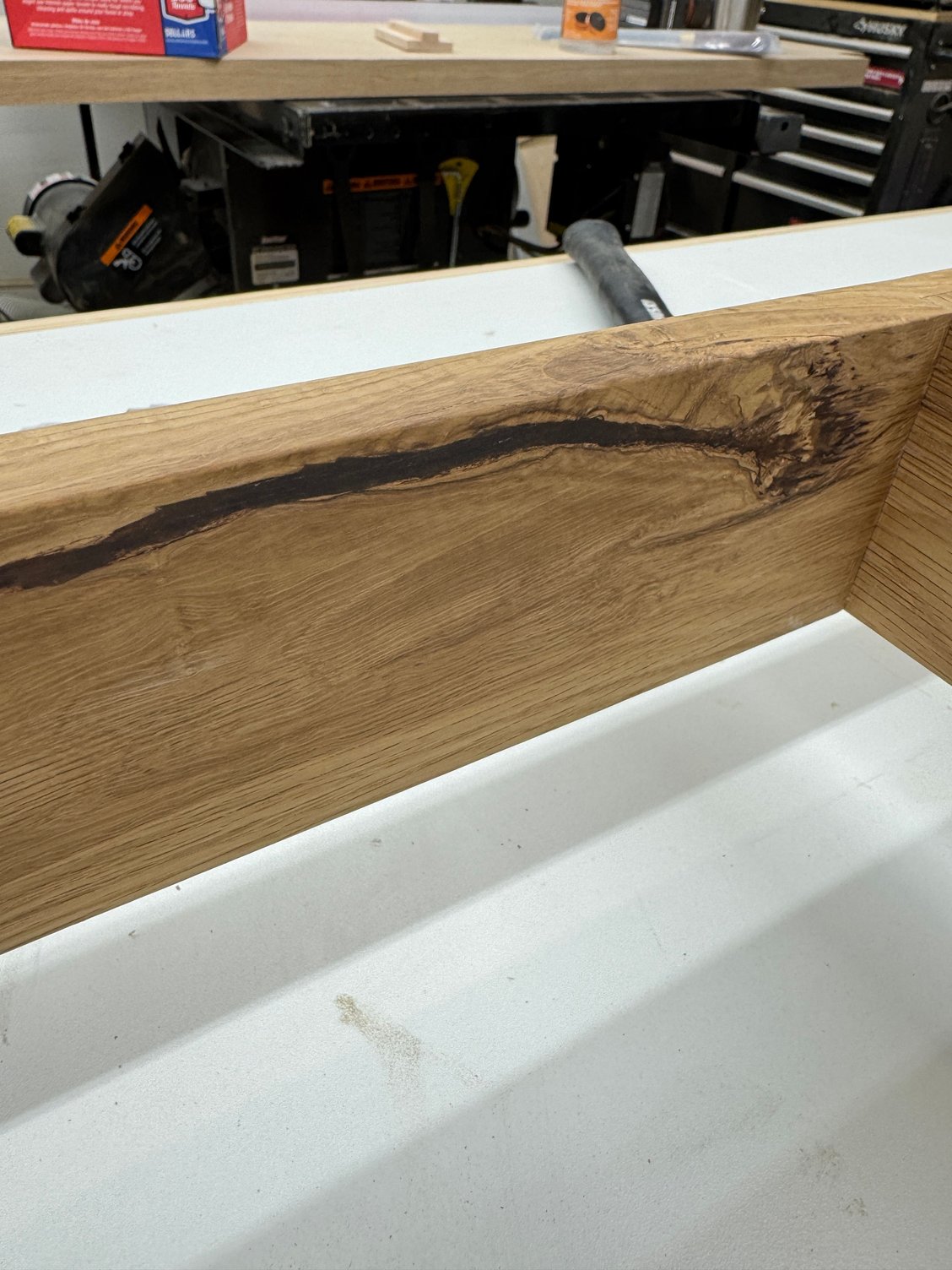

Close up of epoxy fill. I tinted the epoxy with some brown pigment to give it some color.
Did the same with the leg boards. The big knots will get hidden in the glue up so not super concerned with those but, again, wanted to stabilize the board and make sure nothing weird was going to happen during milling.
Plan for tomorrow is to get the pieces rough cut and milled along with getting the leg blanks glued up. If there's time, I'll also final cut and sand the stretcher pieces. I'm still noodling about a small change to the leg design though so won't progress to finishing that until I get that figured out.

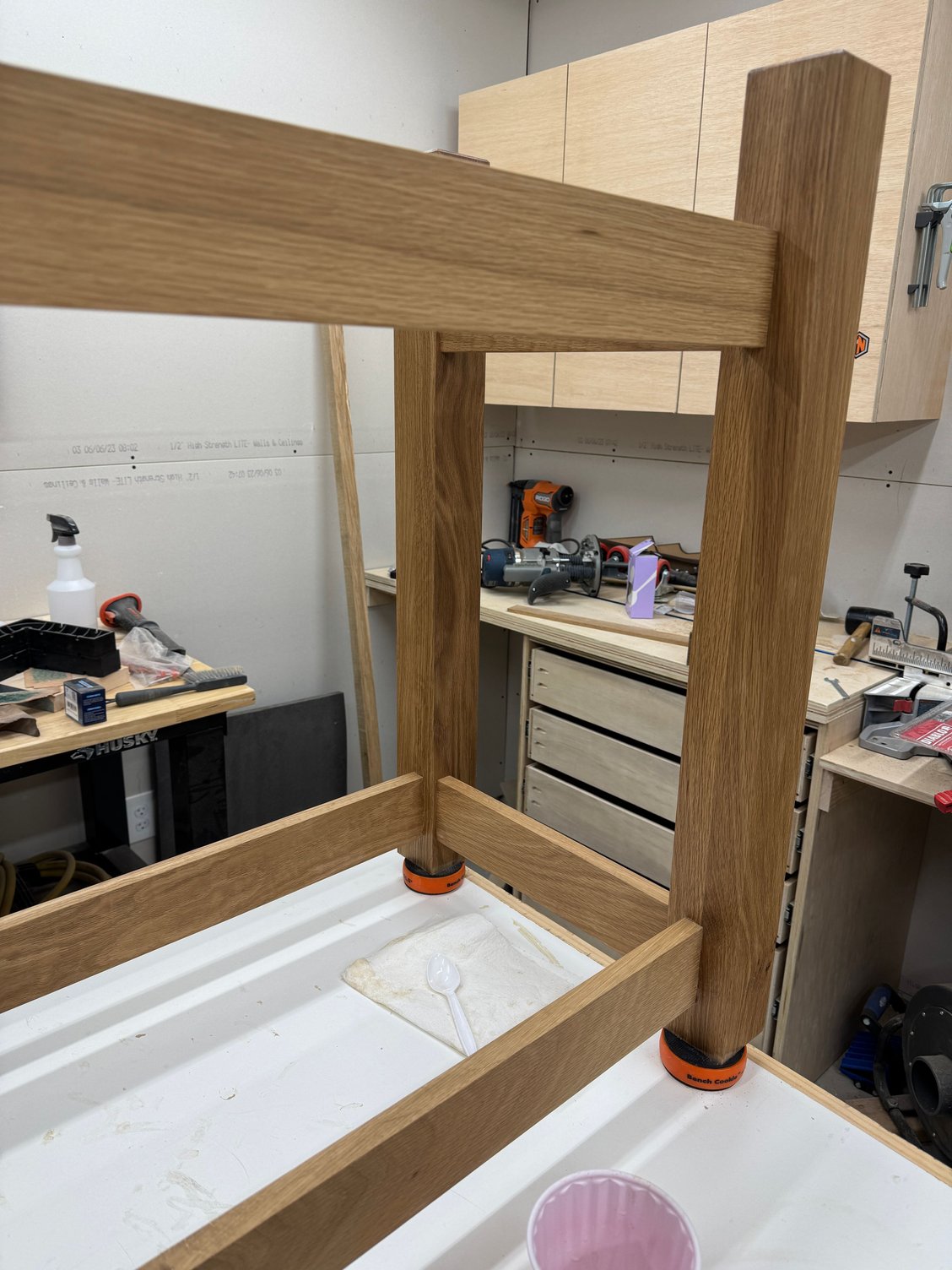

Lol, thankfully not. I had the piece propped up on some pucks so I saw that it was dripping. Got it all wiped up quick and slid in a drop cloth before anything dried so all good.

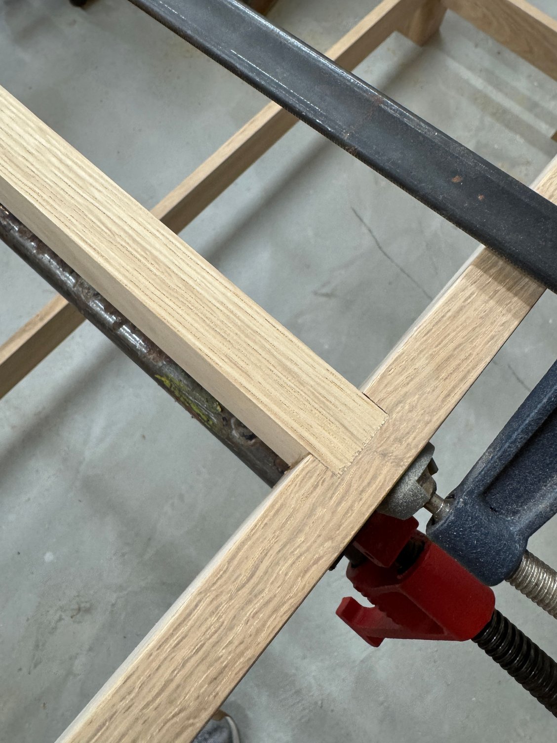

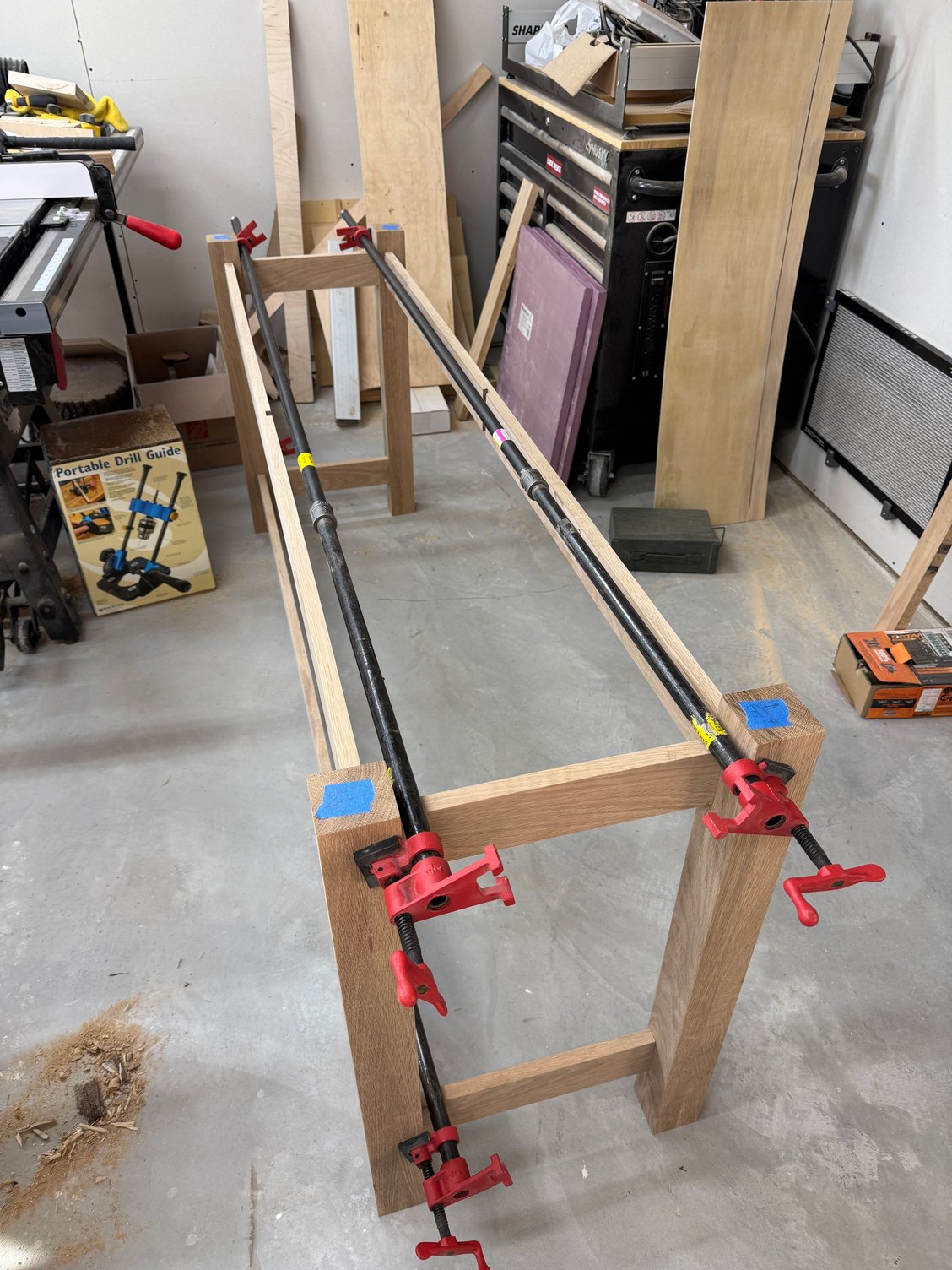

Base is done and glued up. Here's the final assembly in clamps. The middle stretcher isn't there in this pic but added shortly after.

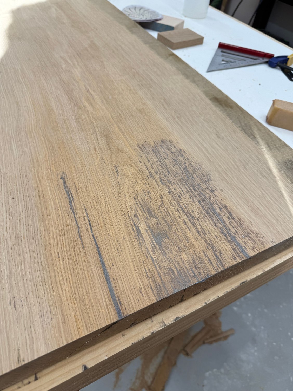

This is the bottom of the slab after the second round of epoxy fill and sanded smooth. This is still 80 grit so pretty rough, it'll clean up more as I go higher in grit. There are a few micro pits to fill in with some CA glue but that will happen later on.
And here's the middle stretcher installed. That's a tight fit (that's what she said).

I love those pipe clamps. Still, the only large size clamps I currently own. Great idea with the couplers. Never thought of that to make them even larger and not have to store the pipe sections.

Yup, love pipe clamps lol. I keep these at 2ft lengths most of the time and then just have a few 6ft extensions sitting in storage when I need them. I don't have frequent need for 8ft clamps so no reason to keep them that way all the time. Only thing I hate about pipe clamps are the black marks they always leave on wood when using them.

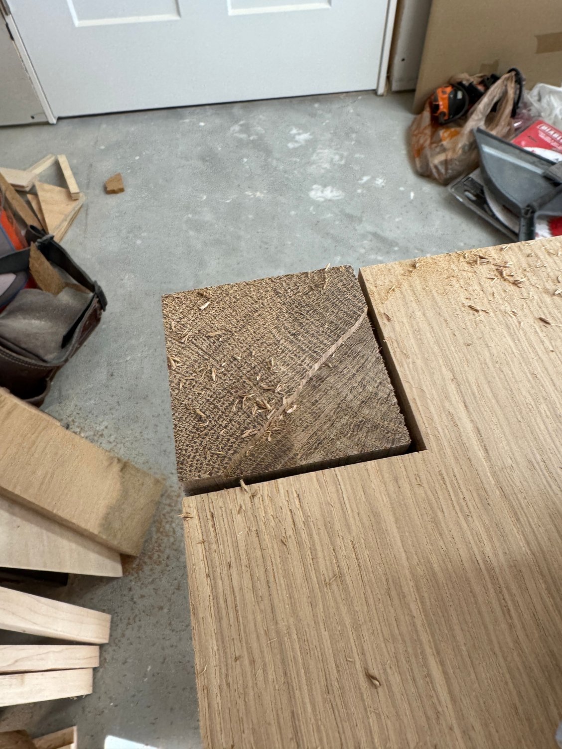

Quick progress update, we're nearing the end! First step was to cut the notches into the top for accepting the legs. I definitely forgot to take pics of this, furthering the fact that I'd be a terrible influencer, but you can see the notches in the second pic below. I put the top upside down on the bench and then the base upside down on top to position it where I wanted. Then I used a 1/8" shim to mark some clearance lines around all the legs in the exact spot they needed to go. These shims are cheap and invaluable, I'll grab a pic of these tonight too as you should all grab a set from Bezos. I then rough cut all the notches using a jig saw and then stuck down some straight pieces of plywood with double sided tape aligning with my marks to use as a template before finish cutting them with a router and template bit. Turned out awesome, wish I would have grabbed pics.

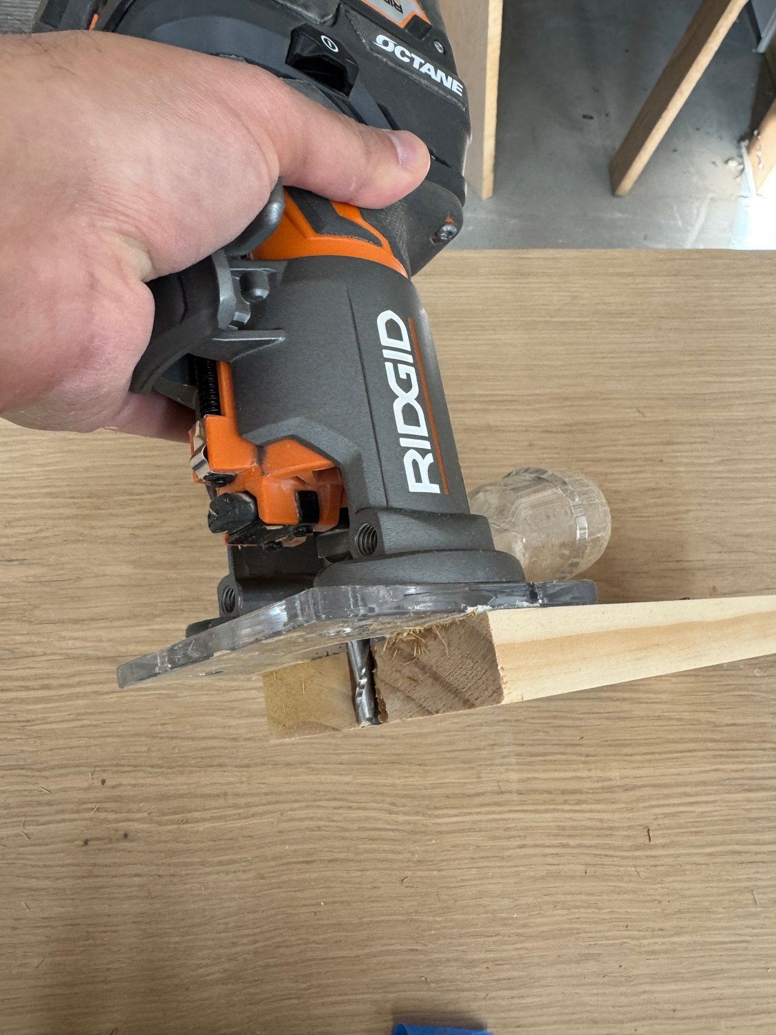

Next step was to get the legs to sit flush with the top. I intentionally left these long so I could line it up perfectly after fitting the top in place. I made a quick router jig to do this with a piece of scrap pine with a hole drilled in it, cut the hole in half for where the bit would go through and then stuck my router to it with some double sided tape. This is what the jig looked like.
I then set the jig on the table top and plunged the bit to be ever so slightly above the surface of the table top and then pushed it into the part of the leg that was extending upwards for the bit to clear it flush with the table top. This worked shockingly well...though it made a YUUUUGE mess. Did this on all 4 corners, here's a pic in progress to see what I mean.

This is what the epoxy fill looks like with the sanding complete and finish applied.

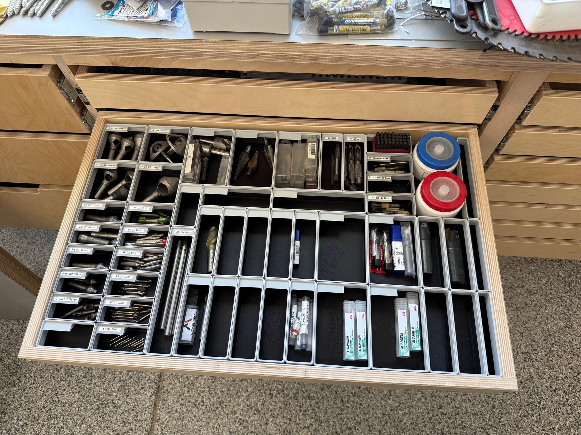

And lastly, completely unrelated, but I took a few mins to organize my media center. 3D printed a bunch of brackets (which are $$$$$$ to buy) to attach zip ties too and also a wall mount for my router to sit in. I love having a printer around, it's so fucking useful all the time. I know this is no @CCColtsicehockey work but it'll do for me.

Do it, they are beyond useful. Especially so if you get one of the fast ones. Don't buy a slow one, you'll never use it.

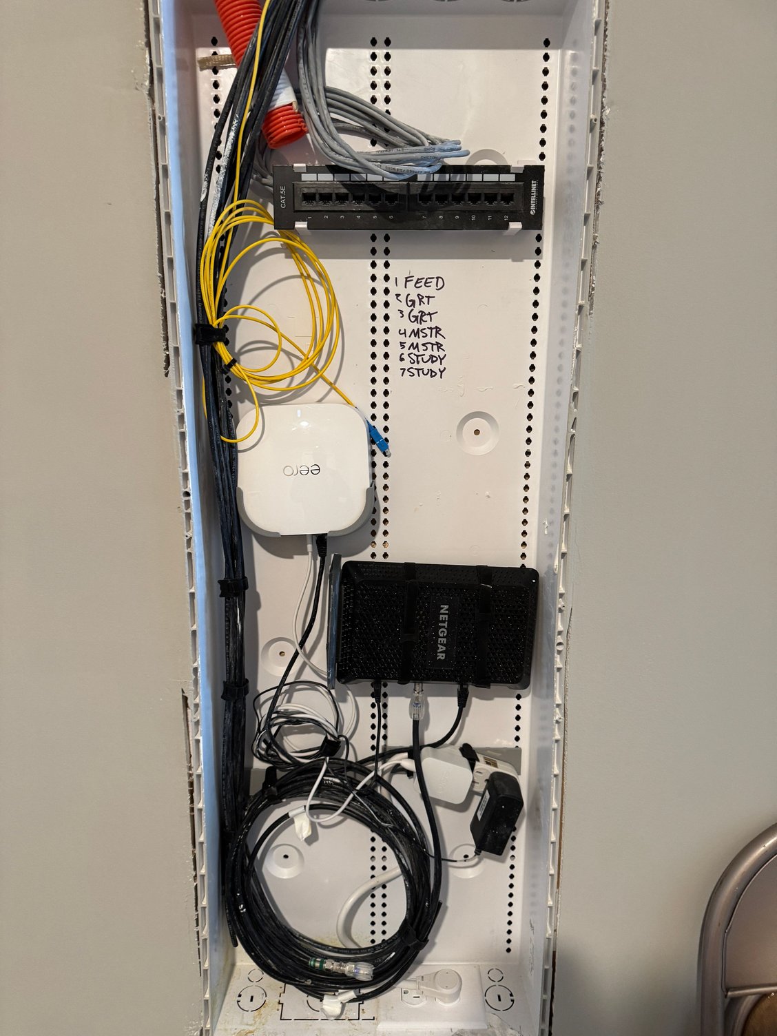

Did you used to have fiber and then switched to cable? We need to get you over to some Ubiquiti equipment

This is at the top of my list of next purchases with the primary initial focus on tool organization.
No, our house is wired for fiber from the outside to this center but we don't actually have it hooked up as we still use cable. I tried to get on the fiber network but the provider was really shitty to work with, even more so than Xfinity that we have now, so I just let it go. We get plenty of speed out of cable so we're leaving it.
I don't even know what Ubiquiti is... This sort of thing is so far beyond my expertise, I just learn from you guys.
I use it a lot for that but also for general household stuff. For example, printed a bunch of soap dishes for our bathrooms and a salt dish for margs.

Oh ok so the builder was just smart and prewired even for fiber. Nice. Worse that Xfinity is really hard to imagine having grown up in the awful service that was Comast before Xfinity. Download speeds are fine with cable but once you experience accessing any cameras you have live with fiber you can't go back. The upload speeds are really what fiber is all about.
We will have to teach you about Ubiquiti and why you need to spend a couple hundred to a thousand on your home network
