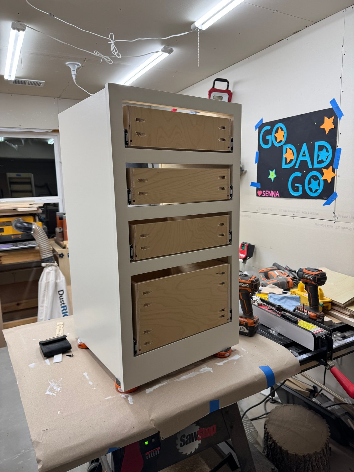

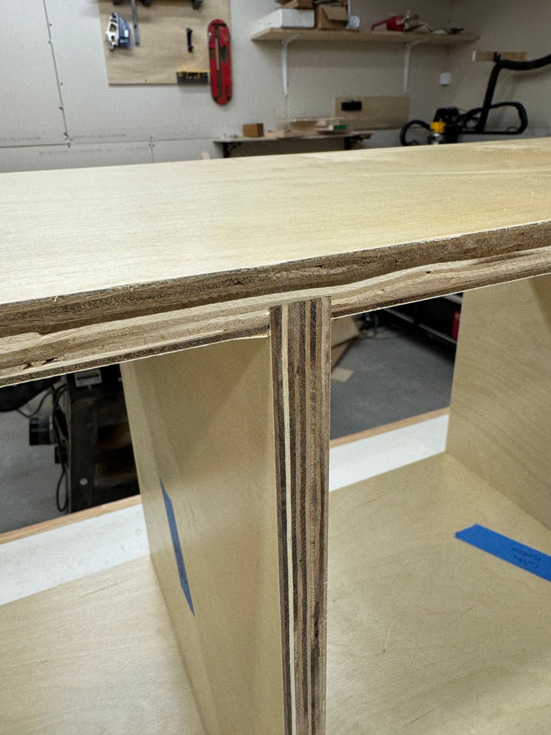

Quick update on the mud room built in project, got almost all the cabinet carcasses built and assembled and ready for face frame build.
First up is the drawer cabinet, this is the cabinet carcass that the face frame will mount to, just need the back panel and it's done. I don't plan on doing a toe kick on these because it's a mudroom build so the bottom face frame piece will go all the way to the floor. After face frame, I'll build the drawers and drawer fronts for these and be ready for paint. Also, I've learned through many fuck ups learning opportunities to label all your shit as you cut it so you don't run into problems later, hence all the blue tape on these pieces.
This is the tall cabinet carcass complete, also needs the back panel and I'll cut them both out at the same time. The inside will have shelves...so I should also get the shelf pin holes in there lol. There will be a big top part with a door and the bottom will have one bigger drawer.
For the cubby part that goes over the bench, I was unable to use pocket hole screws as everything is visible so I had to go old school with dado joints and glue. This is also done (no back panel needed) and ready for face frame. First pic is the layout marks on one piece and completed dados cut into the other. I used a jig I made to cut the dados exactly to the size of the piece of plywood that goes into it and cut them with a router and template bit.
Dry fit assembly.
Tighter than your mom.
Next step will be to buy some poplar lumber for face frames which I plan on doing Friday this week and start processing all of that. I have some maple on hand that I'll use for the rails/stiles of the doors and drawer fronts as it's a bit heavier and harder wearing. Face frames generally go pretty fast so I'm hoping to get this whole thing to paint before it starts to get cold.
I'm in the hard part of marathon training now so time is tight lol.

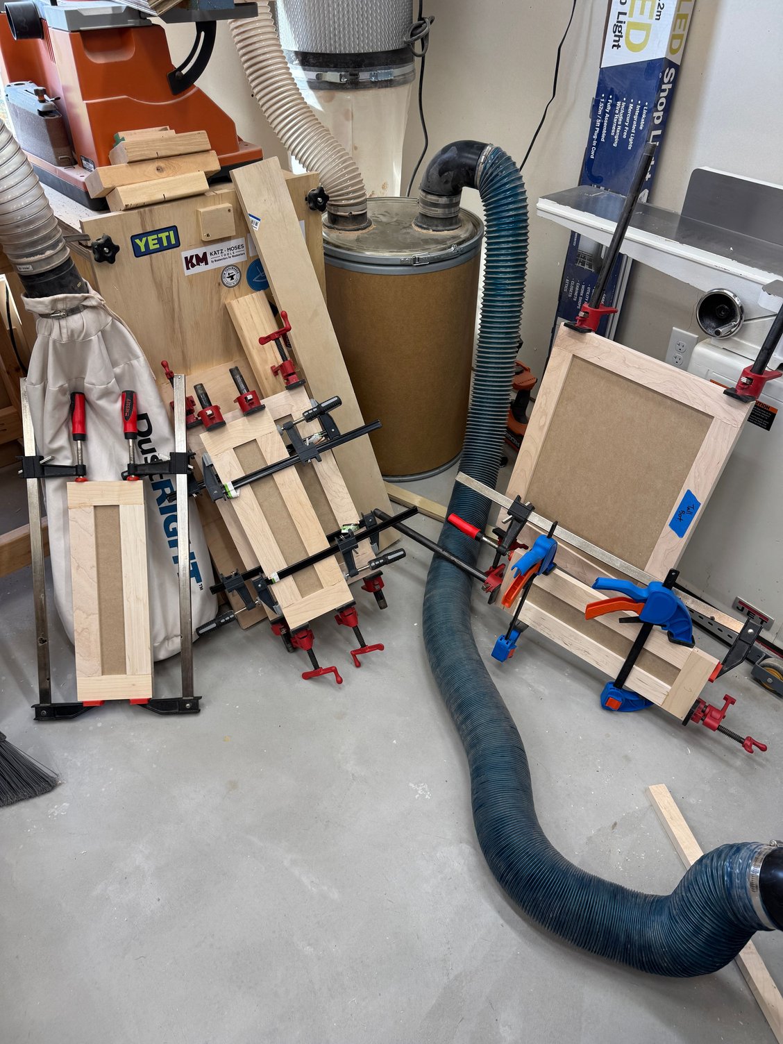

The slow and steady march towards completion continues...but at least the drawer fronts are done lol.

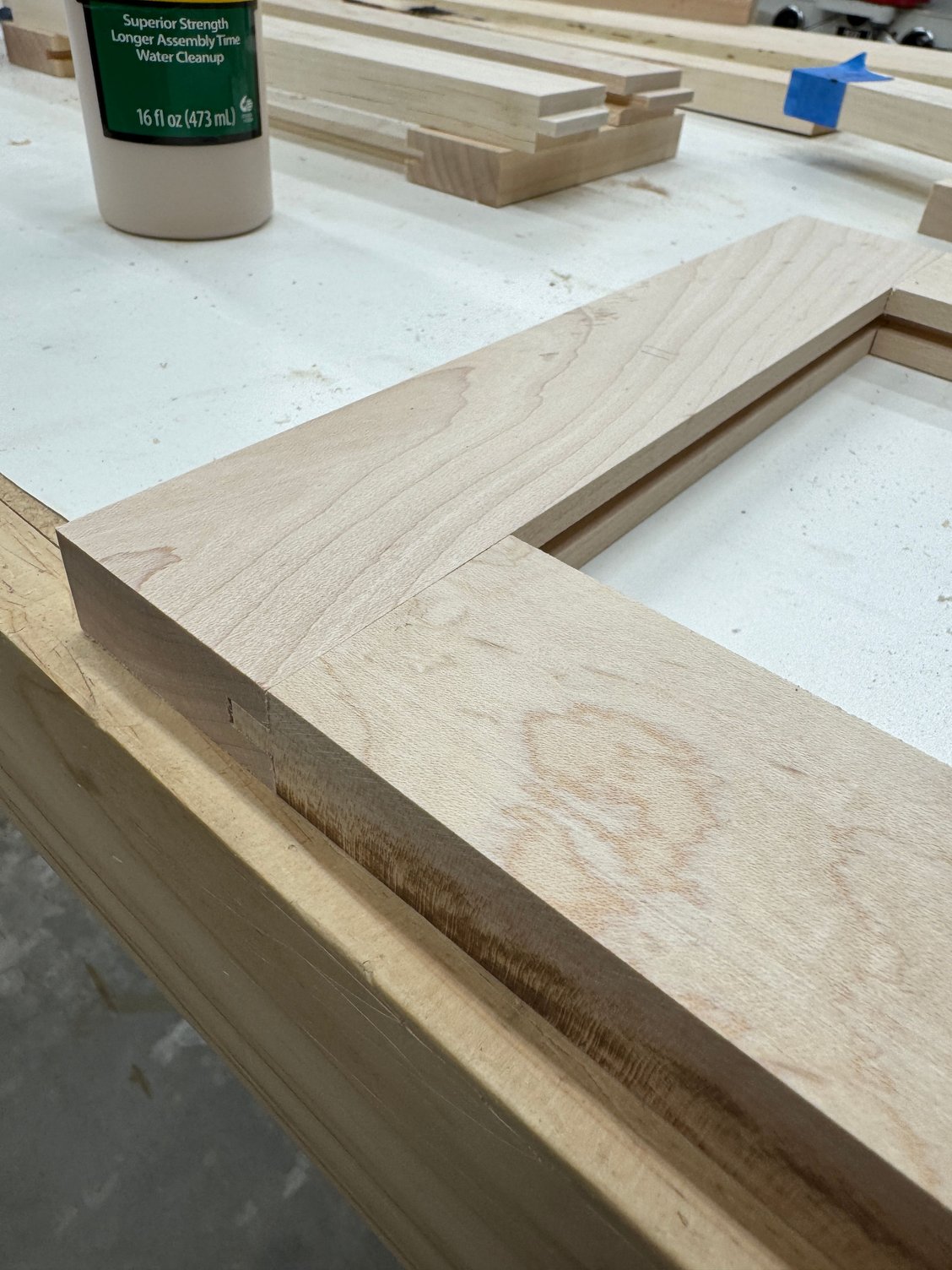

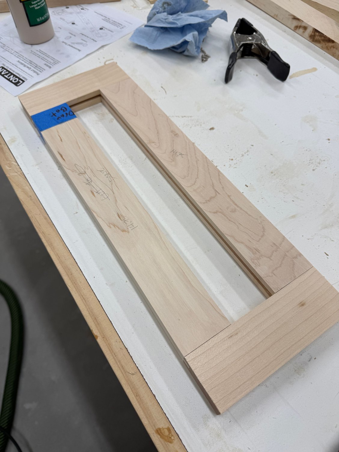

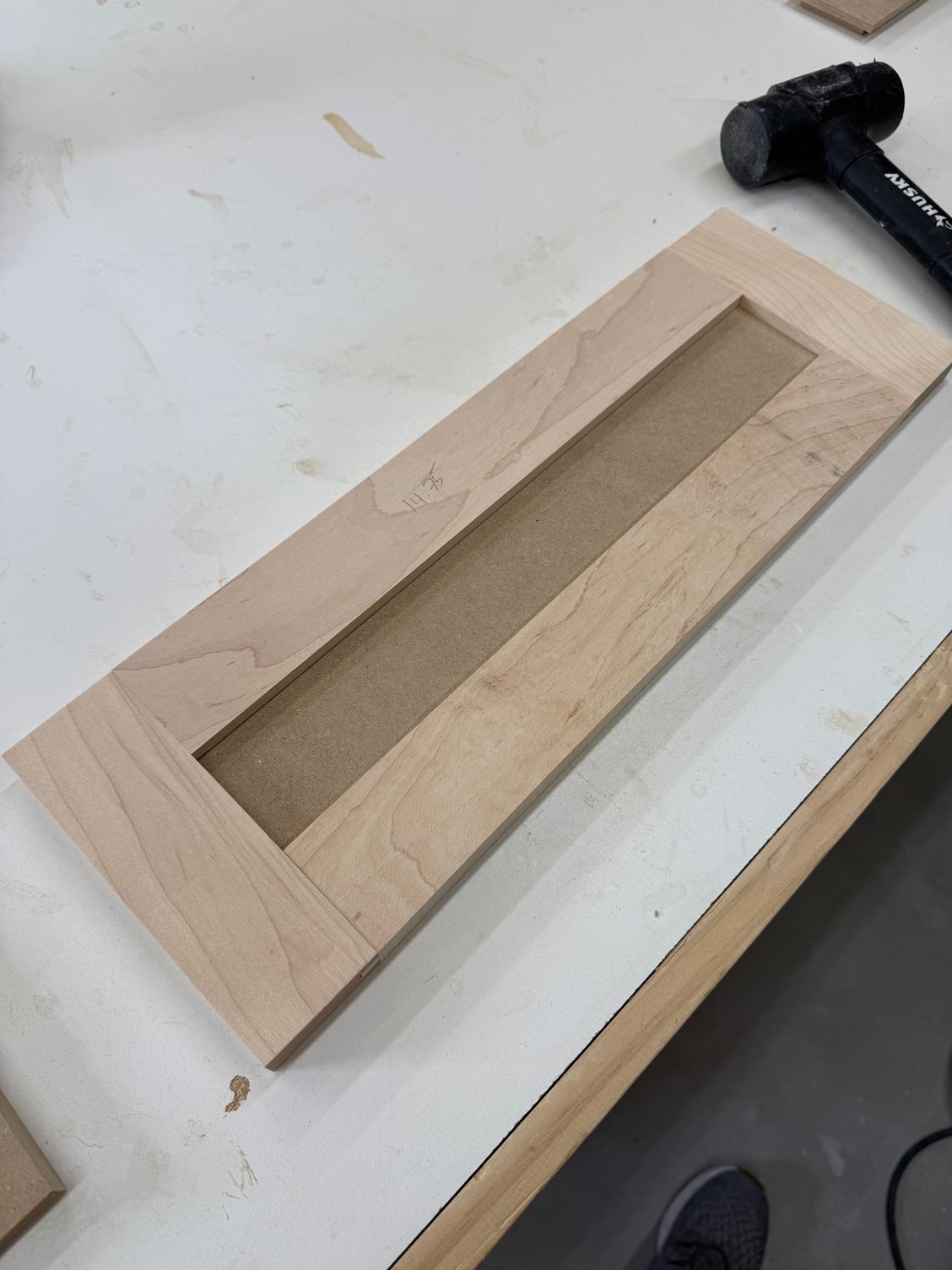

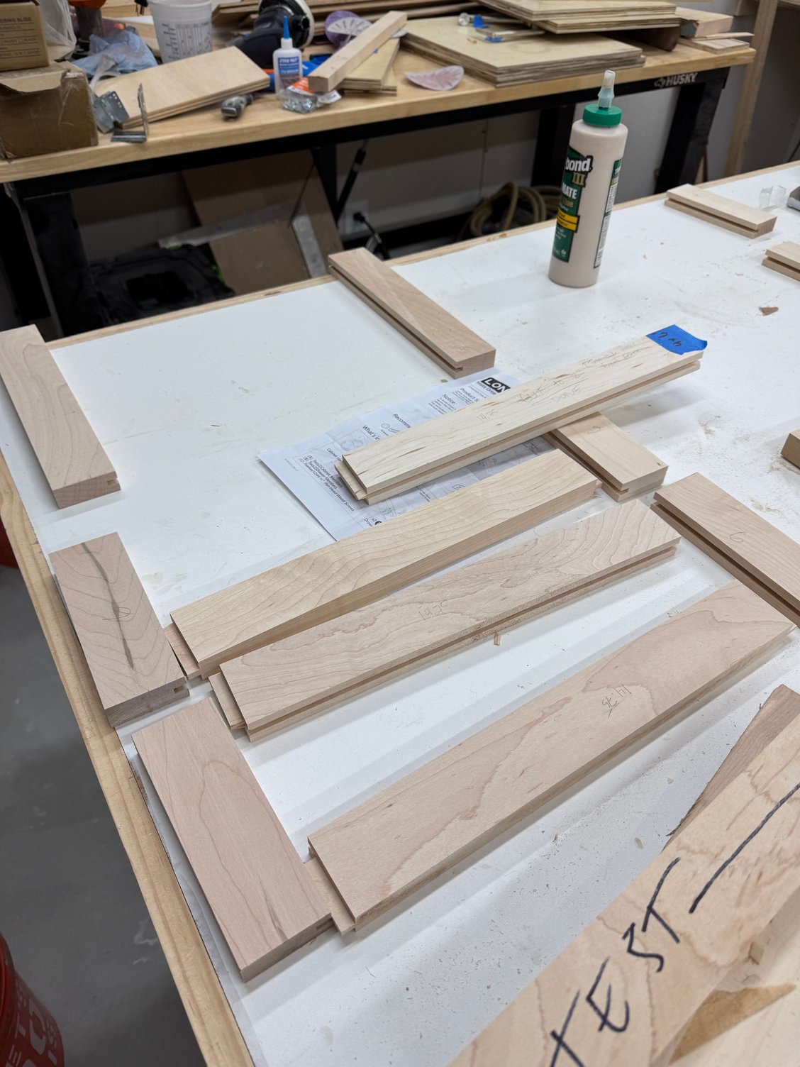

I don't know if I've shown how I make cabinet doors/drawer fronts on here before but here we go. If you've seen this already, feel free to stop reading here lol.
Step 1 is to cut all the rails (horizontal pieces) and stiles (vertical pieces) to length. The length should include the size of the opening to cover as well as the overlay amount. I did something different and have a different overlay in the horizontal direction (1" per side) and vertical direction (3/8") just because of how the cabinets are assembled. In the picture below you can see much of the joints already cut and I'll show more but the big takeaway from this image is the 1/4" wide by 3/8" deep groove centered down the middle to accept the center panel.
I use a piece of scrap plywood as a sacrificial fence on the table saw that my dado stack cuts into to give me the ability to make a full width cut in one shot without destroying my actual table saw fence. With this, and a miter gauge set to 90deg, I cut all the 3/8" tenons to fit into the grooves cut in the last step. These are only cut on the rails, the stiles just have a groove.
You then stick the tenon into the groove (giggity) and this is what the door frame looks like.
And this is what the joint itself looks like. There's a small gap in there to allow the outer shoulders to seat nicely. This gap can be filled later on before paint but gives a nice tight joint up on the visible face.
Next up is the panel which, in my case, are 1/2" MDF panels cut to the size of the inside of the door frame plus the depth of the groove on all sides so an extra 0.75" in both directions. The dado stack is again used to cut a 3/8" rabbet on all sides to fit into the door frame with the height of the blade adjusted to take off enough material to leave a rabbet to fit into the groove in the door frame. Looks like this when you're done. You may ask why not just use a 1/4" panel instead of 1/2" and that's two fold. One because the heft of the 1/2" MDF is really nice and two because it leaves a flat back to attach to the cabinet. This isn't a big deal for doors but is a huge deal for attaching the face to a drawer box. Using just a 1/4" would leave a gap between the face and the box that you'd need to figure out how to fill.
And this is what a finished face looks like! Just needs a quick sanding before paint. The great part is that sanding is just to even things out and smooth it over. These will be painted so no need to have a great perfect sanded surface which is a refreshing change of pace lol.
And this is why I keep telling people to buy more clamps lol. I think I only had one or two left on my clamp rack after getting all of these glued up.
And that's it! All that's left now is to make the giant door for the tall cabinet and we can get into painting. I'm slowly working through all of this but it's taking forever because my life currently revolves around running as the marathon is October 5th. Then my schedule frees up considerably.

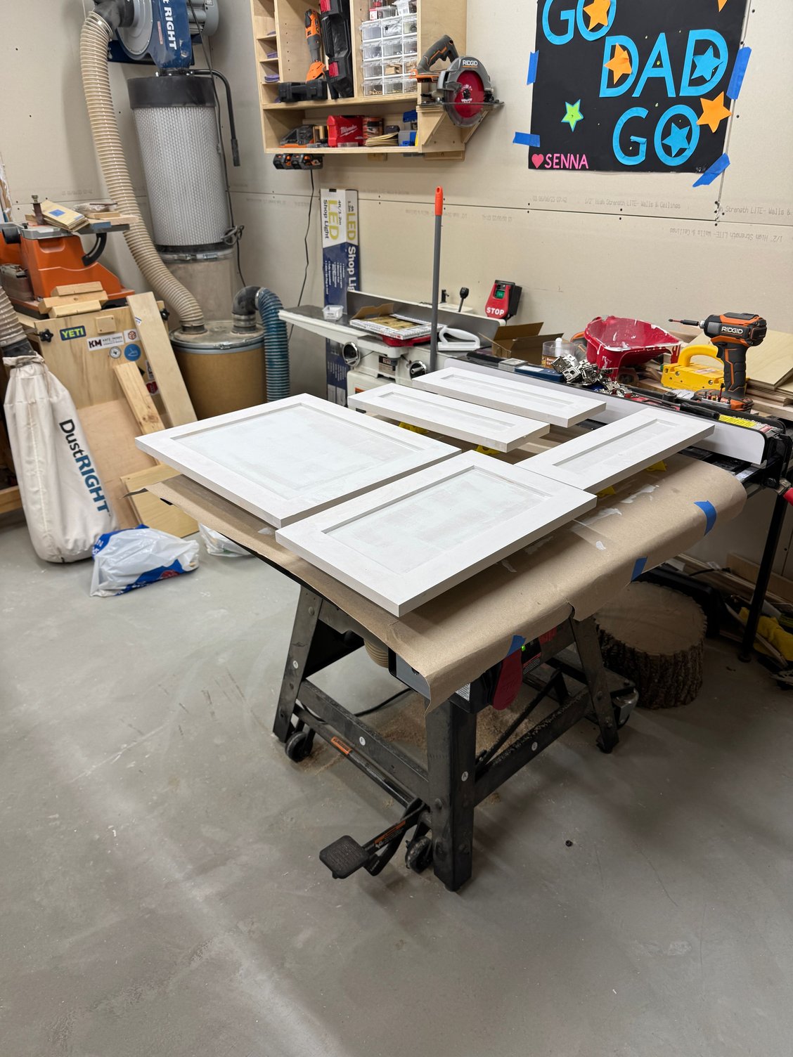

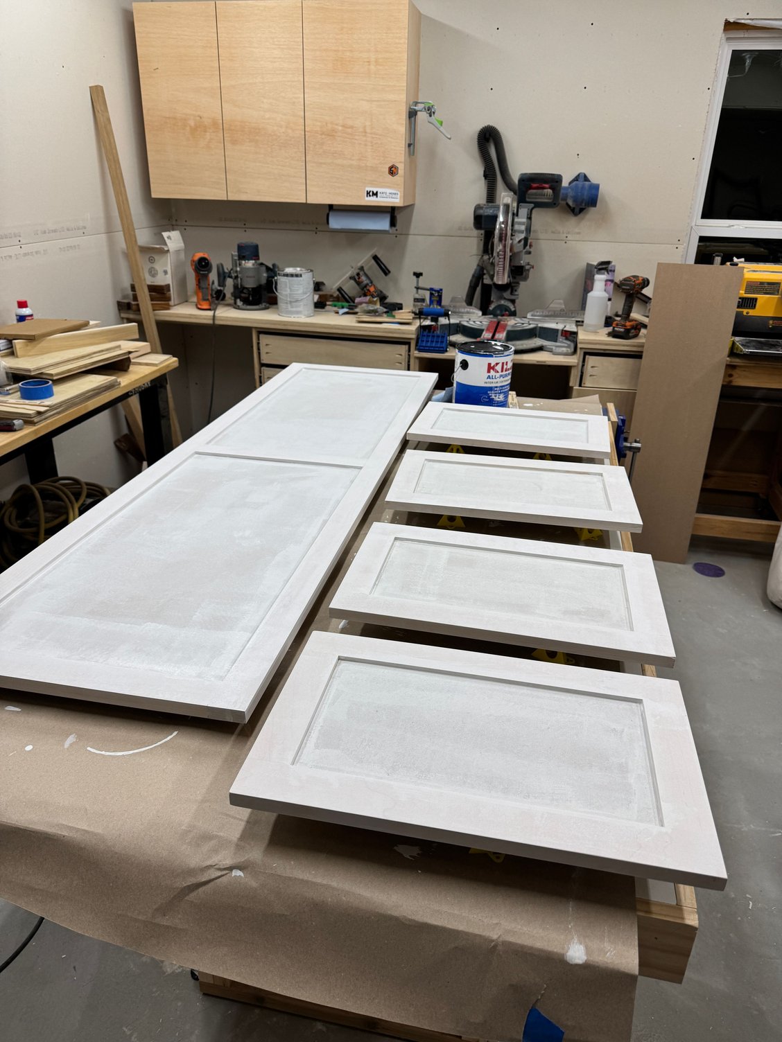

Drawer fronts and big door are primed and ready for sanding and then color paint. Have I mentioned how much I hate painting?

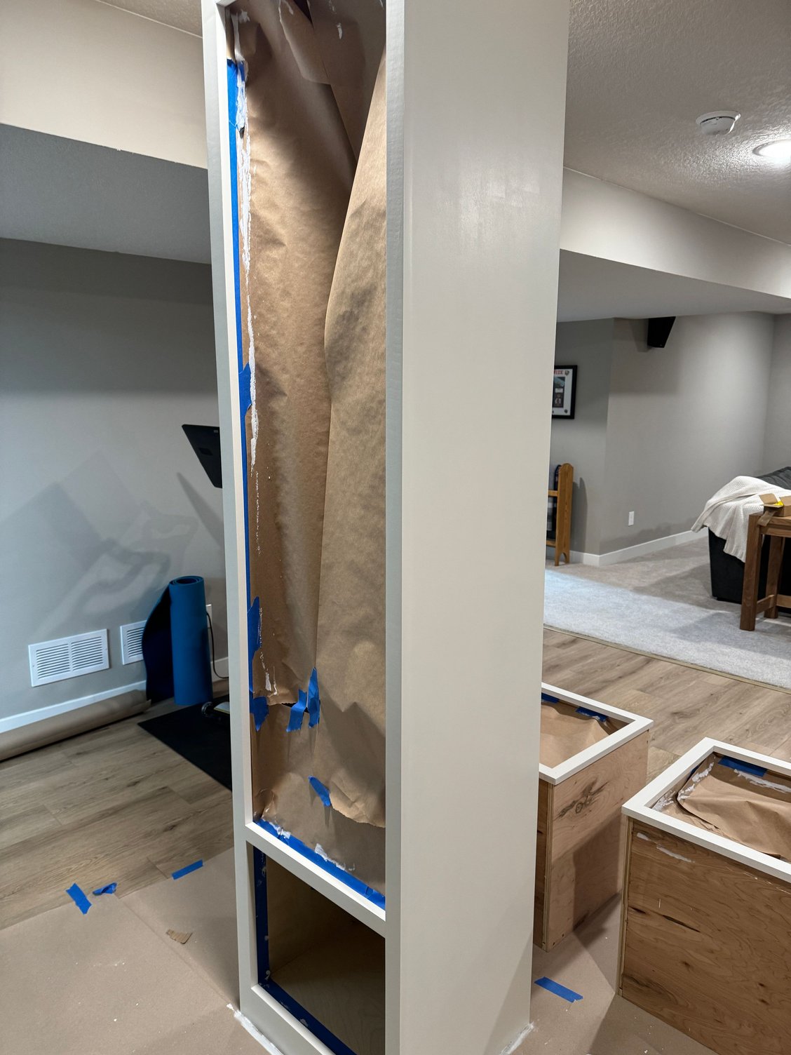

It has been a long time coming but finally got these painted and installed. I'm now doing the epoxy fill work on the wood slabs that will make up the bench and countertop. As an excellent influencer, I did not take pics of the epoxy fills lol. It unfortunately takes a while to do the filling as I can only do one side at a time and it usually takes 2-3 rounds of filling as the epoxy flows down and fills cracks...and then 5 hours of cure time in between pours.

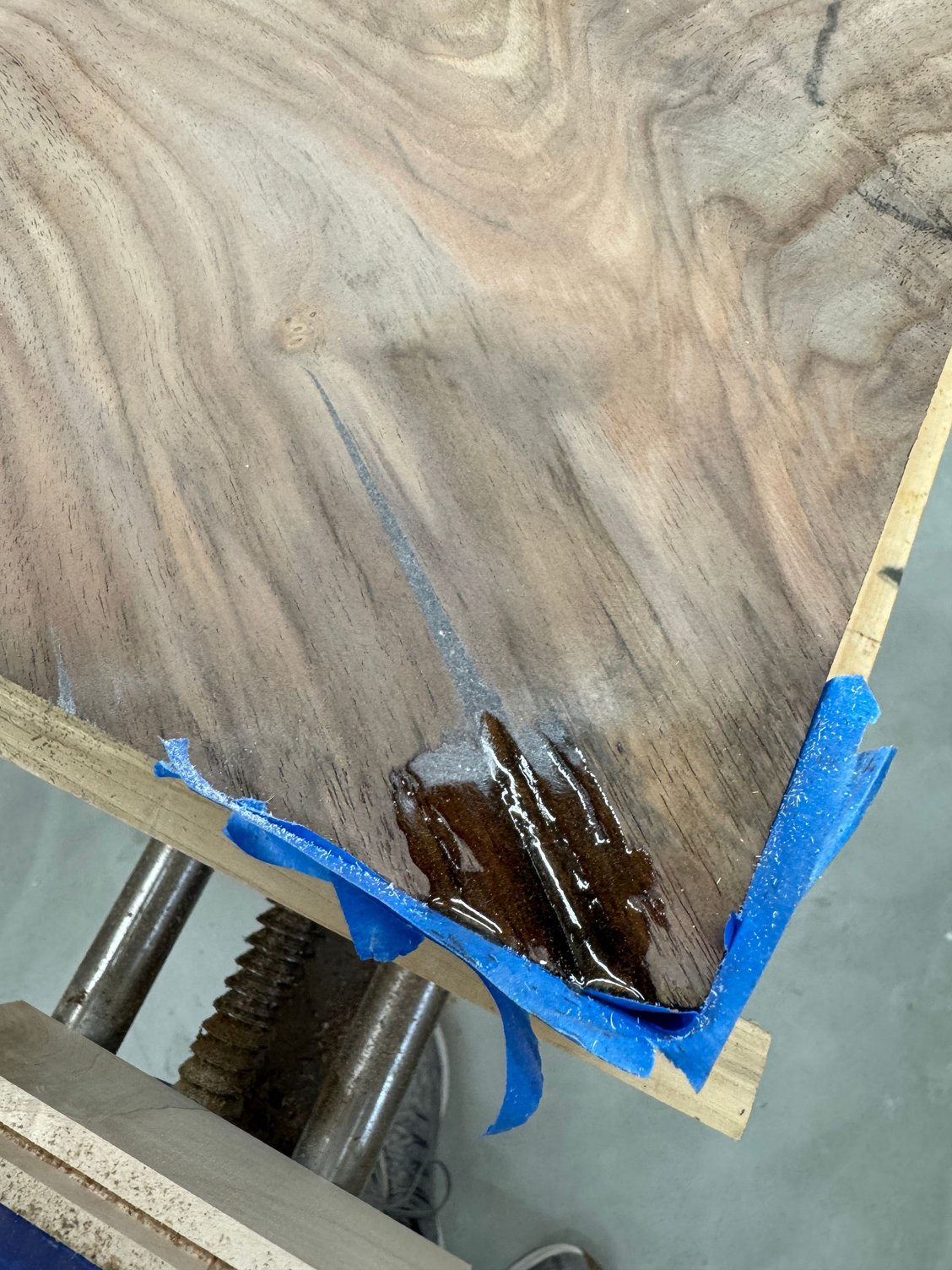

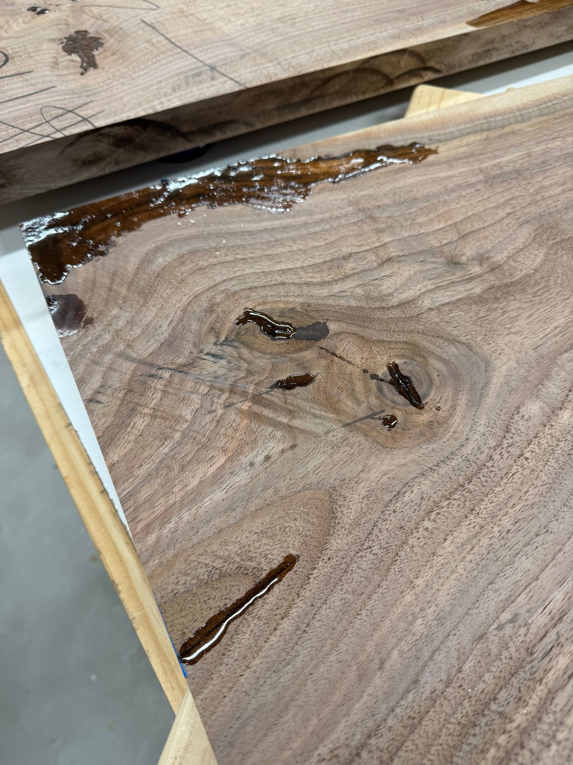

Alright, so here's some epoxy content! These are pics after the first pour round but whatever, the process is the same. I use West System's epoxy with slow hardner (less heat, less sensitive to pour depth, 5hr cure) mixed with some brown pigment to make it blend better to fill in all the cracks, bug holes, knot holes, etc that are in a full slab. All of this would get trimmed off and disposed of when making actual lumber but it's a fact of life with slabs.
You can see in this picture how the cracks/holes get filled. It's a long process of pouring in...waiting for it to settle...pour some more...let it settle...etc.
Then after you get it as topped up as possible, you let it sit to fill down in further and cure for the 5hrs only to find that you definitely need to add more lol so sand flat any excess from the first pour and rinse and repeat the first step.
