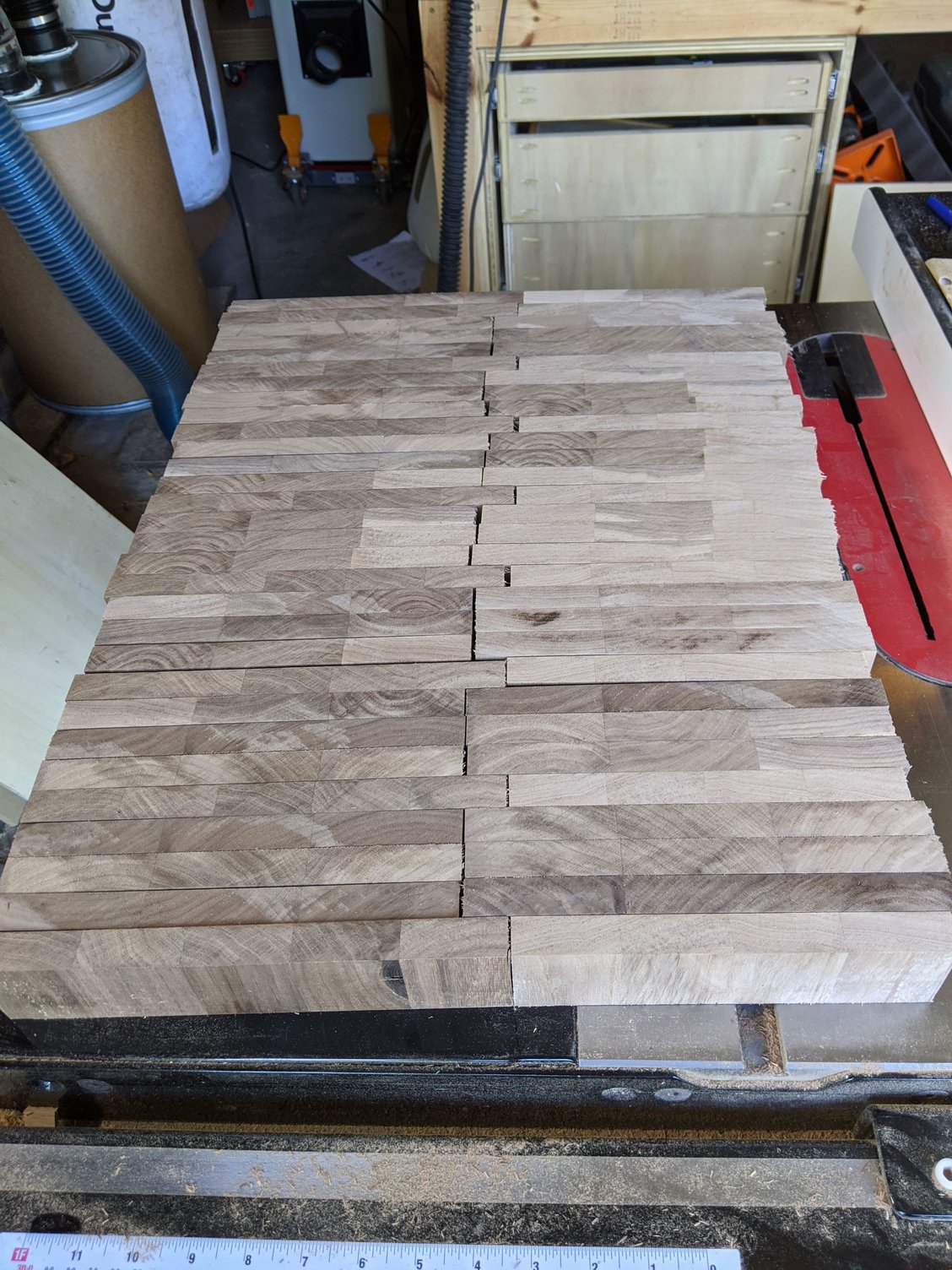

Is this a cutting board or a countertop? This thing is an absolute monster, biggest one I've ever done. Please note, not arranged completely or glued up.

Next up is this behemoth of a cutting board that's getting through the initial glue up. I couldn't possibly glue this thing up in one shot and have even a remote prayer of it staying flat so I'm basically doing it in zones that I'll domino together to get it to line up. The last of those zones is drying as I type this. Final glue up will be tomorrow and then we sand. @thoiboi I took a couple liberties with the design pattern to maximize material yield but it's all still 100% walnut.

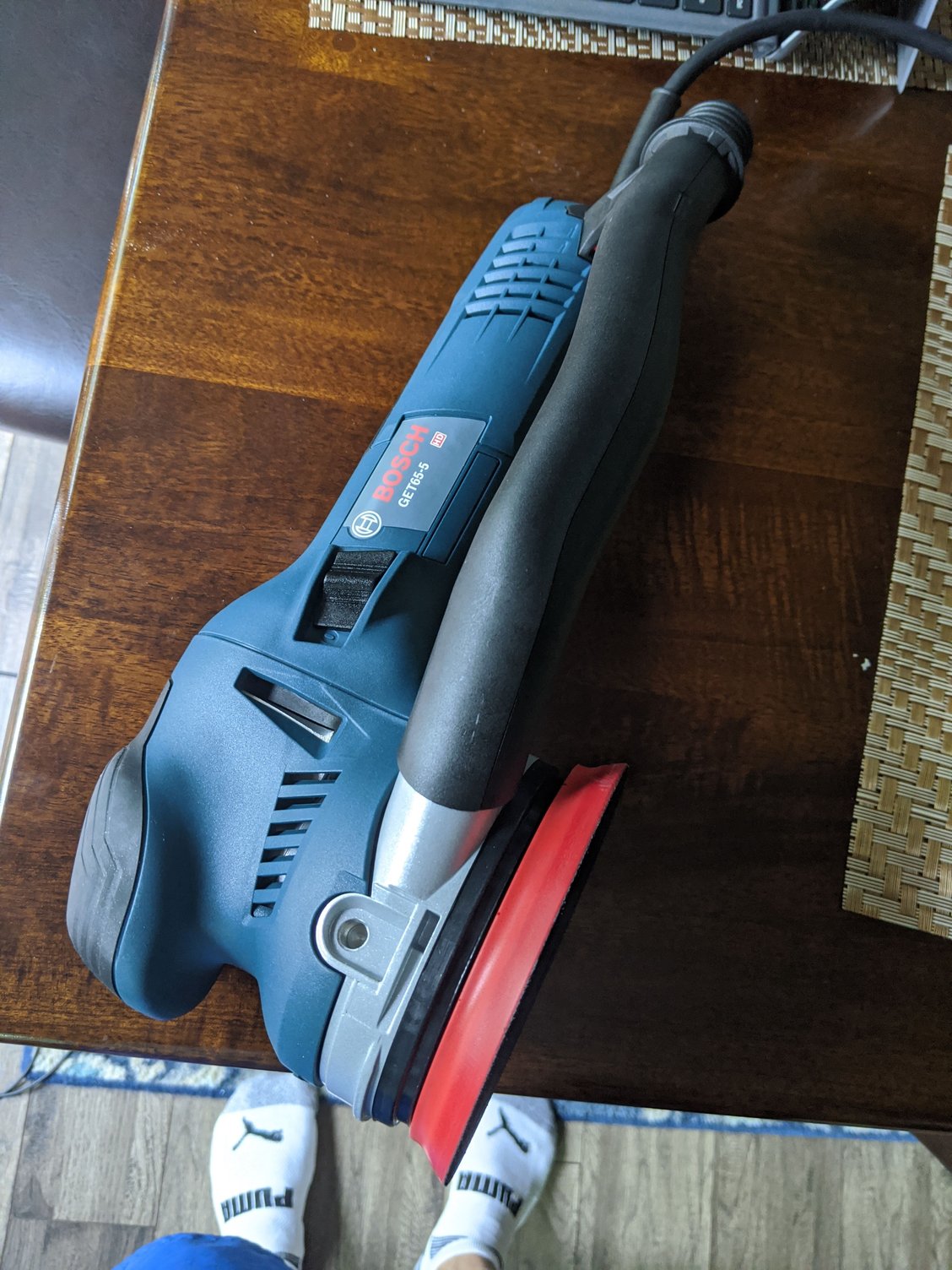

I have whatever 5" random orbit Dewalt you can get at HD for $50-$60. It's nothing all that special but has been getting the job done. The downside is that it's super easy to stall the pad (not much power), the dust collection sucks (not in a good way), and the thing vibrates like crazy while using it.
I replaced it with a Bosch GET65-5, this thing looks like an angle grinder and will eat material super fast. It has a turbo mode which is like Festool's rotex mode that basically makes this into rotary tool (like for car polishing) but can go into normal random orbit for less aggressive work as well. I turned it on to try it without sandpaper and there's minimal vibration and the dust collection seems super awesome, I can feel air blowing out the dust pipe and I don't even have a vacuum hooked up. The only downside is that it's not great for finish sanding. This thing is the same as a Festool RO125 but costs ~$250 less.
festool
Like I said, the Bosch isn't great for finish sanding so I also got a Festool ETS125R.
I'm not sure I'm going to keep it yet though, we'll see if the pairing of the Bosch and Dewalt will be sufficient.

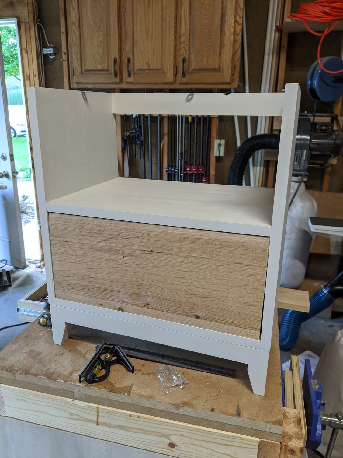

Getting close to wrapping up these two builds. Next up will be a couple small things before I go into the crib build.
First up, the night stands are nearing completion. The drawer fronts are dry fitted but still need to get the final sand and finish. Other than that, ready to go. They'll get finished at the same time I finish the tops which should be tomorrow at this point. I'm happy to finally have this off my plate lol.

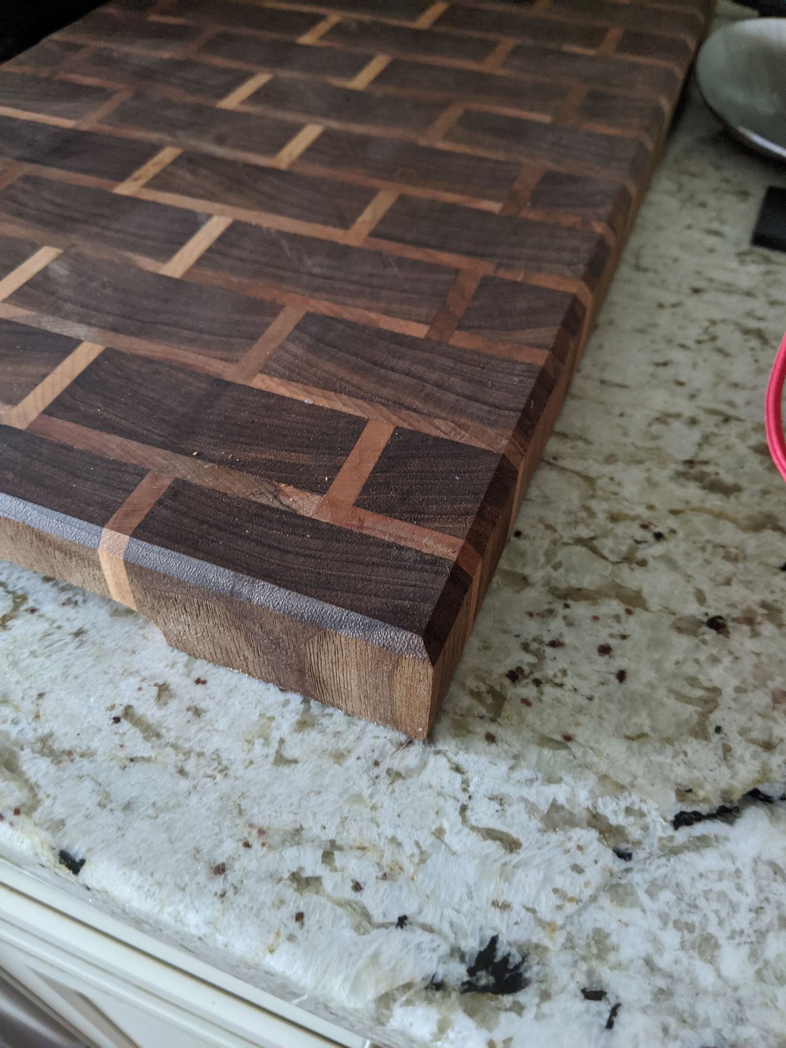

@thoiboi here's the beveled edge.

yes want

You got it, beveling it now!

Now You got me thinking... you plan on XUKP- both sides since It’ll be reversible?

It's already beveled on both sides.
I'm going to oil it today and it should be ready to send out to you either Sunday or Monday. The oil needs a little bit of time to dry before I can put it in a box.
