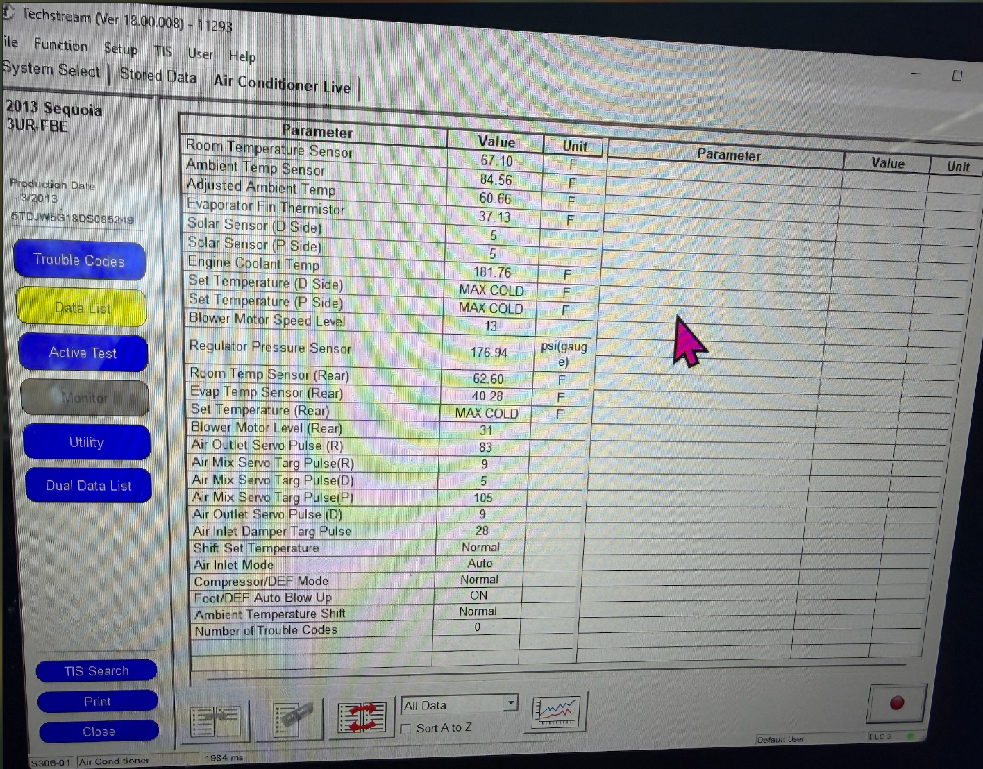

Firestone said it was the 18 month old compressor, 1800 later they gave up giving it back with no HVAC at all (panel dead) I diagnosed the AC AMP (ecu) & got that back. Searching said it was the 2013 pressure switch which is more of a logic circuit so of course not the 129 unit, the 220 unit, they grudgingly replaced it (they had refunded the 1800) it is somewhat better (cooler) but still the compressor & condenser fan shut off under 1200.
Seems some system is commanding it off at 1200, Firestone insists the r134 is at the correct level for a rear AC Limited Sequoia.
I'm damned.
Not like I need AC though.....
This is holding the throttle at 1200, let up, it climbs.

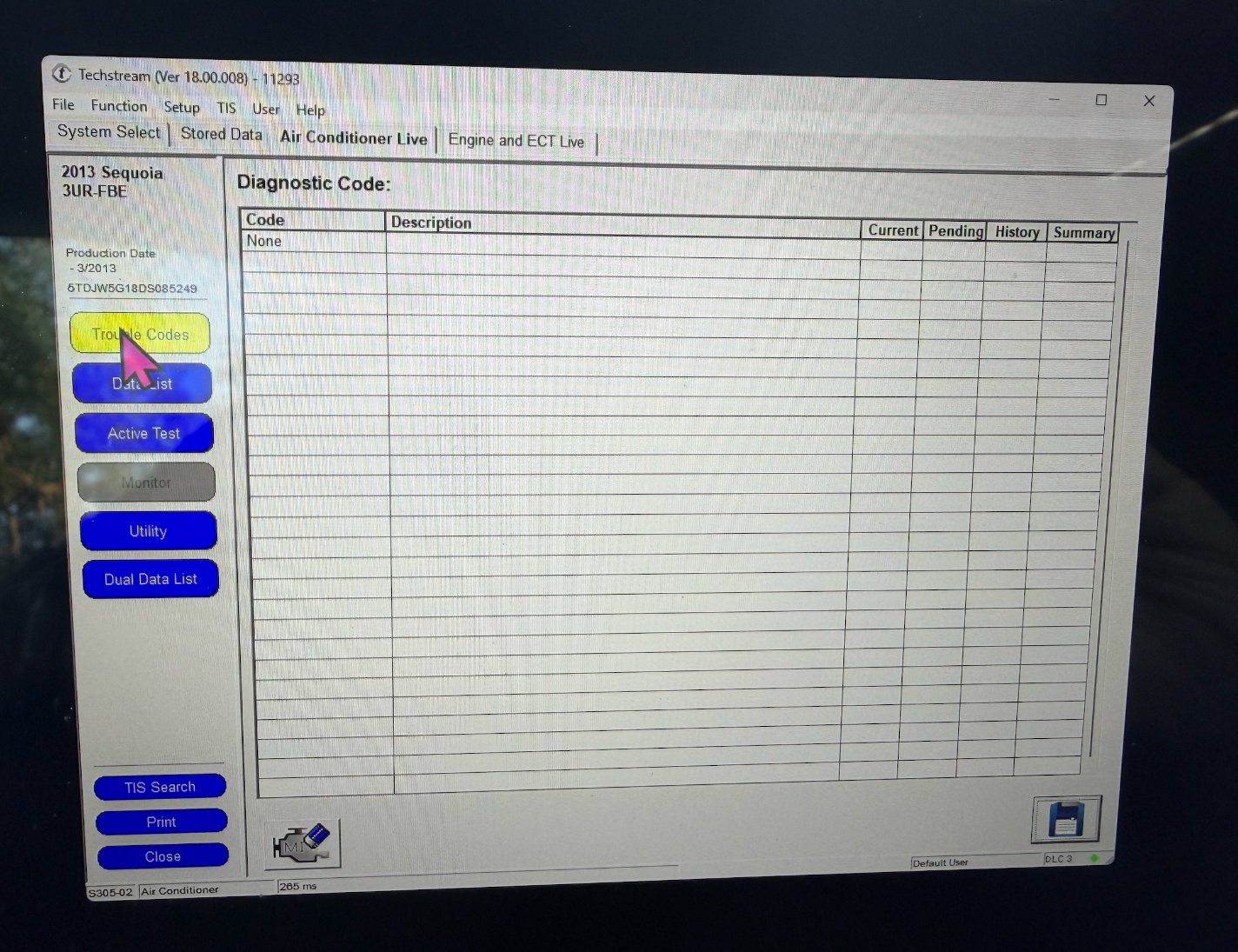

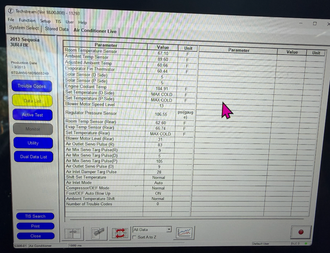

I spent the last hour testing. The AC light turns on when commanded by Tech Stream but under 1200 no compressor. I found a servo initialization and hear the flaps run but no change.
These are under/over 1200. Temps are great over.

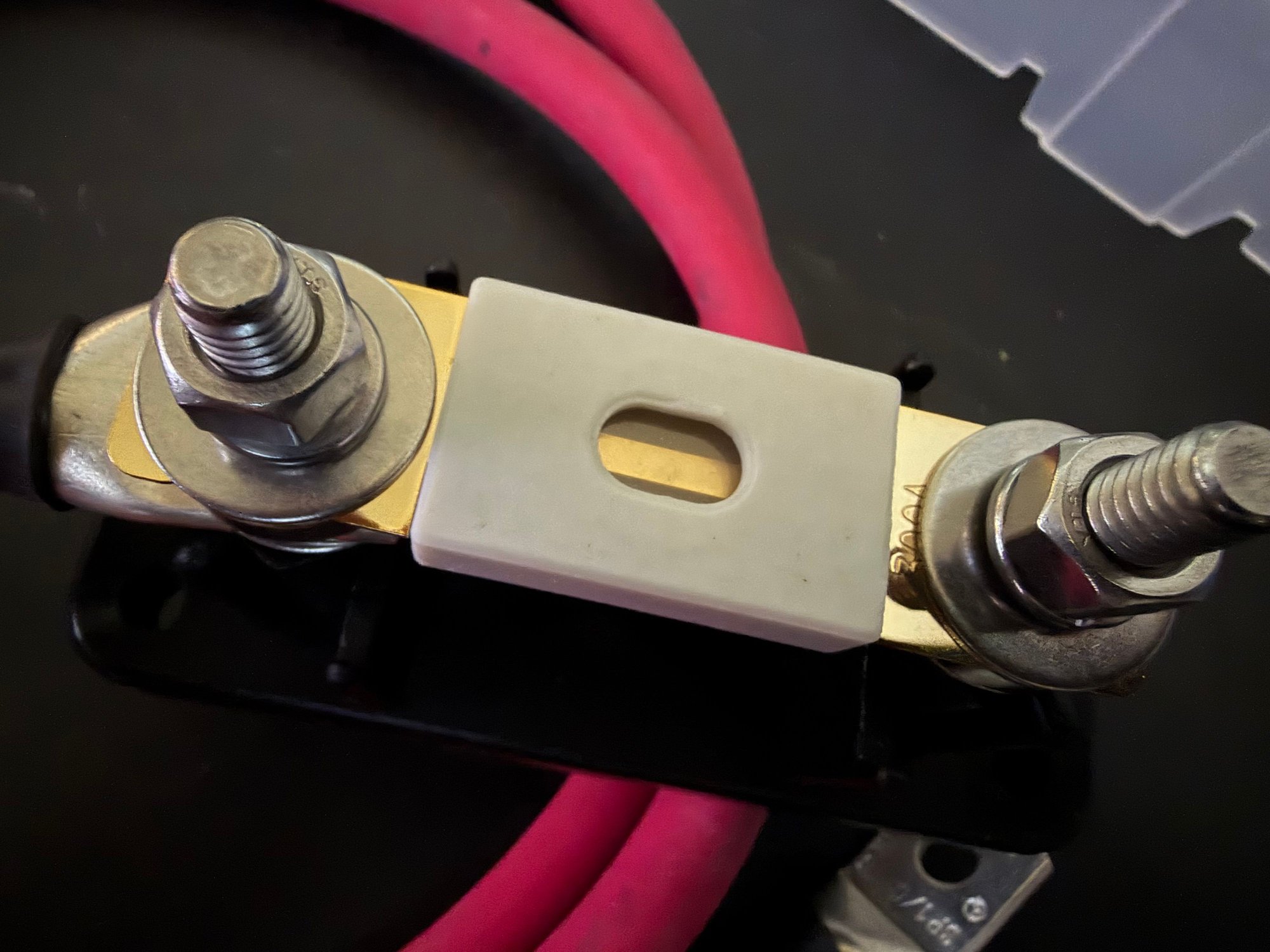

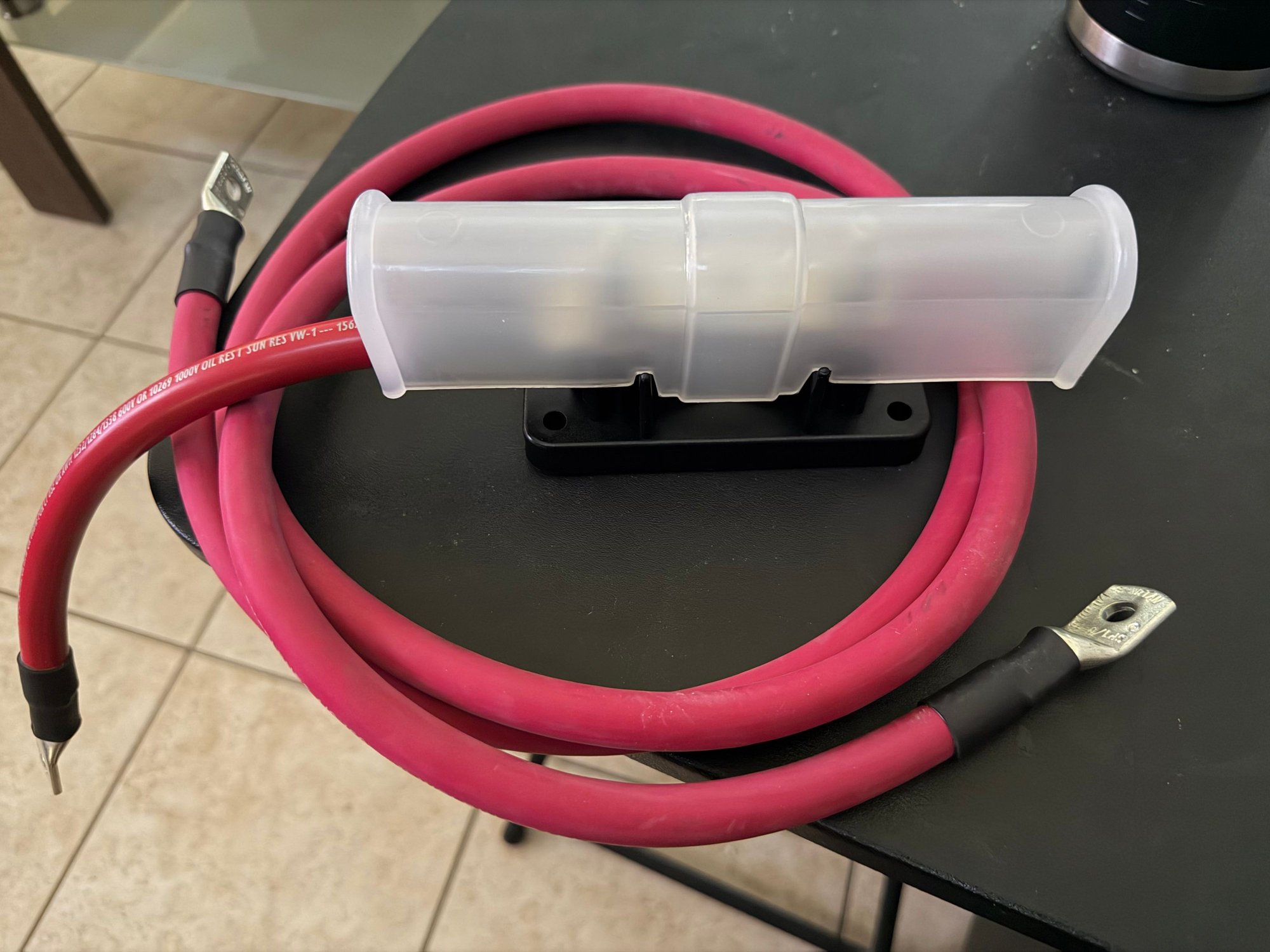

0ga alternator cable & 300 amp fuse came. Who knew? The most direct route from Reno to Phoenix is via Memphis.
