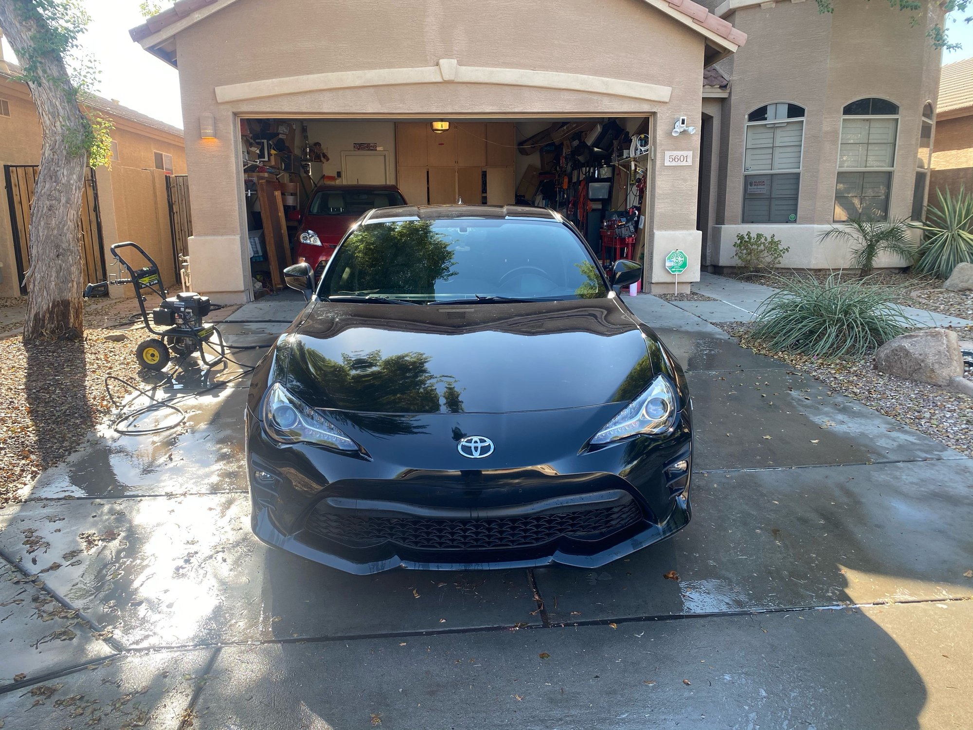

Got home, new foaming pressure washer attachment & Chemical bros soap was here it was semi cool so I washed the car.
Also, getting ready....

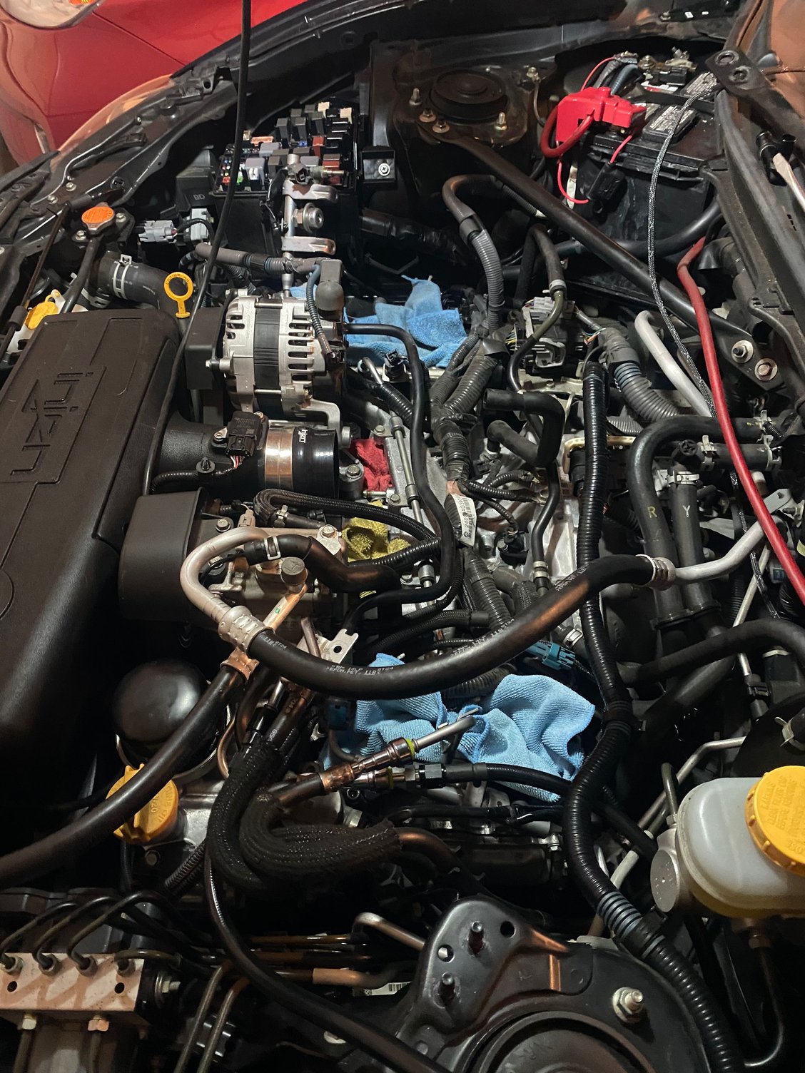

Disassembly has commenced.

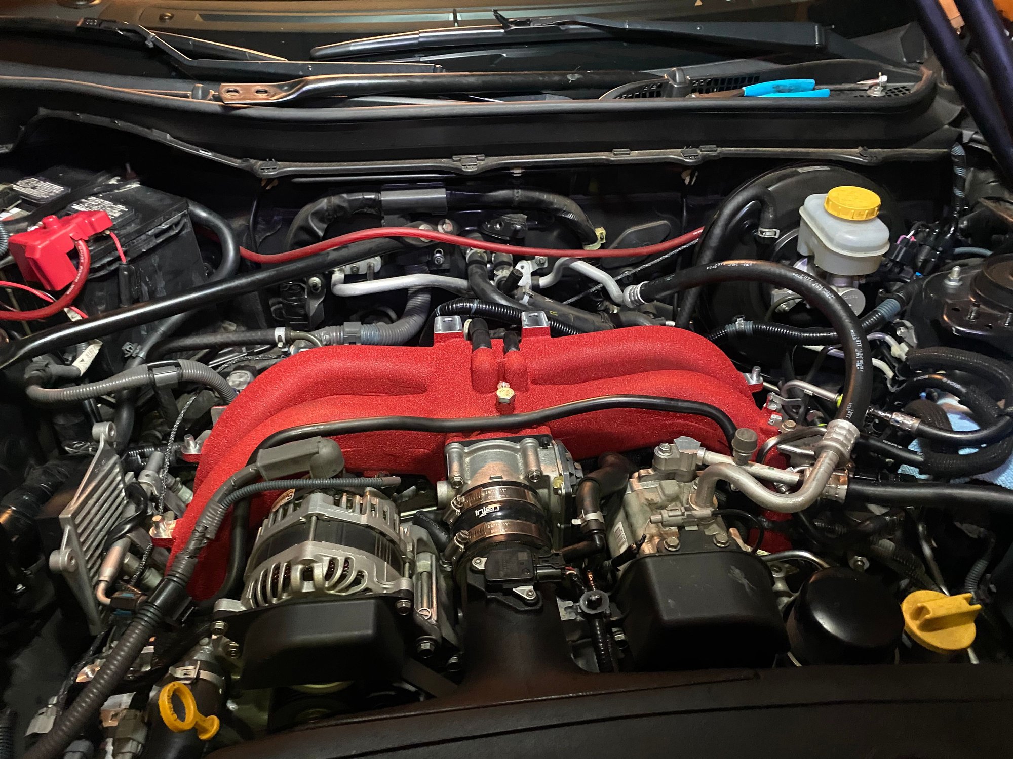

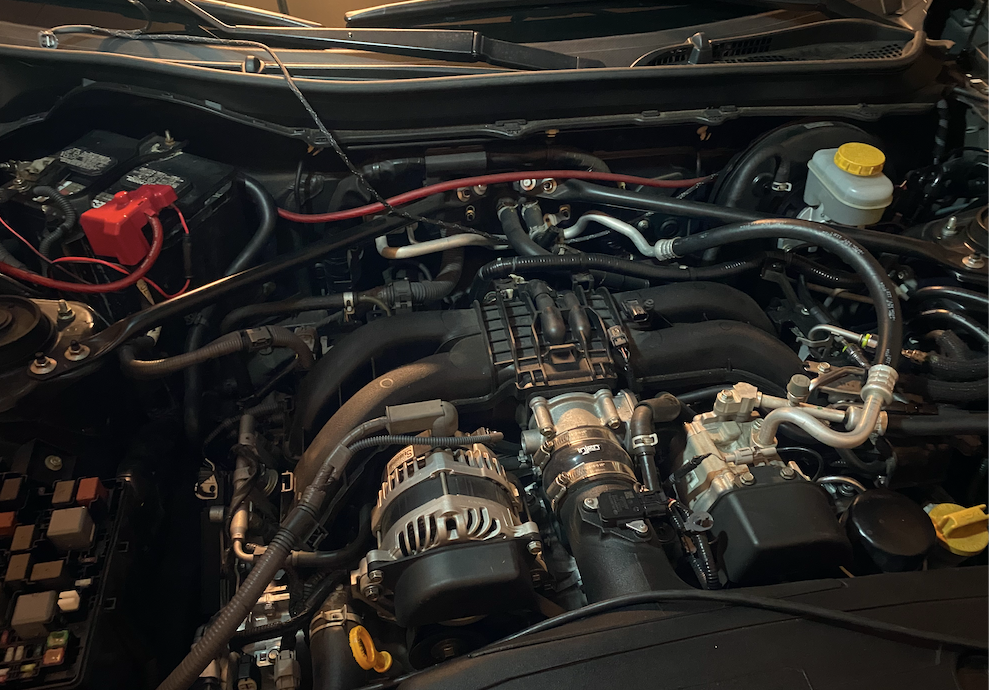

It's done. I also bypassed the stupid throttle body "coolant" hoses. Of course, the back one leaked. It was a major PITA to find but it's done & feels great! Going to do a log & send to my tuner to see if any tweaks are in order.

Definitely an aesthetic upgrade.
Does it provide any other benefit?

if he's sending a file to the tuner there's no way he went to the trouble for a look

Purportedly 5hp stock (they advertise the 6at at 200/6mt with this manifold at 205, but definitely better flow.

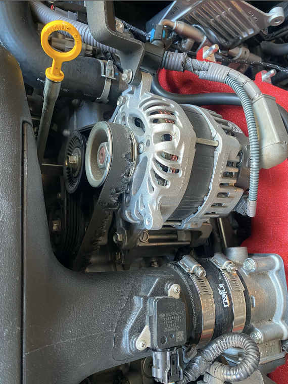

On the way to the trip to get the file I heard a horrible nose. Stopped, serpentine shredded itself.
I came home, got another car, went to O'reilly & found out there were no masks in the fucking car.
Came home, removed the belt and got the part number for Gates & Continental and am going to rest. I'm freaking beat.

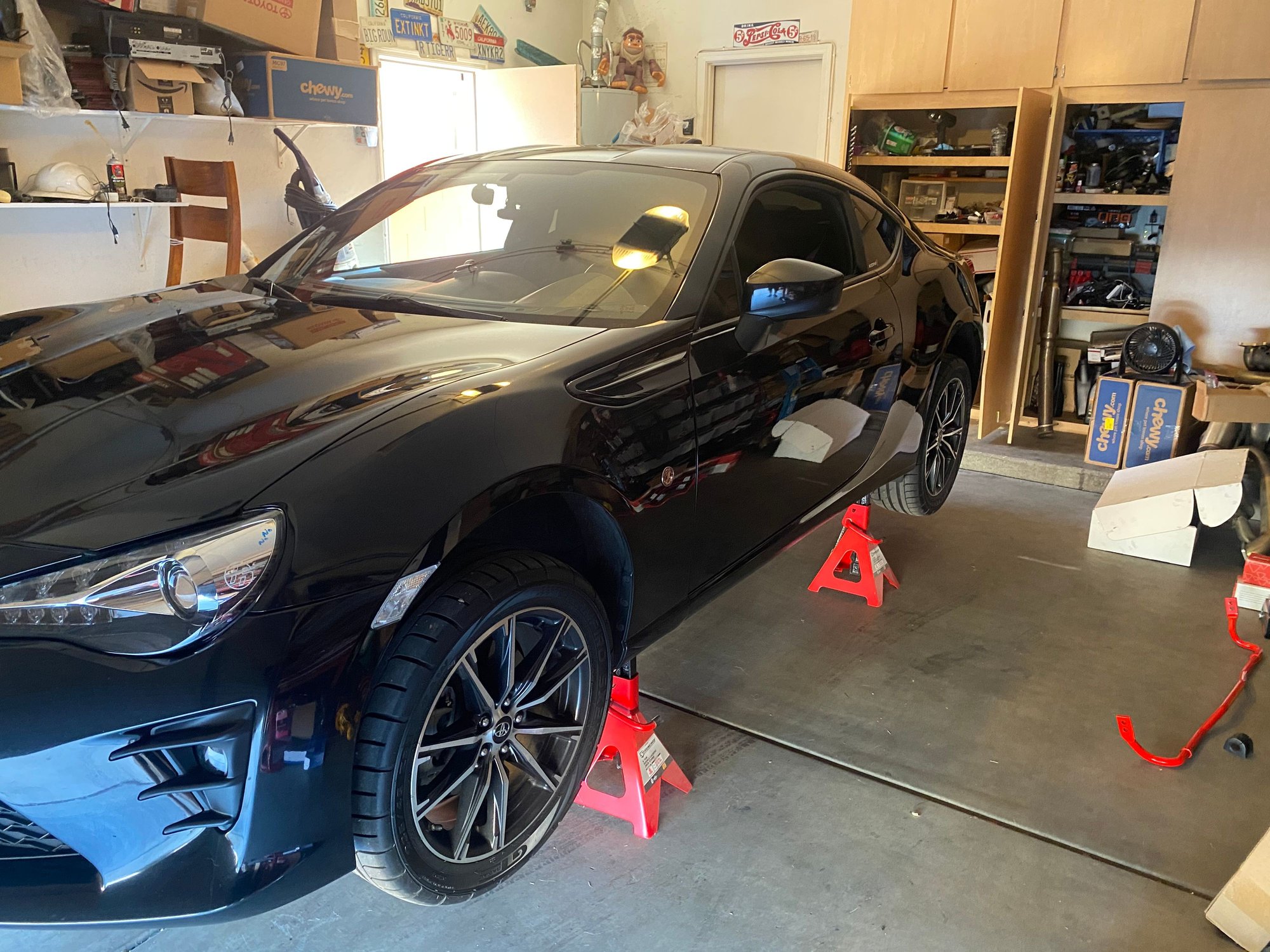

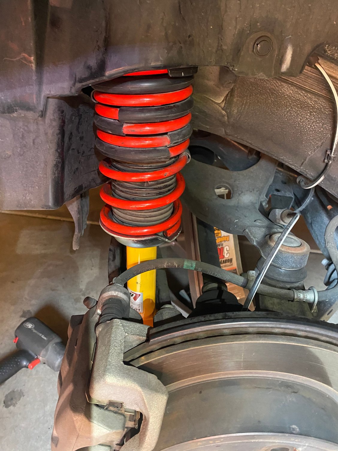

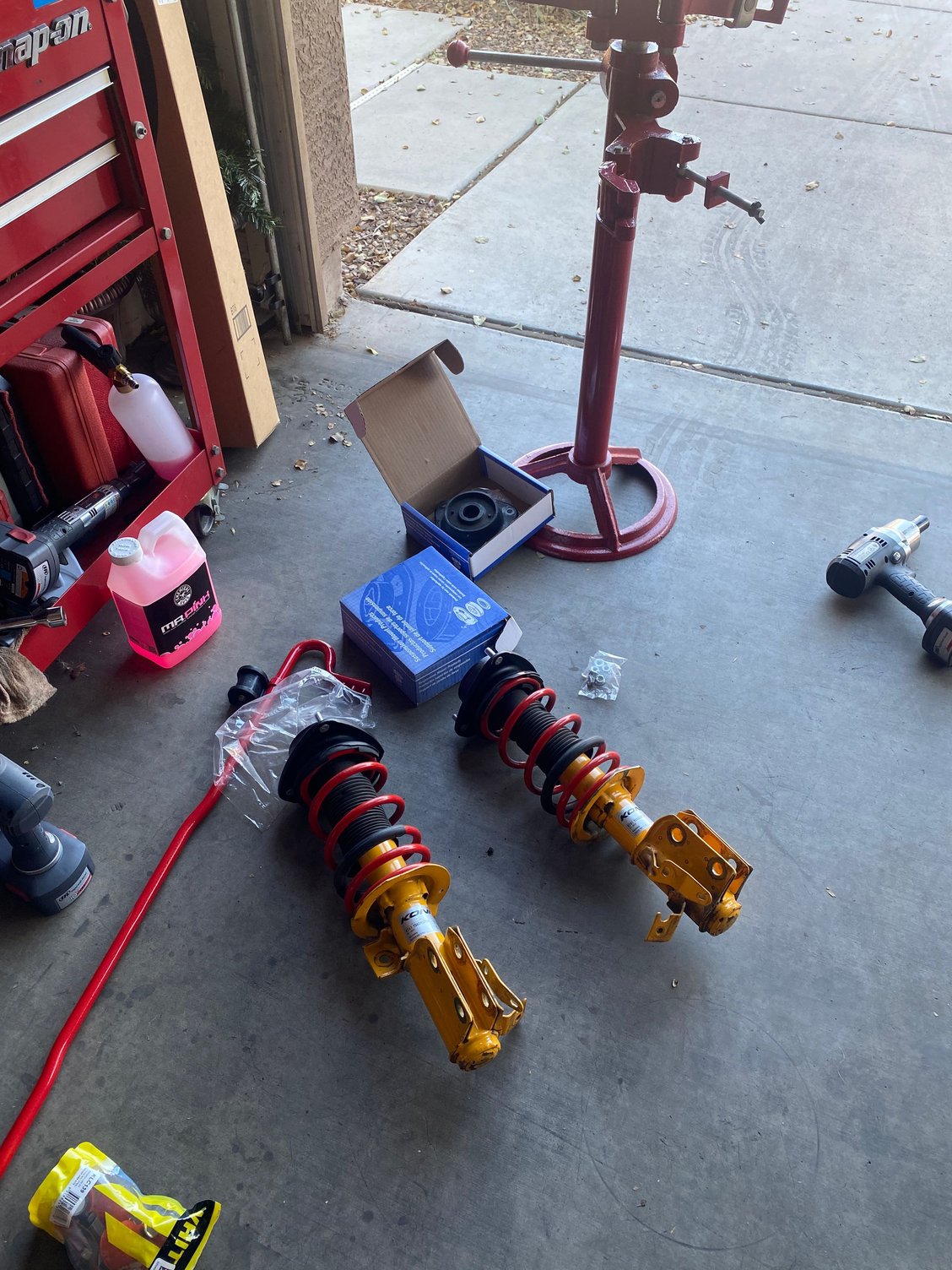

Suspension has commenced.

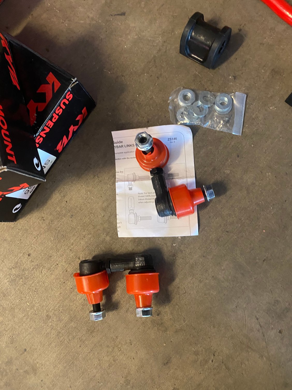

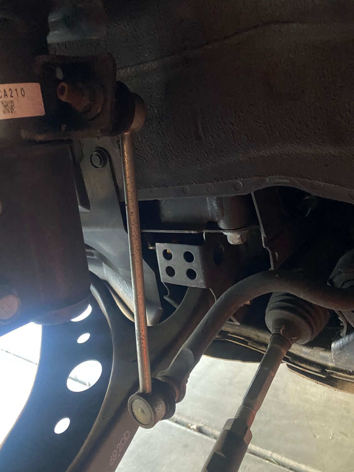

Fooking front endlinks are wrong. GAAAAAAAA. Putting it back together sucks!!!
What I need:
What they sent:

Decided to use the OEM end links in front, disassembled the rear interior panels & removed the two nuts from the shock mounts, it's 105 now so I'm taking a break.

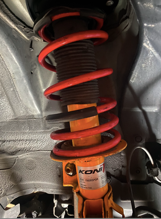

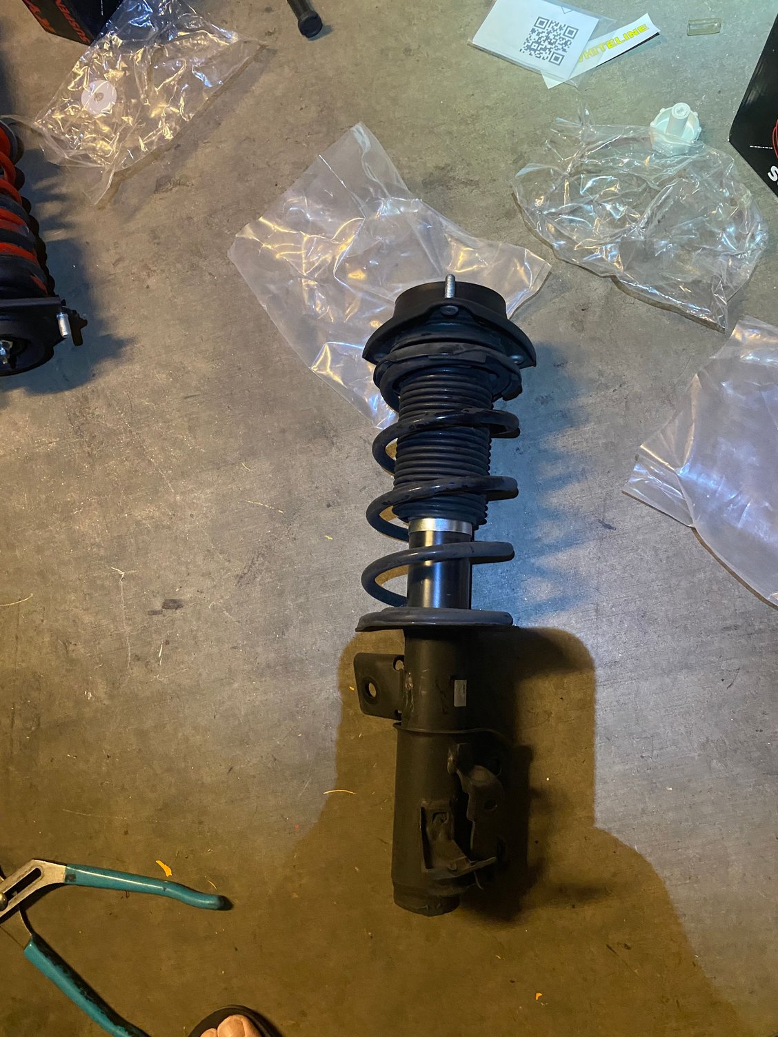

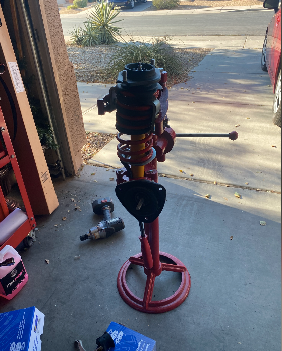

It was 109 but I wanted to get more done & figured assembling a rear "strut" is easy NOT!
My spring compressor that was great on the jumbo Tundra shocks SUCKED on these puny shocks (front & rear)
Got one rear done, had to use the old front shock mount that came with the fronts to get near closing on the shock.
Was only 108 when I came back in, still need to assemble the other rear.

Got the second shock assembled, much easier than the first. ready to disassemble the car. Hopefully, I'll start tonight.

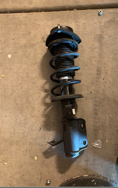

One down. 37k strut looks new.

Eibach Sport. I was under the (illusion)? 1" wouldn't need anything but a new alignment.
It has been super easy so far, (air tools rule) really the hardest part has been the stupid clips holding the ABS & pad wear sensor wires to the struts. (how the fuck is that possible)?
it's still freaking 92. If it were even 85 I could have knocked the progress so far in about an hour, I just can't stay in the garage that long.

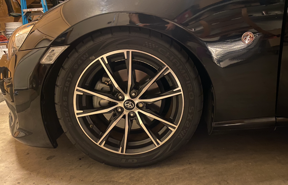

Done. Front seems low & back seems high.
Got lucky, it just broke 100 when I came back inside.
Old Oct 4, 2020 | 02:27 PM
  #556
e30cabrio's Avatar
LFG RANGERS!!!!!!!!!!!
Posts: 13,817
Likes: 2,677
From: Earth
Back seems to be settling.
Funhouse mirror makes me look fatter & more oddly shaped than I am!

Honestly, my desire to do springs and shocks but my love of a perfect drop are what led me to cut dead coils off in the first place.
I have a bit of a reputation for doing so around these parts...only ex wife's accord...on the ctsv on the audi before i swapped springs.
Even with both rear off the ground and sway bar undone it was hard? I have gotten better at doing it on my S4 every single time.
The rear springs are the biggest pain in the ass I've ever encountered...finally found a method using a spring compressor upside down in
one particular spot to get it out...then I compress the new one down all the way outside the car and use a ratcheting tow strap strap tied
up and wrapped around it to hold it that way until I can get it back into the car and positioned before letting out the slack slowly. Very unconventional
but it works!
Old Oct 5, 2020 | 08:27 AM
  #560
civicdrivr's Avatar
Posts: 36,862
Likes: 8,746
From: VA
Your rear spring perches are installed upside down. The inside of the bowl should be facing the ground.
Also, quick tip to make the install much easier - drop the lca. you have to get an alignment anyway, so pulling the eccentric at the subframe is the easier bolt to remove. Disconnect the sway, and then the LCA will swivel down. That gives you a clear path to slide the strut assembly into the chassis mounts. To reinstall, attach the LCA to the strut first, then use a floor jack to raise the LCA into position on the subframe.
