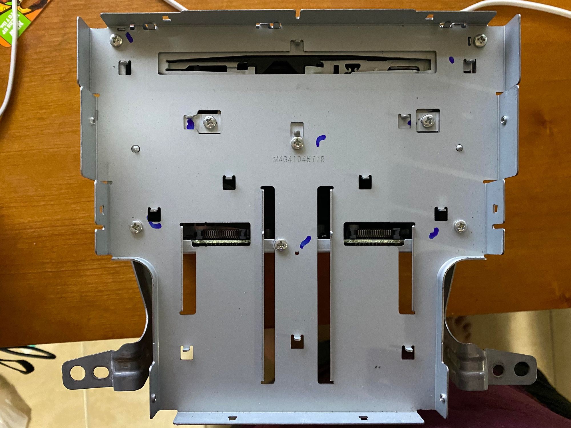

I have a base model radio and here's what it looks like without the face on. Taking off the face is pretty easy. I think there's like 4-6 screws that holds the board and faceplate to the radio. It's on the sides, top and bottom of the faceplate. Once those screws are remove, you can just pull off the faceplate. The board, buttons and knobs are all attached to the faceplate.

found some pictures of the navigation unit. If you look on the bottom of the first picture, you'll see that little small screw. There's like 4 or 6 of those around it. You'll see more once you take out the climate control buttons. If I remember right, once the screws are taken out, you pull from the bottom to pop it loose.

Thanks! I'm assuming once I have the face removed it should be easy to remove the stuck CDs?
Old Jan 8, 2020 | 01:18 PM
RA050325's Avatar
Joined: Jan 2016
Posts: 451
Likes: 123
yeah it should be. The CD player cover insides looks to be held on with a few screws.
