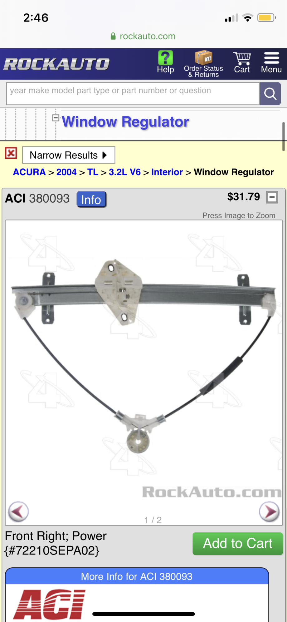

Has anyone sourced or tried a window regulator from eBay? Is it worth the money for OEM? Also found one on rock auto, for $30! Much cheaper than $148 OEM from dealer......Thnks!

Old Oct 7, 2019 | 01:30 PM
Posts: 48,325
Likes: 9,180
rock auto is fine! I wouldn't do eBay

So for drivers side it would be front Left, correct? I know it depends on if you’re facing the vehicle I believe. I guess the motor is separate? Darn! My motor works some, slowly. And stops 1/2 way down. Haven’t popped door panel yet to check to see what’s broke, but heard a clunk, when window was lowered all the way down. Then won’t go lower than halfway now. Don’t want to try again, and have it not go back up....

Those look like they are just the cables, no motor.

I noticed that after I posted. Looked up the motor as well. Then it looks like total for both would be ~$100.....OEM from dealer is $148.20

it could just be slow because the regulator is broken and providing extra resistance on the motor; ergo, the motor COULD be okay. I'd buy both just to be safe and you can return it if you determine the existing motor is still alright.
