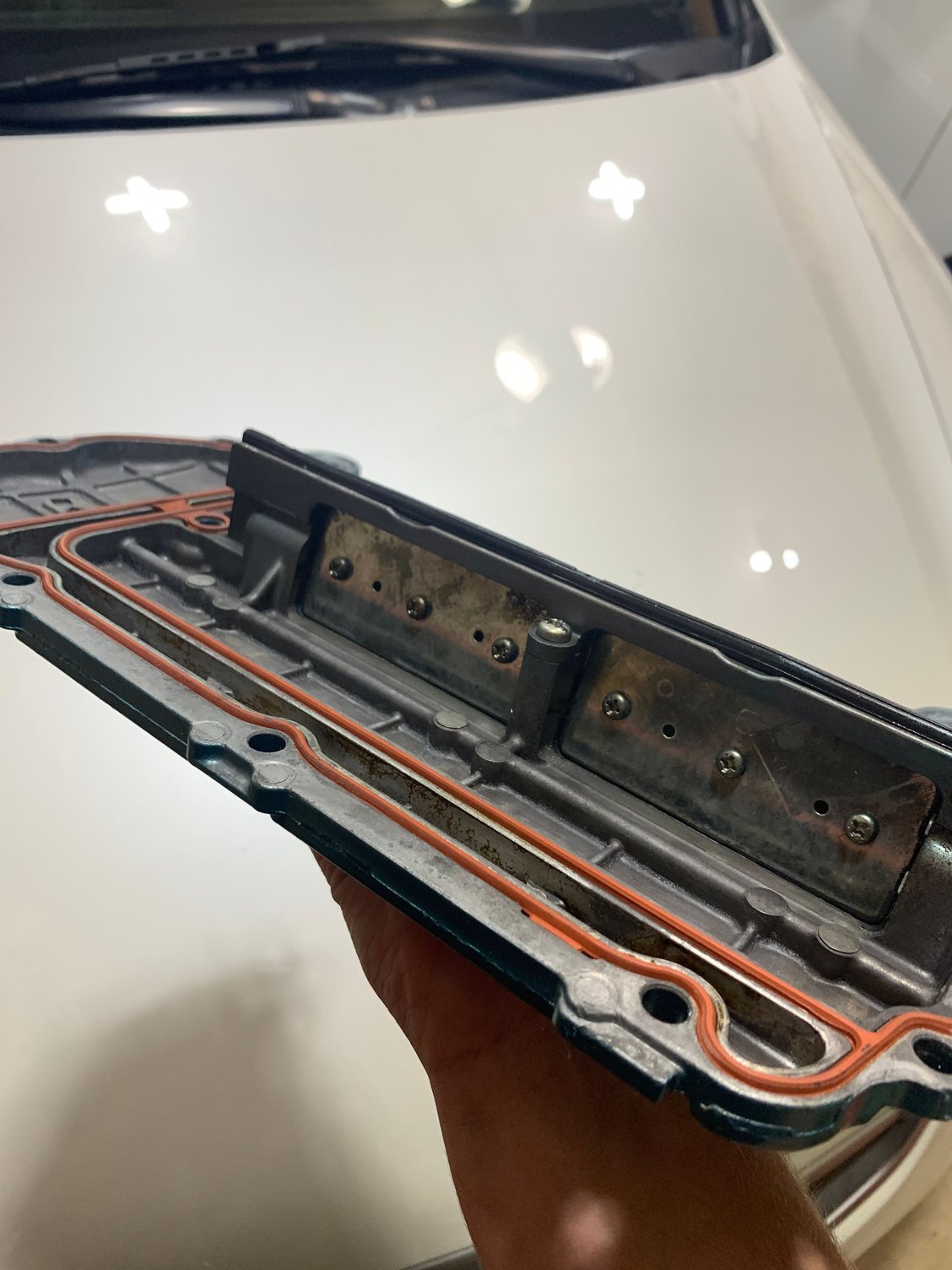

Bought a 2007 Type-S recently, and it runs poorly. I'm replacing a few things to try to make it run better, but right now I am going to adjust the valves. I had a question about the butterfly flaps in the upper intake. Should they be closed completely when not activated? Mine have a gap, which hopefully shows up in the pictures.

Sorry I don't have the answer but does anyone have a part number for that little gasket thing I guess it would be on the bottom where it sits down in the manifold?
https://www.oemacuraparts.com/v-2008...ntake-manifold

oh thanks never even saw that I already ordered the manifold gasket kit and was hoping it would come with but didn't

But to OP, I BELIEVE it should be closed when the engine is off.. I took mine off to do a valve adjustment this weekend and i believe it was closed as well.

yep it's supposed to be closed jsut went and checked my extra type s manifold

Thanks all. I'll have to investigate why it's not closing..
