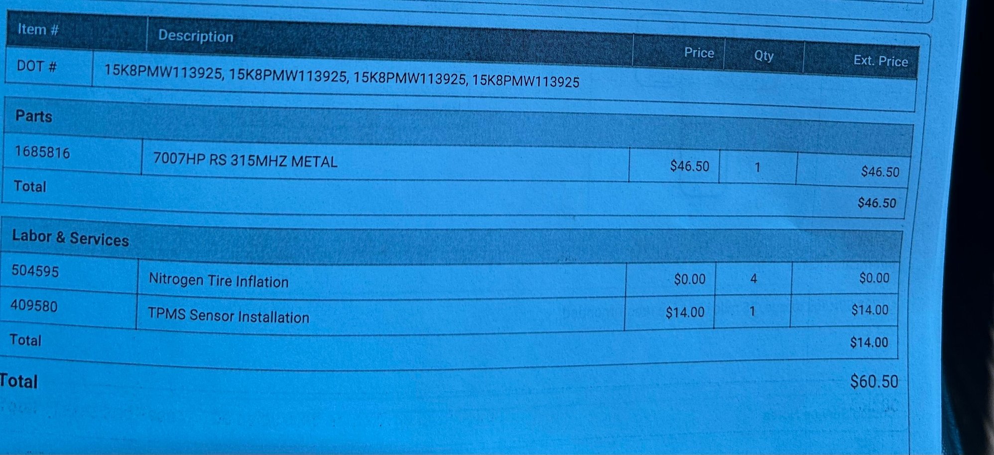

Good news
front passenger TPMs dead
$60 at Costco

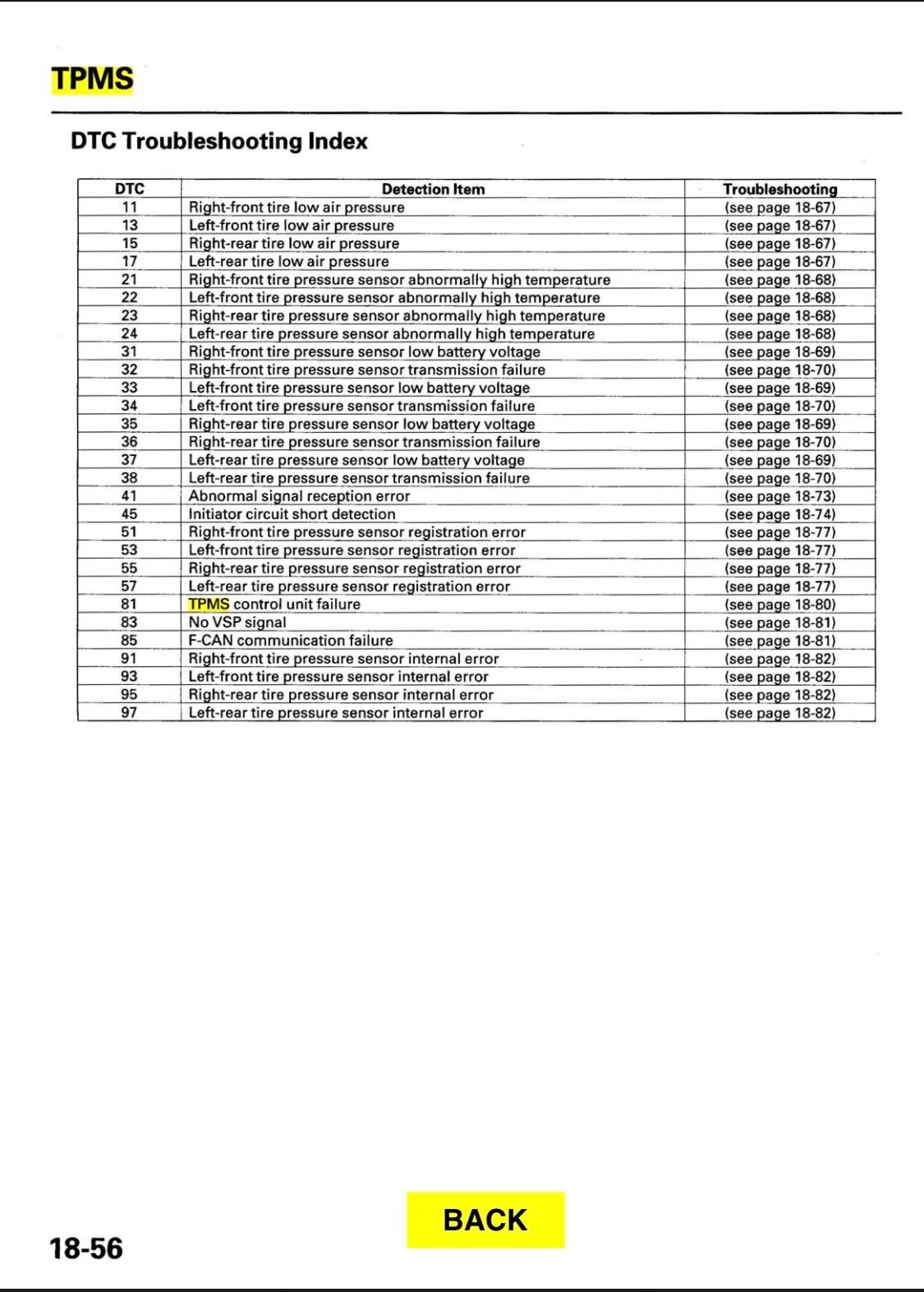

FYI:
DTC for TPMS related issues
