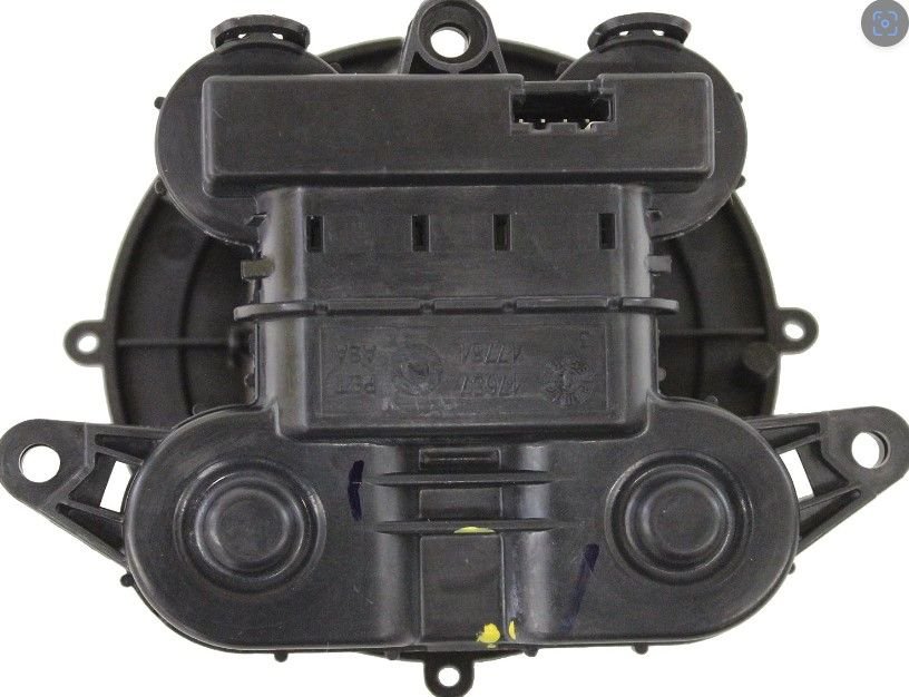

If it is faulty, you can try; however, I don't think it will do much since it appears the actuator, where the electric adjustment mechanics occur, is a self contained enclosure.

You can get a mirror actuator assembly and DIY or find a local independent Acura / Honda specialty shop to save $$$.
Amazon.com: Genuine Acura 76210-STX-H03 Side View Mirror Actuator Assembly : Automotive Amazon.com: Genuine Acura 76210-STX-H03 Side View Mirror Actuator Assembly : Automotive

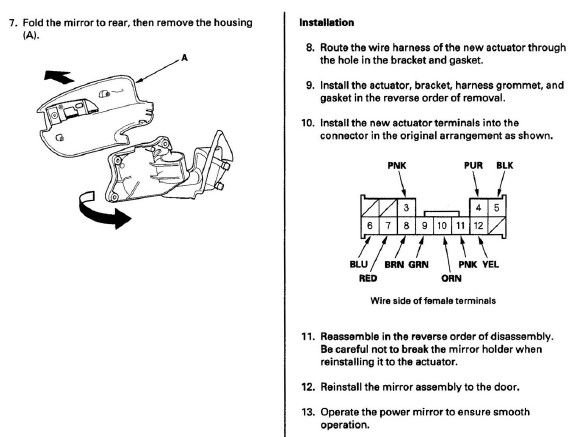

The below data from the service manual gives you an idea of what's involved:

No, you don't have to replace the entire mirror---there is an "actuator" inside the mirror housing that can be replaced.

Three things to note:
-The part number above replaces the original left/right parts.
-You only need to do step 5 from the service manual page above.
-Look up how to remove the mirror glass. It's a twist motion with a thin, long, cabinet flathead screwdriver. Do not pry!
