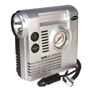

you know those are cheapie gauges... like the one in the photo was what like $2 or something
then the compressor gauge, they never get decent gauges, especially those tiny compressors (assuming the one that you can toss in the trunk, and runs off of 12v/cigarette lighter)

in this case I'm not off by 0.5 PSI but by 10 PSI. I don't think it matters which device I use as long as it's accurate, and as I said, that will be determined tomorrow.
No sense in trashing a cheap device until proven wrong.
my money is on the el cheapo device.
here's the 2nd device, I think this one uses electro something...maybe
