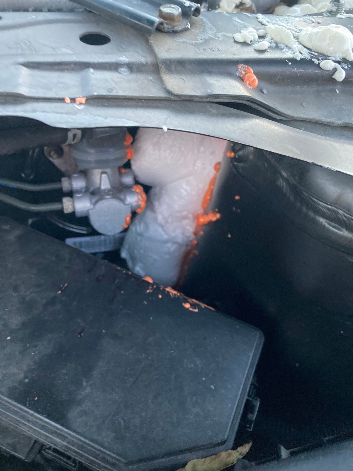

Update on this. Happened again. I decided to run water down the windshield drain on the driver's side. Full bore garden hose. Looked by the fuse box under the driver's panel. There was a bit of water. Looks like I need to open the wheel well and patch a hole or two. Will update on the progress.

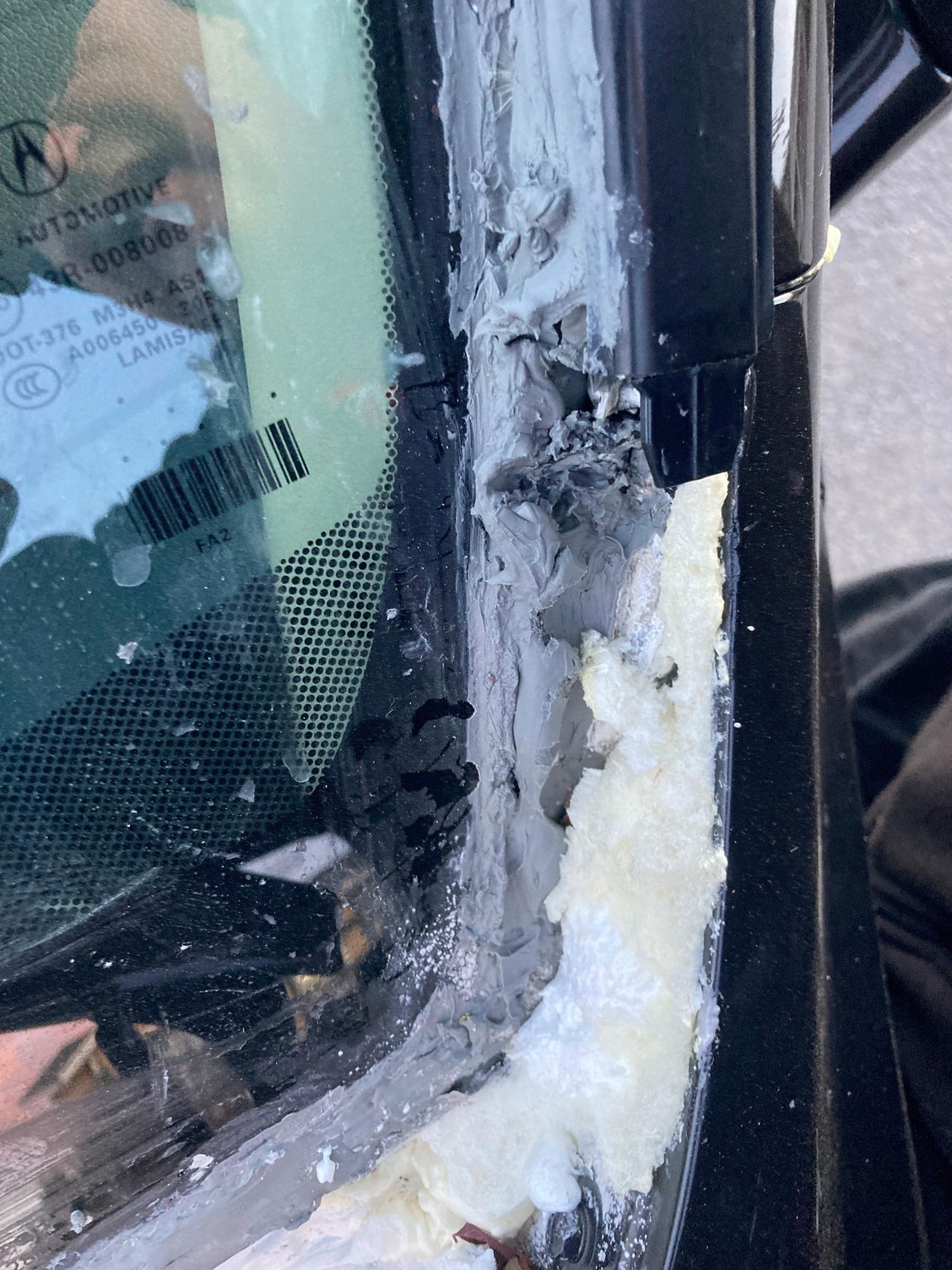

Spray Foam Insulation
There are two hotspots for this issue. One is on the side of the driver's windshield. The water runs down into the cabin in the spaces. Also on the firewall there is a cluster of wires running into the cabin. I sprayed both these areas with spray foam insulation (any brand) and the leaks have stopped.

I bought it used a year ago. After five AAA tows and $700 at Acura with no luck, I just had to fix this somehow.
The windshield is likely stock since it says Acura and a replacement would likely be aftermarket, I.e. Safelight et al.
I took off the front fender and some trim pieces. There are literally diapers on some of the panels to absorb water. This implies Honda knew about this as a problem. Makes you wonder. Maybe the factory forgot a diaper on mine.

Glad you found the solution after all that man! Was the car in an accident my chance? I know you said you took off the fender and some pieces? Did you add the grey looking silicone around the windshield or was it like that because it doesn't look very factory. I wonder the diapers you mentioned could they be factory sound deadaning?
Old Dec 12, 2022 | 09:14 PM
ace777's Avatar
Joined: Dec 2021
Posts: 24
I don't know if it was in an accident, but this was not related to an accident or fender replacement.
The issue was simply water leaking in mostly from the side where you see the grey silicone. I know it doesn't look pretty, but I had to isolate all the cracks. It cleans off easily.
One of the diapers/pads is on the rear of the left side panel by your left foot where the hood release and gas release are. It is not thick enough for sound deadening in my opinion.
