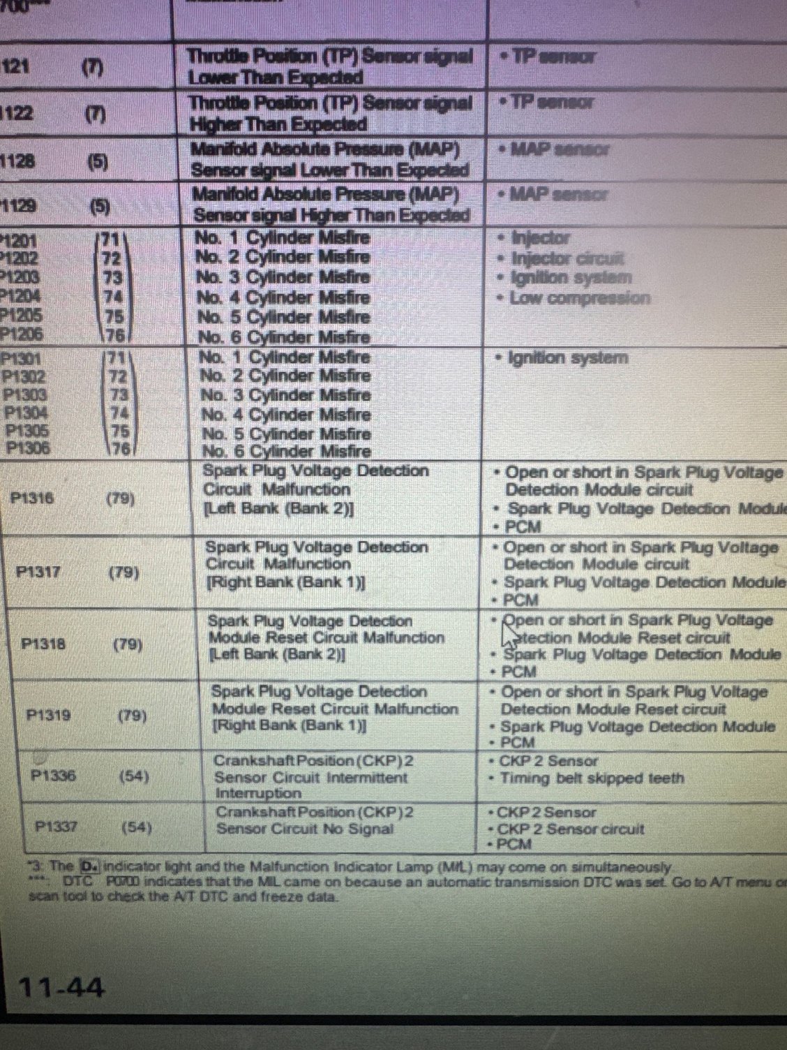

Okay, I finally got some time I'm running the car until misfire to check fuel trims and I keep getting a new code PRIOR TO THE MISFIRE. P1316-1317. Reading through charm.li it's saying to check the spark plug voltage unit, is that the same as the ignition control module, I can't find any reference of a SPVU anywhere other than that page.

Switch them around and you got it. My bad. Also here is the DTC guide

Okay, so next is check the wiring, and with your dtc chart, is it saying there's a second spark detect for the other bank? Or do all run through that module/there's an RL at a junk yard here '02 as well, should I just run and grab the modules to have before they cube it to be safe?
