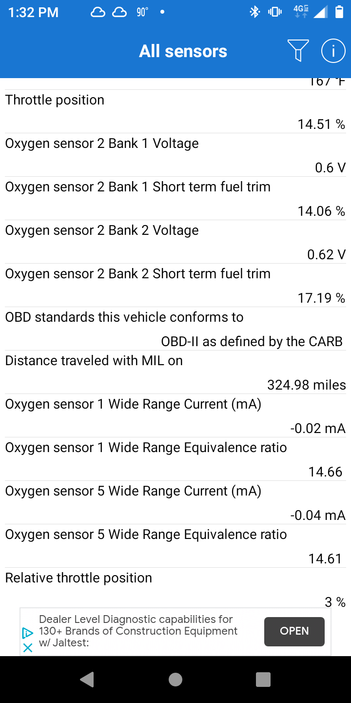

Just took these at idle pending po174 just showed up this morning. Car still running fine. Checked for vacuum leaks found none.

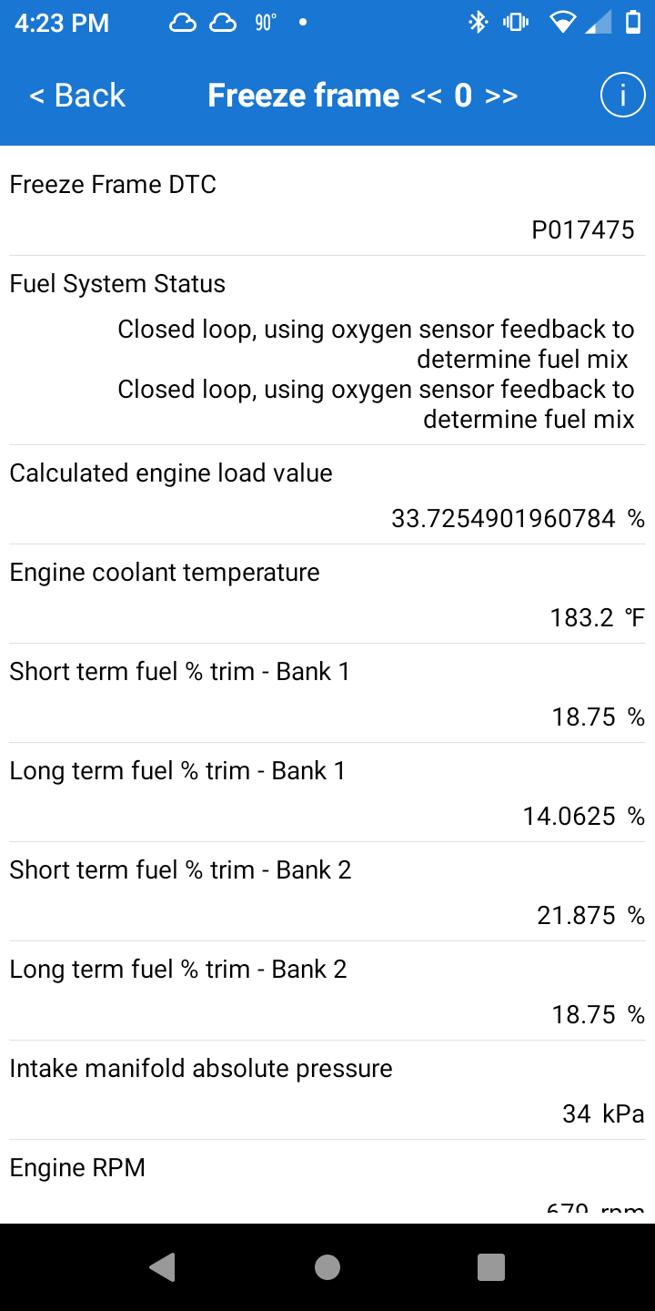

P0174 confirmed. Here are freeze frames for it.

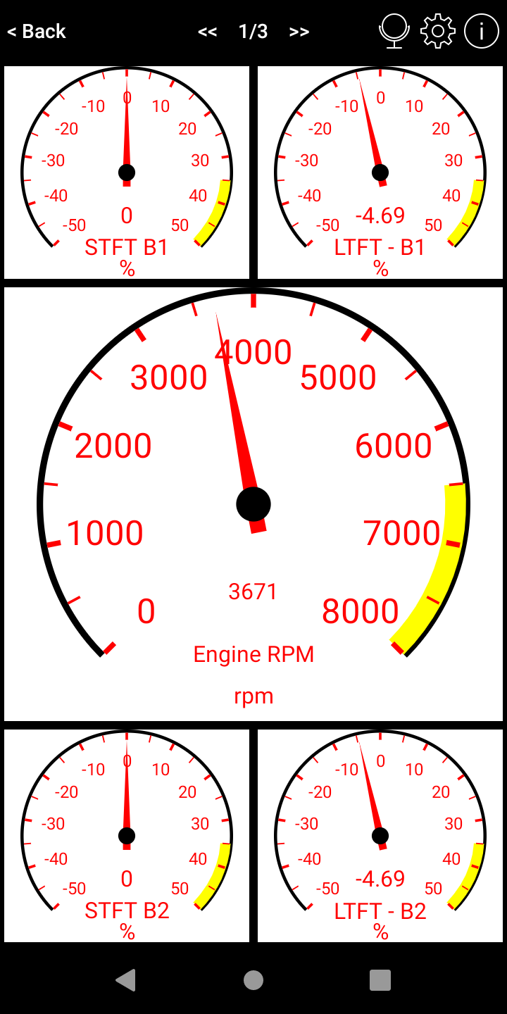

Here are some screenshots I took randomly this morning at different speed, rpm probably load like pulling a hill or just cruising. Only difference from the earlier ones is the gas cap is off.

Here are a couple more on a trip to Atlanta and back this morning ltft fuel trims are perfect it takes it awhile to really relearn everything.

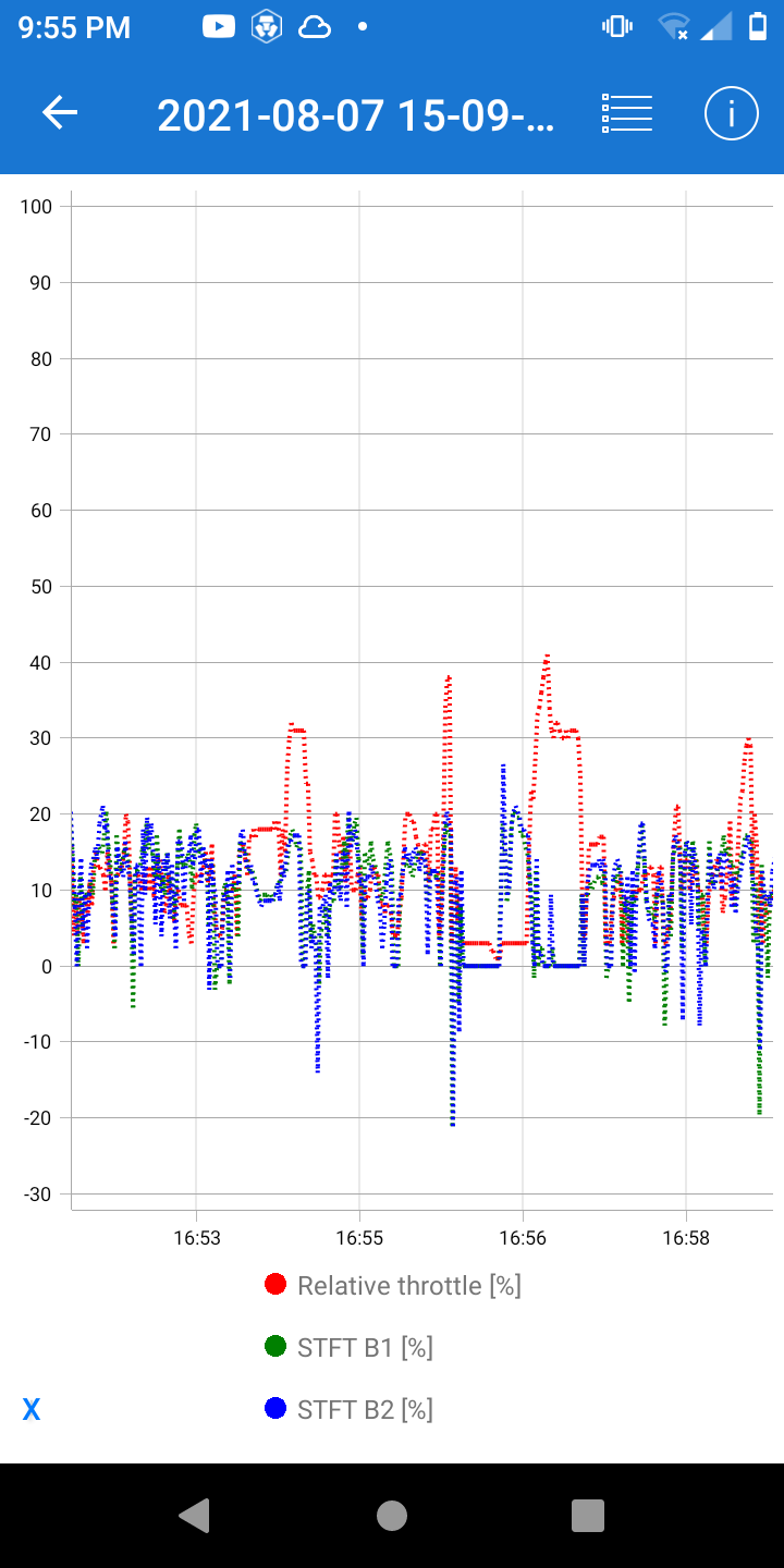

That pic was probably took during a throttle blip definitely not running lean. When you blip the throttle just a little stft will jump then settle back down. You can think what u want I could go get another pic after holding throttle steady and stft will be barley anything. Car is getting 28 mpg on the freeway about 24 in town. I'll get you another pic if u want here's one at idle from this morning. Stft is very sensitive to blips if I stomp it it's going to go to zero it fluctuates depending on load. If you let completely off it's going to zero out. Remember I'm driving down the rd screenshoting so holding my foot steady isn't exactly easy. If the car was dumping fuel the long term trim would be high.

Fuel trims over a hour and a half both short and long term earlier today

Same trip as above zoomed in look at the tp and the stft they mirror each other.

Here's another zoom shot. If you think I'm wrong please tell me your train of thought on what's going on here. There's no denying the original lean condition is gone just compare the fuel trims in the freeze frame to the current ones the difference is not comparable. I'm always open to suggestions.

If there was a lean condition when u see those peaks at full throttle the stft would sky rocket because the demand for fuel would go up, instead you see the stft go to zero because your bypassing your 02 sensor's at that throttle position basically in open loop. My way of thinking is basically your 02sensors are constantly making fine trim adjustments in your stft while at cruising speeds taking your mixture from lean to rich. Maybe I'm wrong but that's my take on it.

They were the same with the stock air box no difference. How do u explain the negative ltfts? How do u explain the difference when the cap was removed no codes present since no driving issues . If you don't see the difference in the freeze frame and now then something is definitely wrong. Fuel mileage is perfect. I'm not saying I disagree with the fact the stft is bouncing but I do disagree that it's lean because the ltft is showing opposite of that and I put more faith in lt then short. The filter made no difference in the charts I may have one from before I put it on I would have to look.
