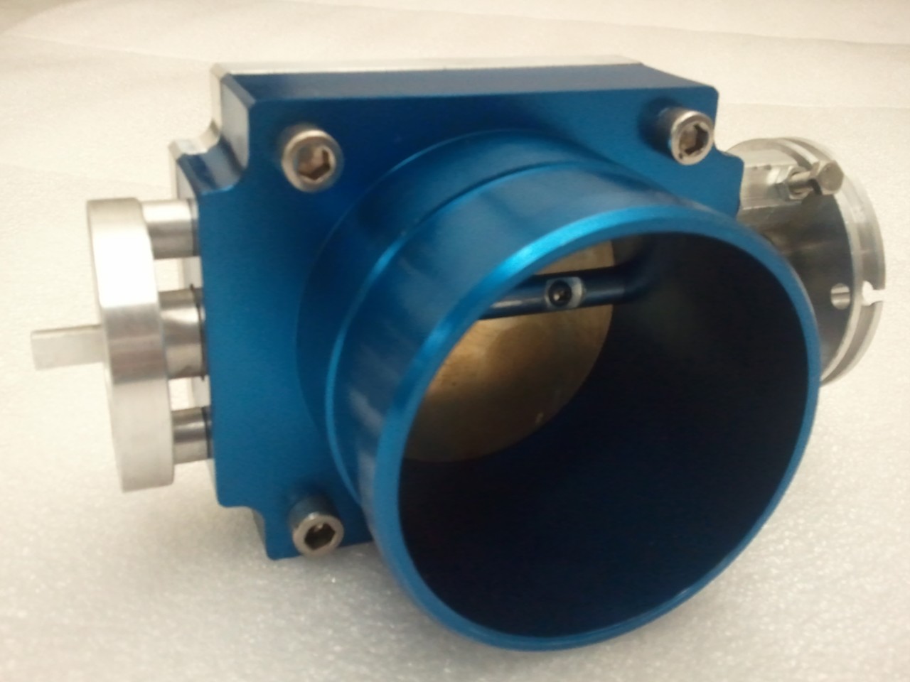

Cams fit no problem.
Only thing spacers are for are to sit the pulleys further out to line up the belts.
After using the spacers you will have to shim the cam shaft sensors to clear the cam gears.
To elaborate on what civic said
You can keep CC but,you would run the risk of ruining the TB if you made a mistake.
you would have to work the shaft to fit the pulleys.
You could also use the acura tps but,you would have to completely chop off the end of the shaft and start grinding into the thicker part to get the correct mounting height.
The universal TB swap is not for the adverage joe.
Best to go obx 76mm and only have to worry about remote mounting icav and a little porting to the neck of the manifold to open it up as much as you can.
Also if your planning on running the mdx spacer and have to milled it in half you might as well just get longer manifolds horns it will do the same thing without the appearence of the high rise manifold.

The TPS must be an issue with the TB you chose. Im running all Honda sensors on mine.
So the cams are just shorter than our stock cams? how did you safely space them? I think when I am turning 7,000 rpms I would like to be sure everything is solid. That is why I am trying to re-use as many stock components as I can... power meeting reliability.
Yeah I can not see there being a reason for changing sensors. A lot of Honda TBs are designed for the same things, such as TPS or IACV. On my old Accord I ran a bored Prelude TB, completely different design, but all the stock sensors were retained. Just their locations changed. I had to rotate the TPS to the correct degree to make sure it read zero throttle when the plate was shut but that was the only "modification" it required.
I might just have a stock one bored for now. 70mm is better than nothing. At least I will know that the airflow and Exhaust flow will be my weakest points when the build is finished, and I will have areas to push further next year...

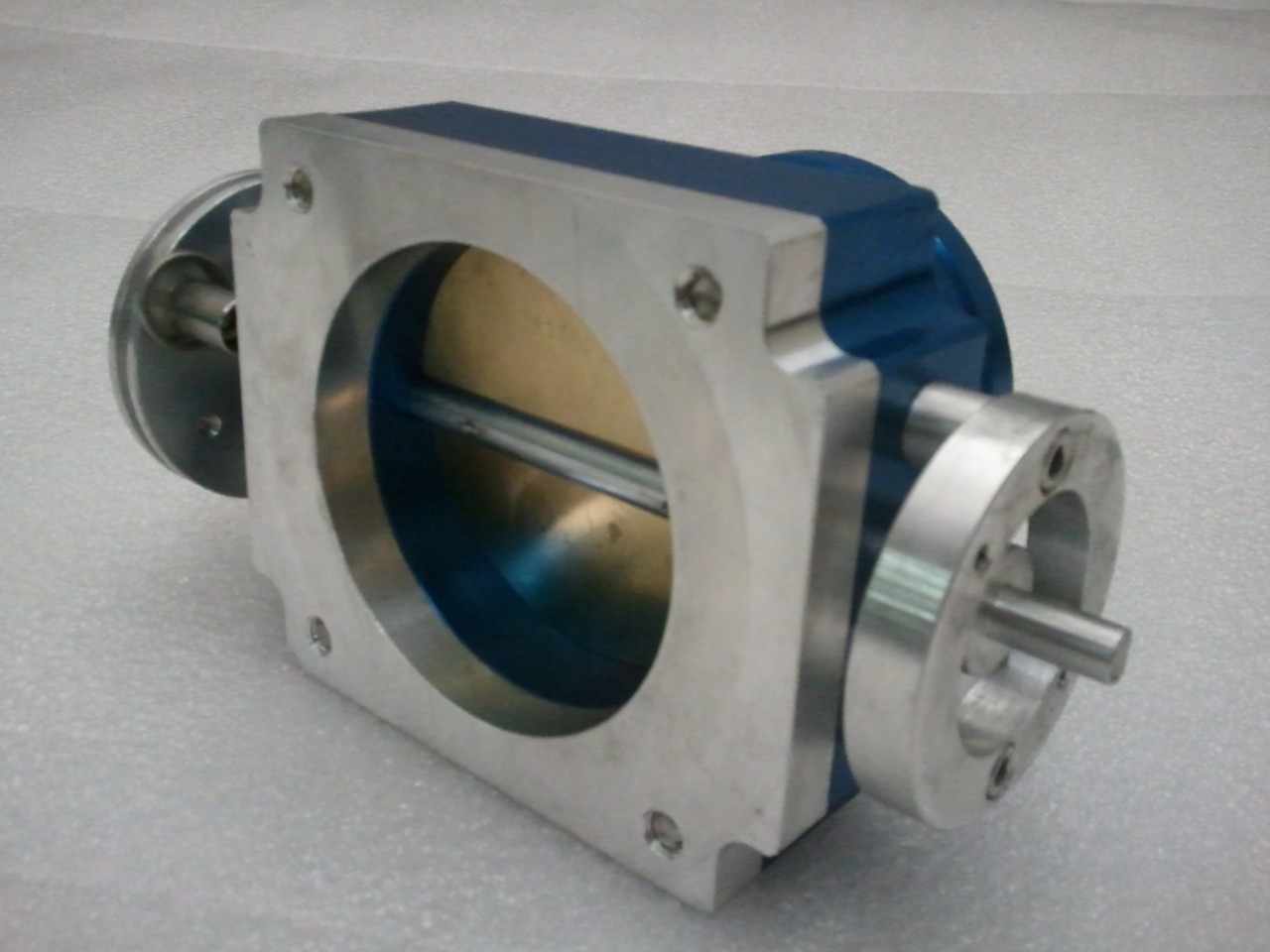

Yeah I can not see there being a reason for changing sensors. year...
measuring the cams to get lenths.
Also a few minutes to grind the shaft for the q45 tps or
A hour or 2 to get the lenth of the shaft cut right to get the oem key to fit that will turn the oem tps.
I don't know what I'm talking about
Pieces dissesembled from my oem TB
Some one else's pics so you can see where it goes.
The aftermarket shaft where it needs to go.
The shaft needs to be chopped off.
Then you need to grind into the thicker part of the shaft to be able to bring the sensor down to the mount.
And you will also have to knotch that shaft for the back side of the key so it will turn without slipping.
And finnally drill and tap once centered.
So why go threw the extra work to use a oem sensor when they read the same voltage ?
Because it was as simple as adding an extension collar and mounting the OEM sensor
So your tps key is screwed right to the shaft ?
Then you added a big block to mount the tps to ?
It was part of the shaft.
