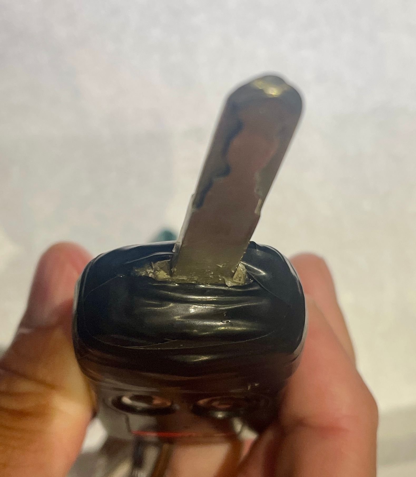

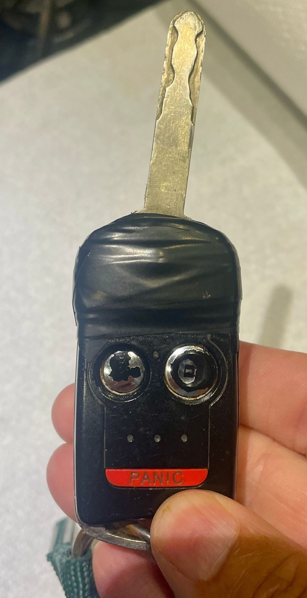

Old Sep 3, 2024 | 07:19 AM
Owenwest1's Avatar
8th Gear
Joined: Jul 2024
Posts: 8
Same thing happened to me. I would not necessarily recommend this but, for the moment, everything works and car starts. When mine broke I used plastic glue to place the key in place and fill the gap around it at the top of the fob. Then I wrapped electrical tape around as tight as possible (I don’t care if it folds, I just want the key to work). I assume if you got glue elsewhere in the fob you would have problems. For the moment everything works but I’ll be investigating if I can transfer everything to a new case.
