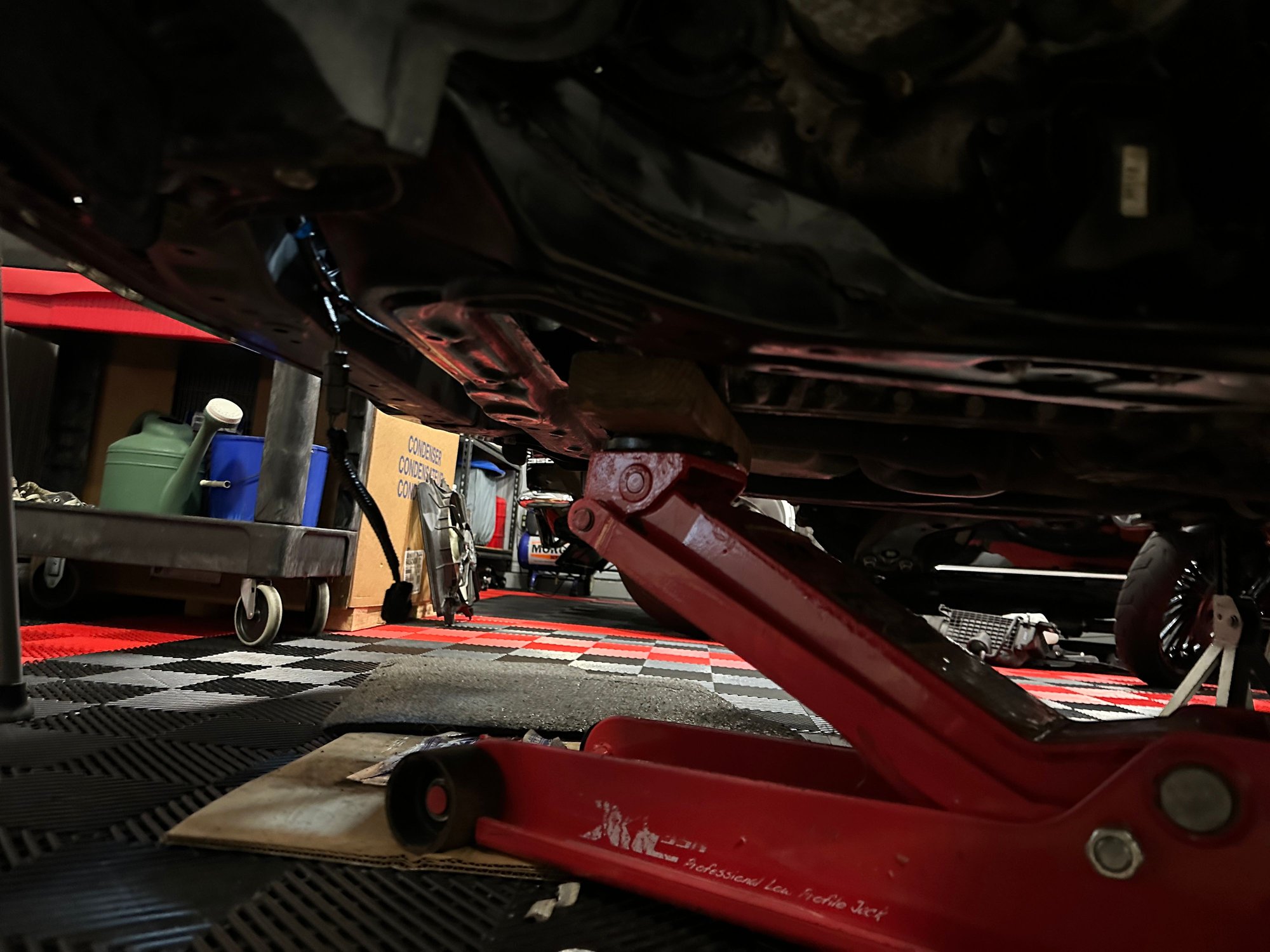

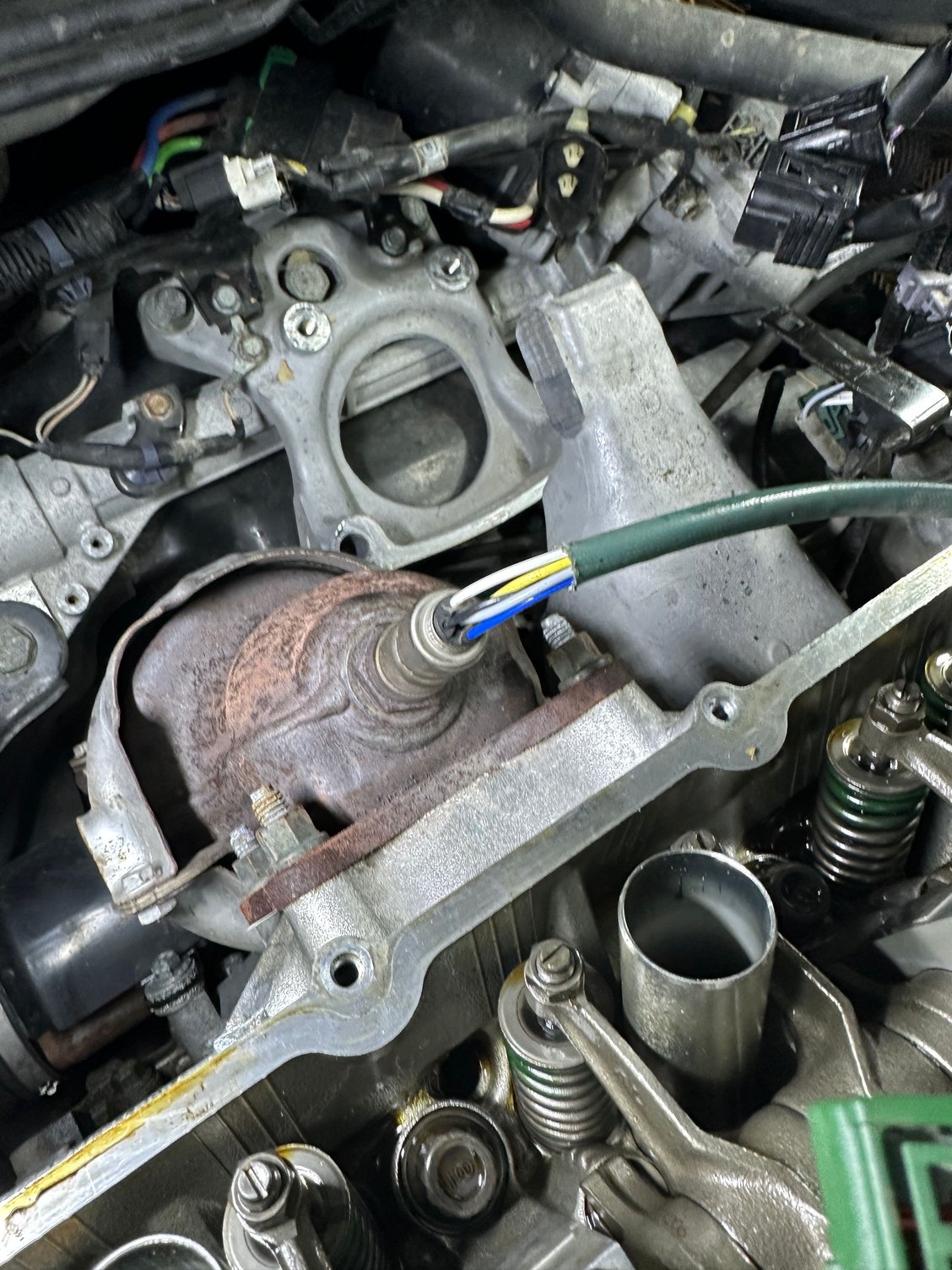

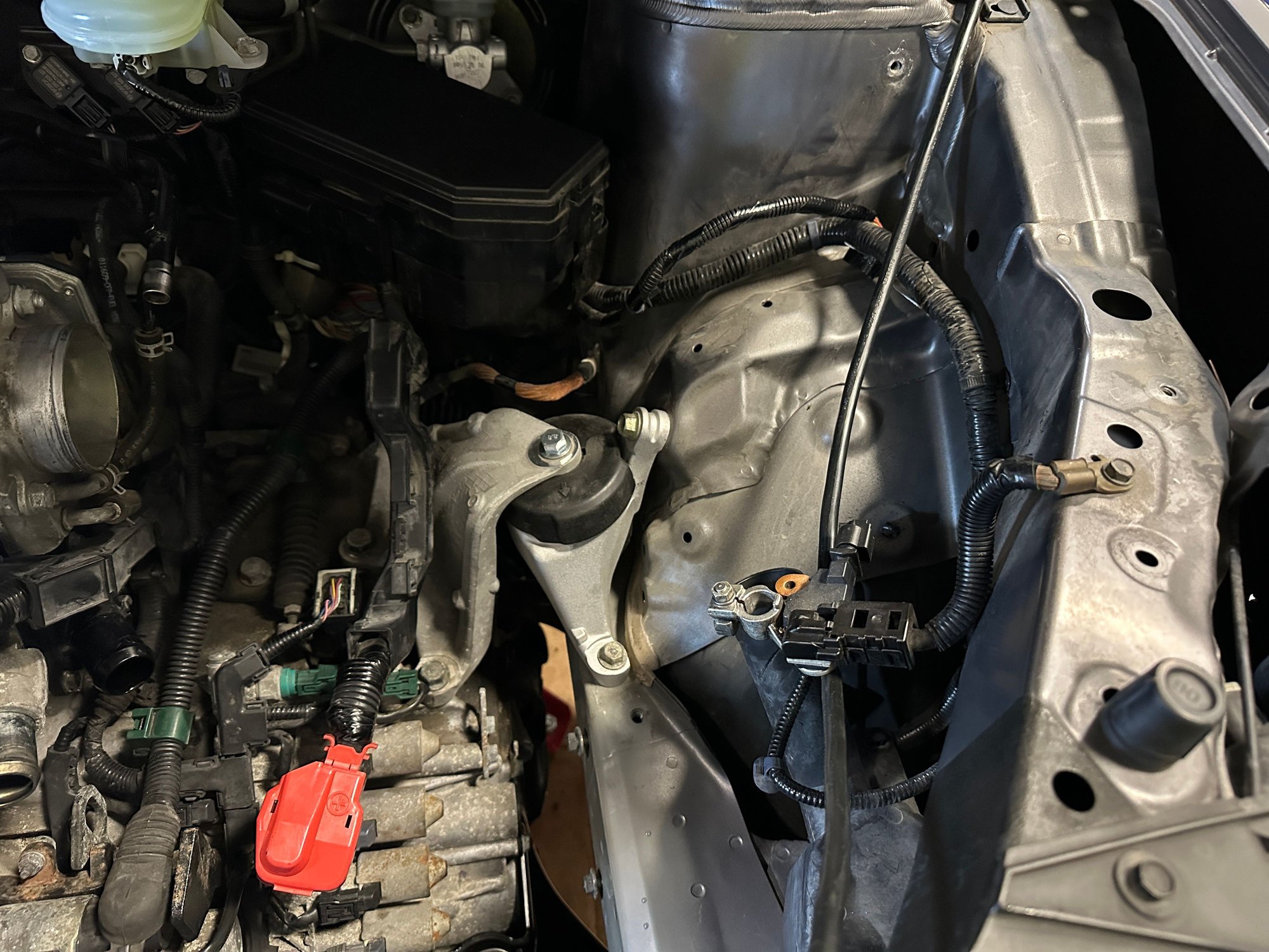

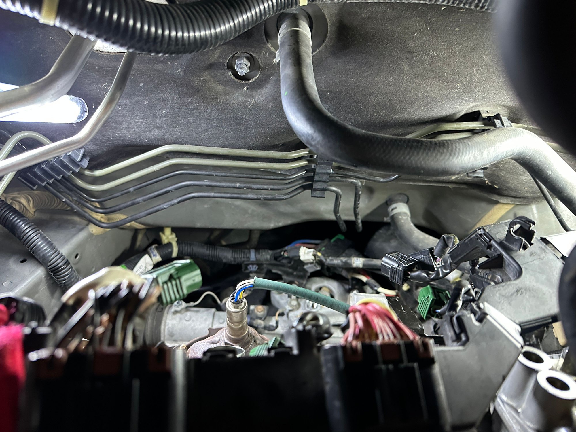

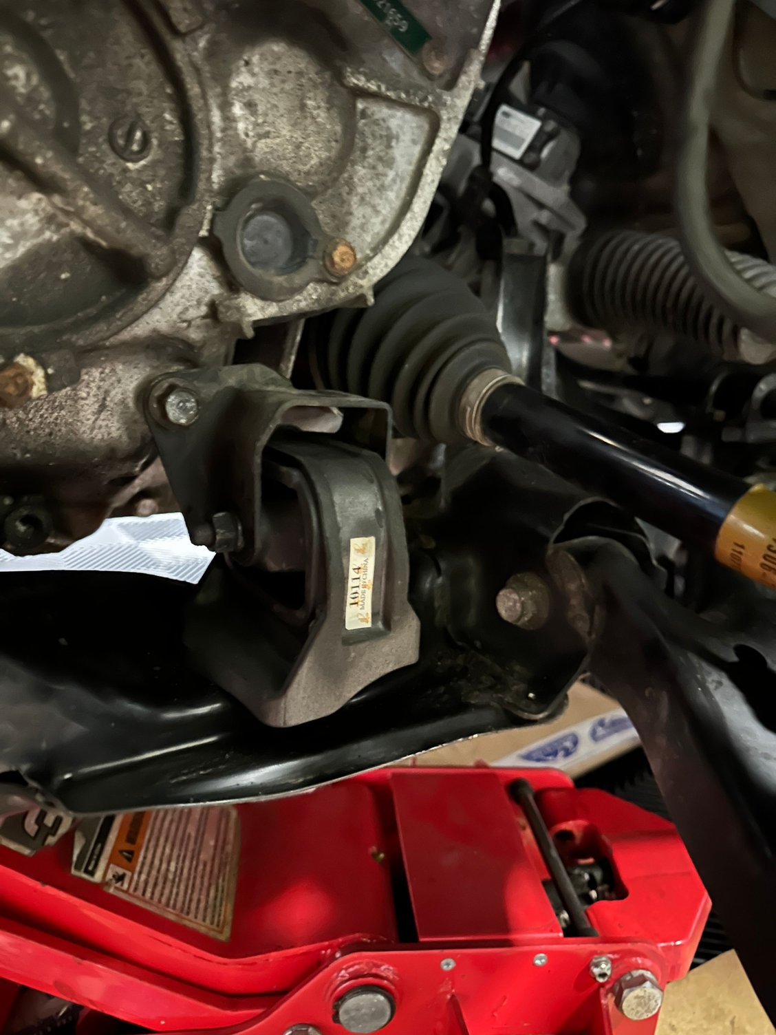

Going all in. Replacing all five engine/tranny mounts. We'll see if this fixes the bang going into Drive. I know it did on a CR-V we had in the family.
It was pretty slim pickings for DIY help unless I just did not locate it in this forum.
Transmission Upper: Easy - under the air box
Transmission Lower: Easy - Take off the driver's side wheel and replace it through the wheel well

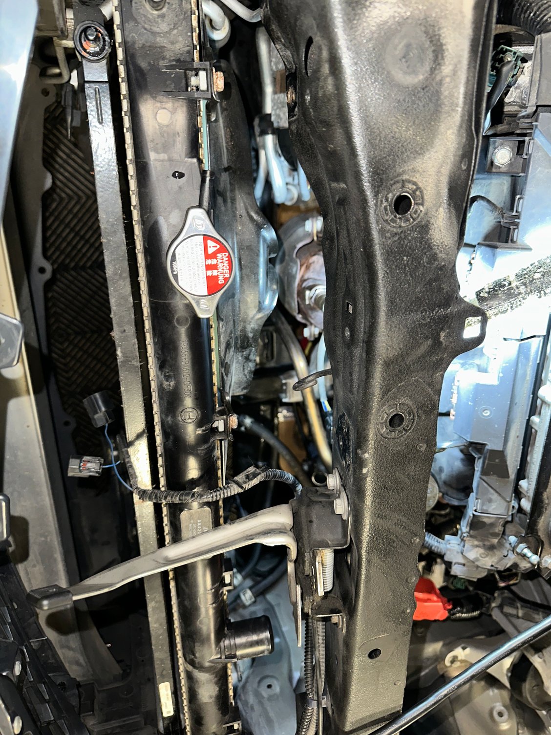

Engine Front: Mildly Challenging - get the radiator loose, hoses off, battery tray out, driver's side cooling fan out. Radiator gets bungee'd towards the bumper and the mount comes out the top between engine & core support
Engine Rear: Suck Balls Task - do this when you are adjusting your valves. It comes out the top between the engine and firewall. All work is done topside. There is room to work once the rear valve cover is off and the harness is mostly disconnected
Engine Passenger Side: Easy - do this in conjunction with the timing belt job

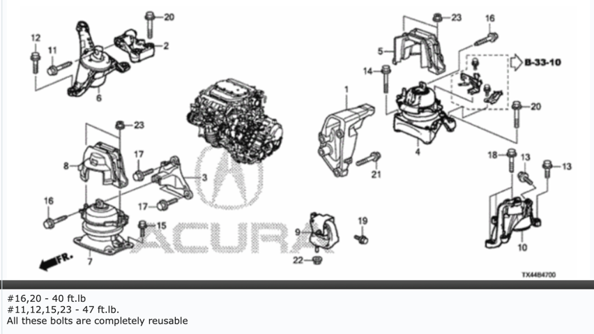

Here's some photos to help:
General Torque values for mounts...

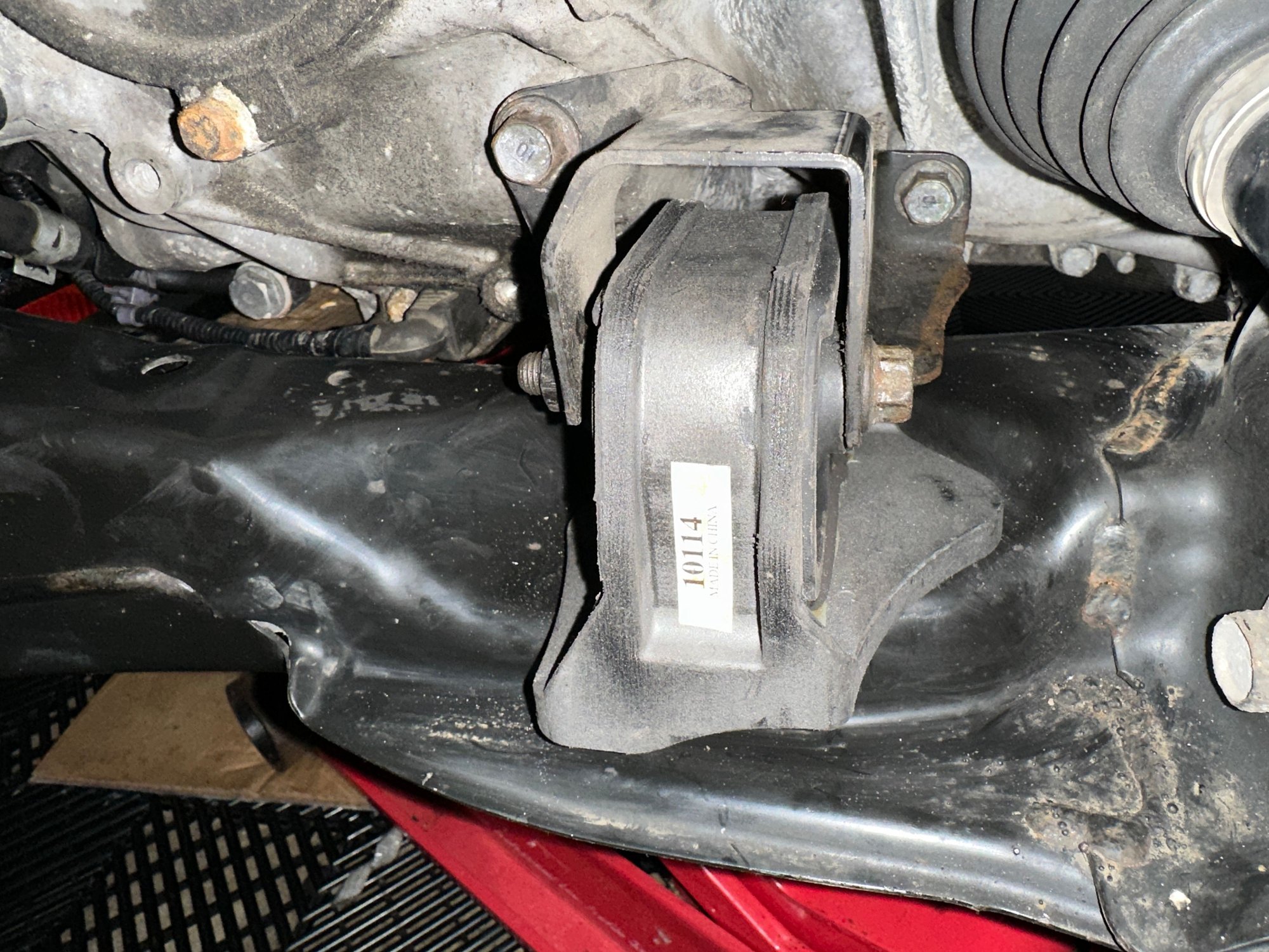

Tranny Lower Mount
Tranny Lower Mount
Tranny Lower Mount II

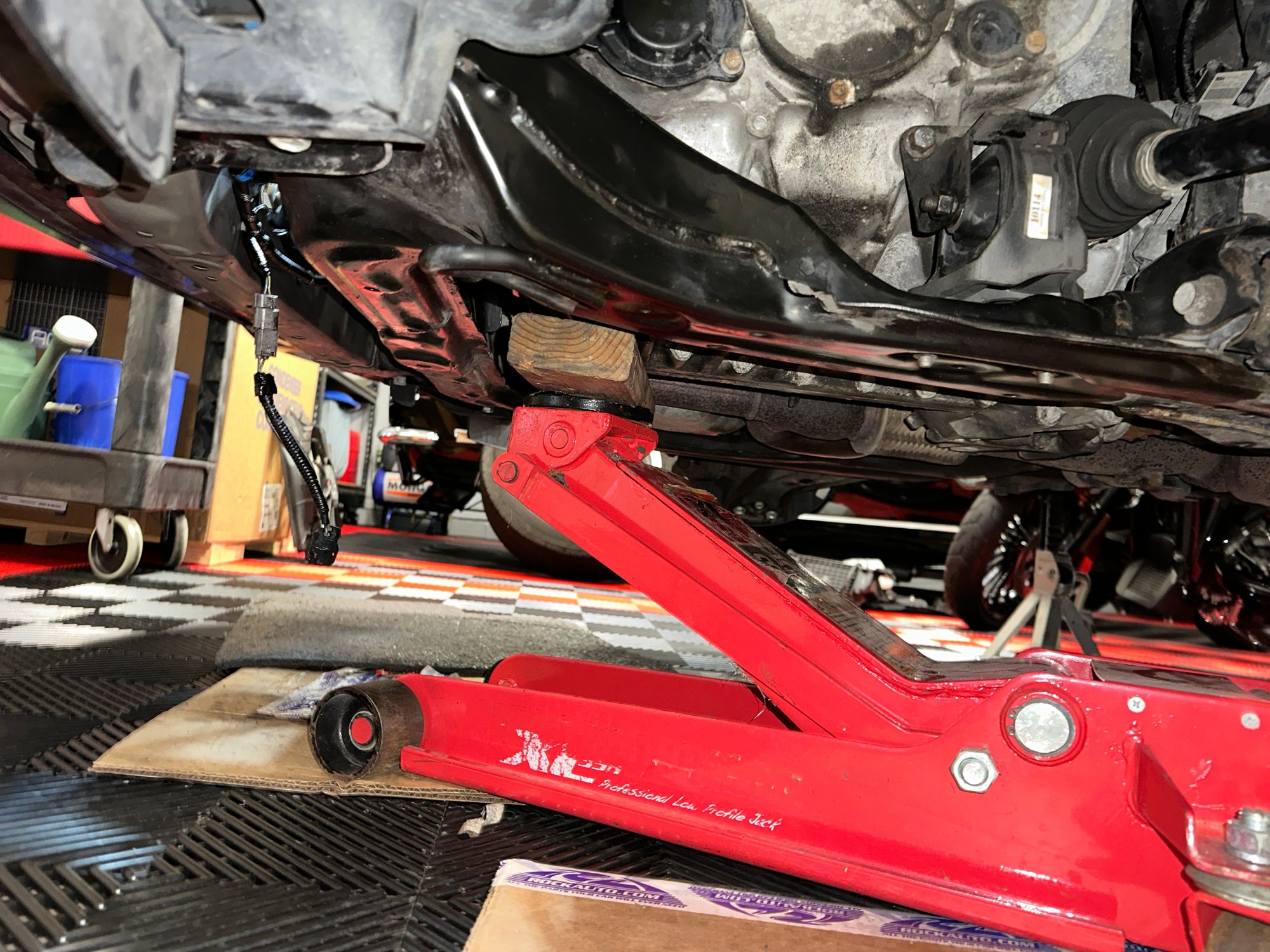

Supporting Engine
Supporting Engine
Supporting Engine II
Supporting Engine III
Radiator Coaxed out of the Way

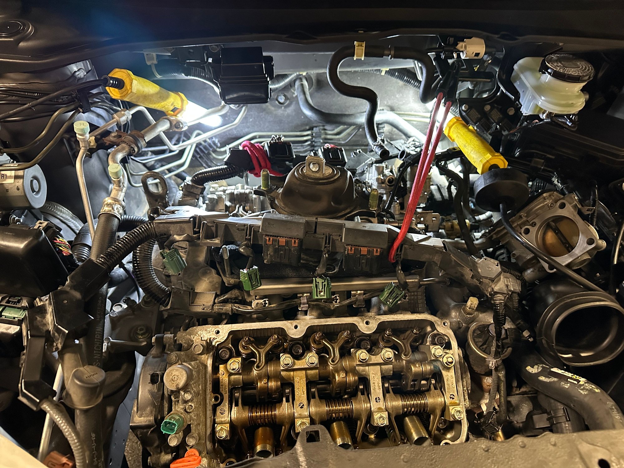

Valves adjusted. Still need to do the Timing Belt & Water Pump.

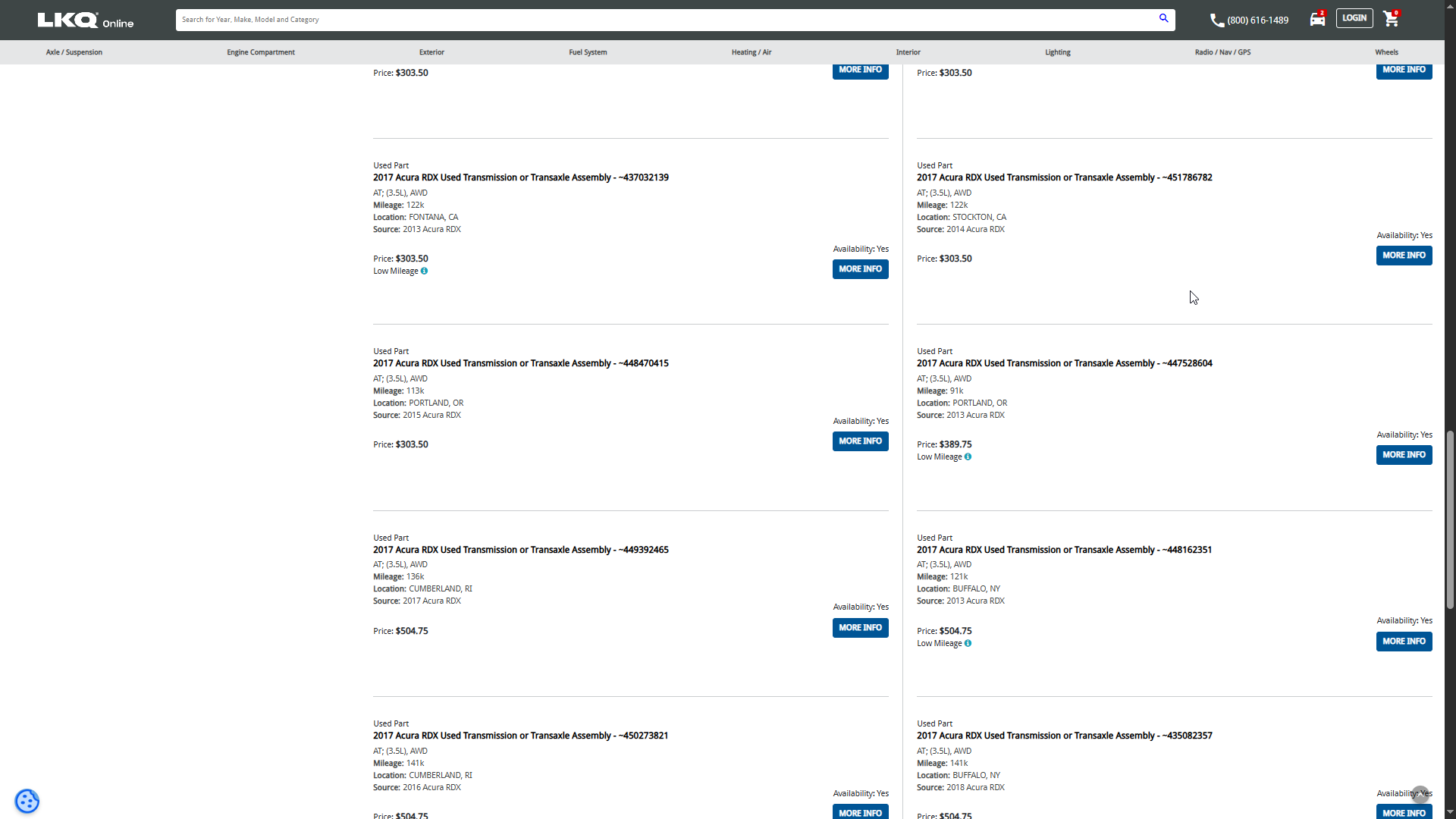

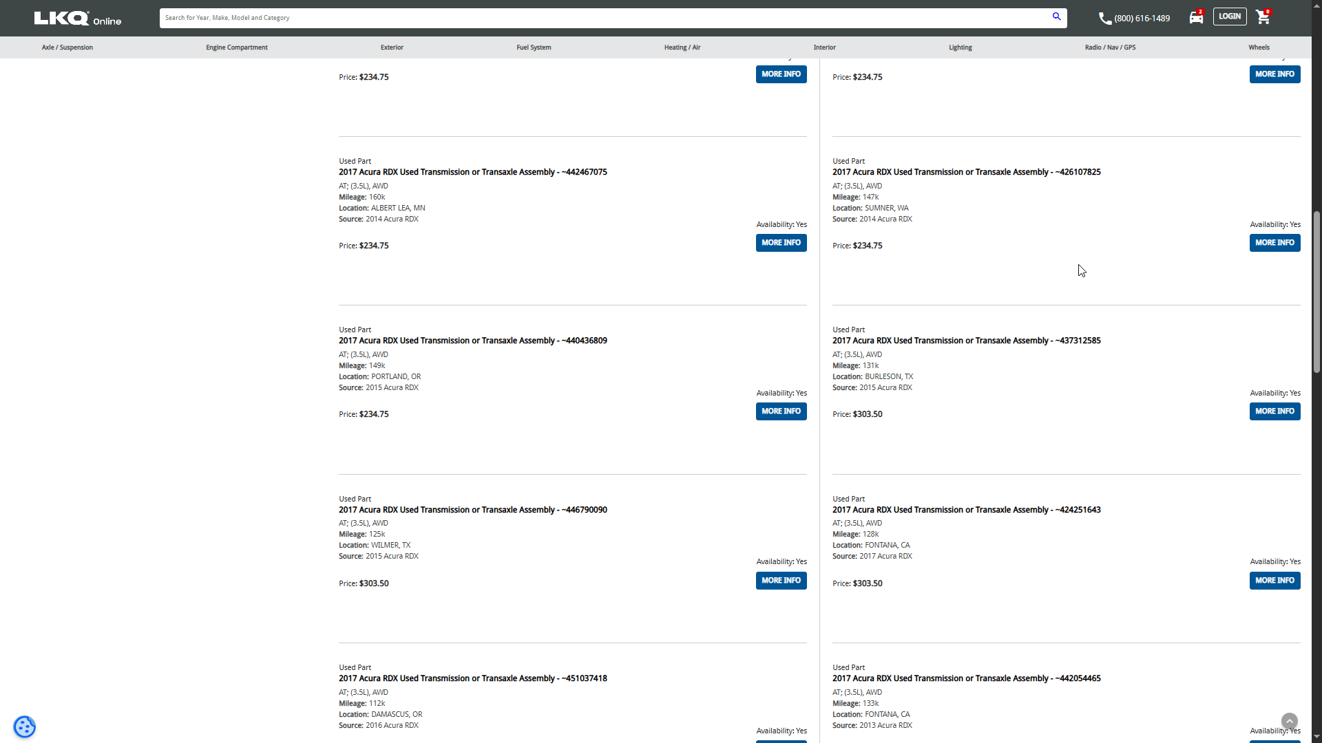

Luckily, these transmissions don't cost anything.
Old Mar 29, 2026 | 11:04 PM
Alex Medeiros's Avatar
alexmed2002
Joined: Oct 2020
Posts: 682
Likes: 196
From: Massachusetts
Yep they're on the very low end in terms of cost for replacements!
