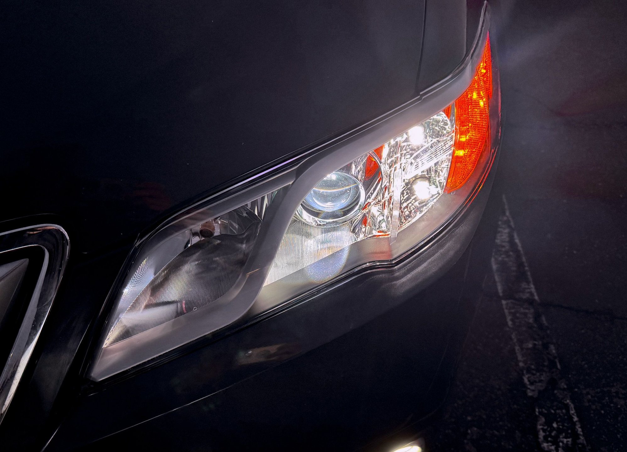

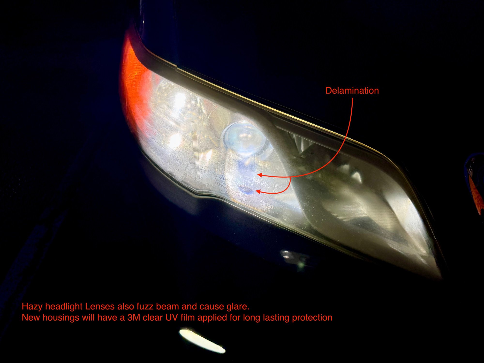

The Nuclear Option (BiLED Retrofit)
Howdy y'all, been a cool minute since I've popped back on this forum, but figured this was a good time and reason as any.
I too, have lived with the slow-degrading performance of my factory 2015 Tech's delaminated HID headlights. While I was initially considering getting a new set of OE headlights, I quickly realized that the cost of a new set of 2015 OE housings was essentially the same as getting a proper retrofitted unit. So that's what I did.
I contacted VisionAutoworks out of Texas to have a set of 2G Retrofit Headlights made. They use OE-style headlight assemblies from Eagle Eyes, and then drop in a 3" BiLED Projector from NHK (an M1 model from what I can figure). These things are an absolute weapon and torch the night; it's incredible.

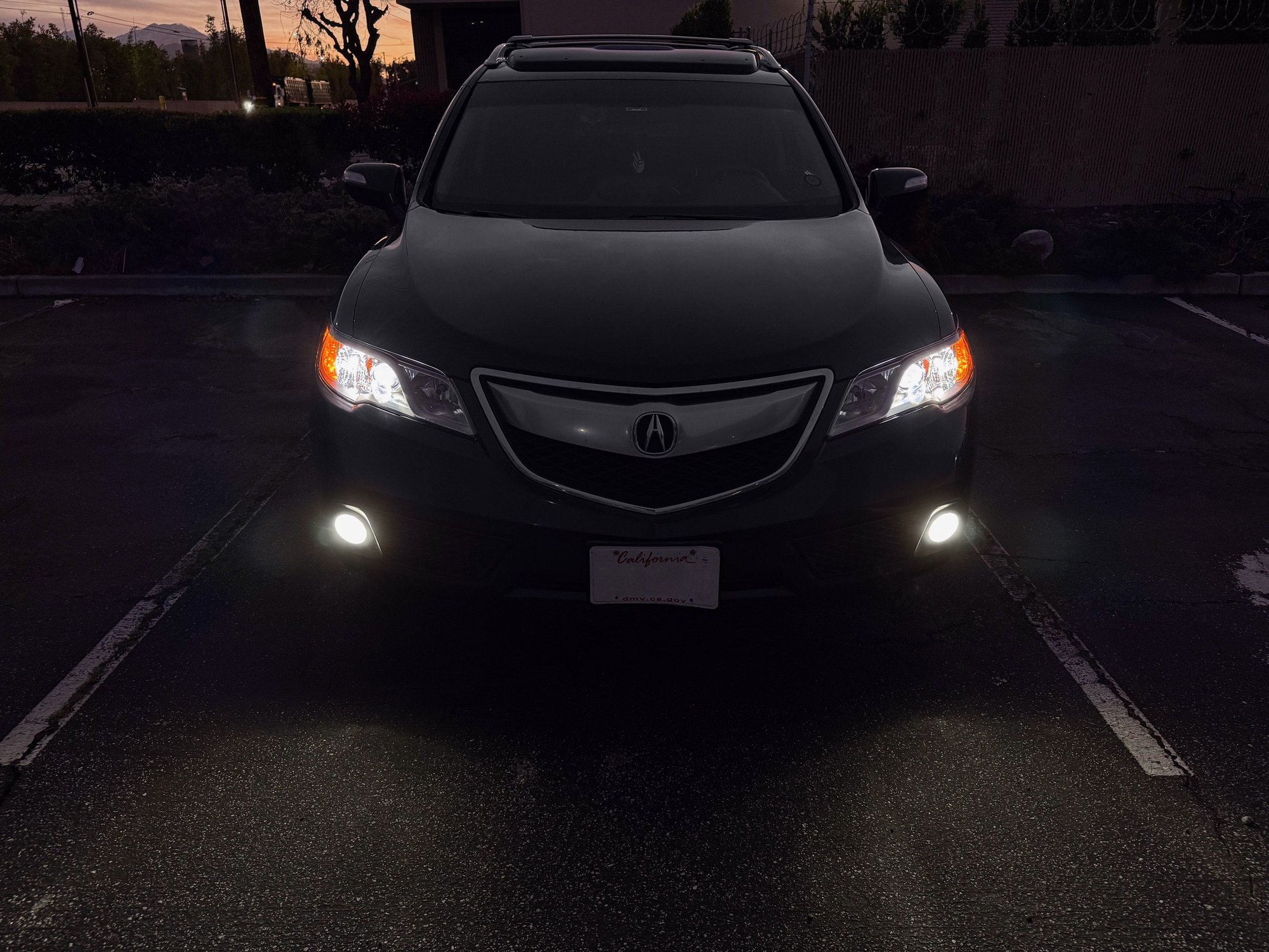

I've always been a diehard lighting fan for properly set up and performing lights. I used to have a set of Morimoto 3" D2S retrofitted projectors in my Civic running a set of Osram Night Breakers @ 55W, and these new BiLEDs blow past those both in terms of lighting output and color quality.
Each projector is about a 50W/55W low and high beam with an incredibly crisp neutral white with a high CRI and around 5700K to my eyes with perfect beam control. They fully seal up the headlights so all the wiring is internal, no drivers hanging out, and no chance for dust or moisture to enter through the rear, it's straight plug and play.
The BiLEDs are controlled through a Y-Adapter on the highbeam plug, allowing for the projectors to open up.
I swapped in a set of Diode Dynamic SL2 Pros into the 9005 Highbeams, and was able to rotate the mounting collar on the bulbs to match the awkward 45° offset each of the high beam sockets have.
Through the Y-Adapter, the SL2 Pros provide a flicker-free DRL mode with pure white light, and light up to full brightness when pulling the headlight stock back when using the highbeams to flash/signal.
Everything just works, and its incrediable. As for the Eagle Eye housings, I've used this brand in the past when I did my own retrofits for customers. They are a solid brand and US importer of various overseas headlights typicaly from Taiwan, and I've never had a problem with their quality and durability. And for those who are worried, VisionAutoworks can do a clear ceramic coating on the lenses, or 3M clear UV protection film, which is what I did.

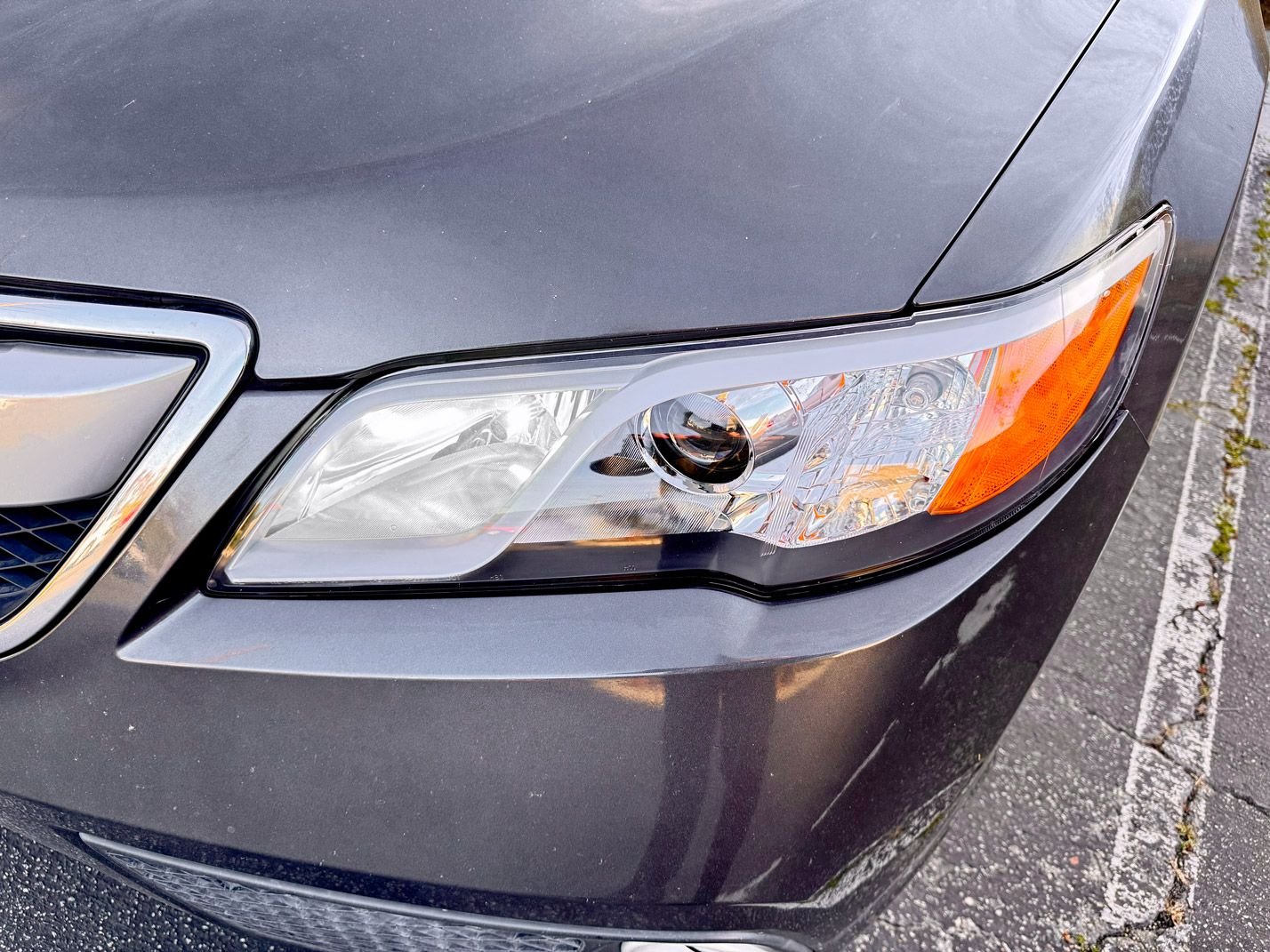

Stock HID Housings with Osram CBB D2S bulbs+ GTR i-LED 7443 Switchbacks

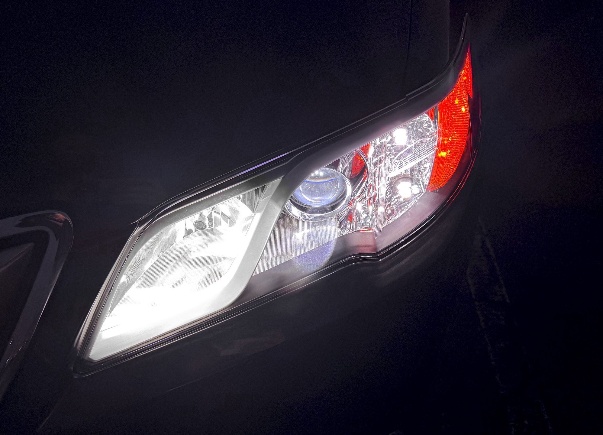

VisionAutoworks NHK BiLED Retrofit Headlight (low beam)+ GTR i-LED 7443 Switchbacks
VisionAutoworks NHK BiLED Retrofit Headlight (high beam + Diode Dynamics SL2 Pro 9005)+ GTR i-LED 7443 Switchbacks
Alright, now onto the output photos!

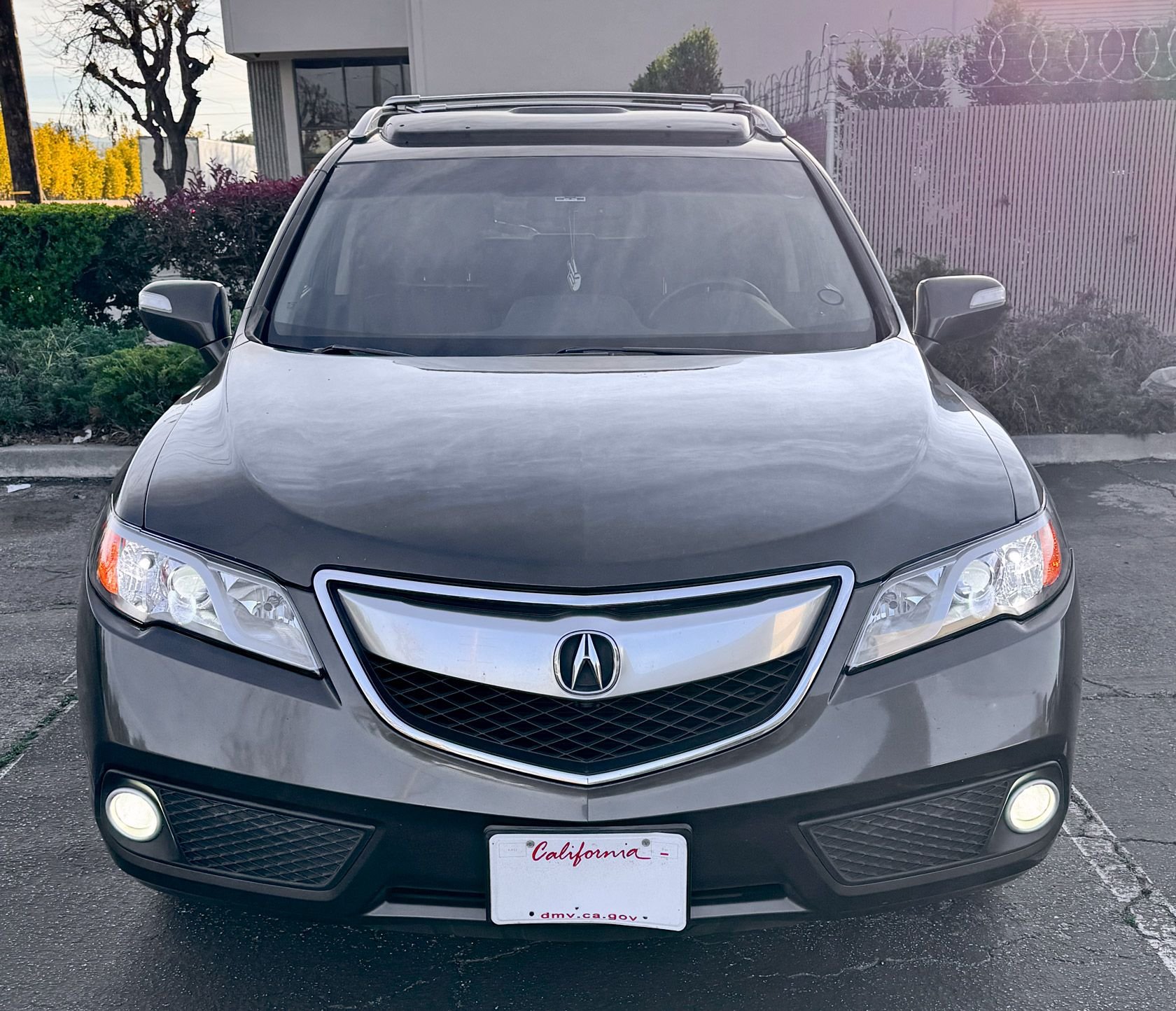

Low Beams + Fogs (Factory Housings w/ DD SL2 Pro H11s)

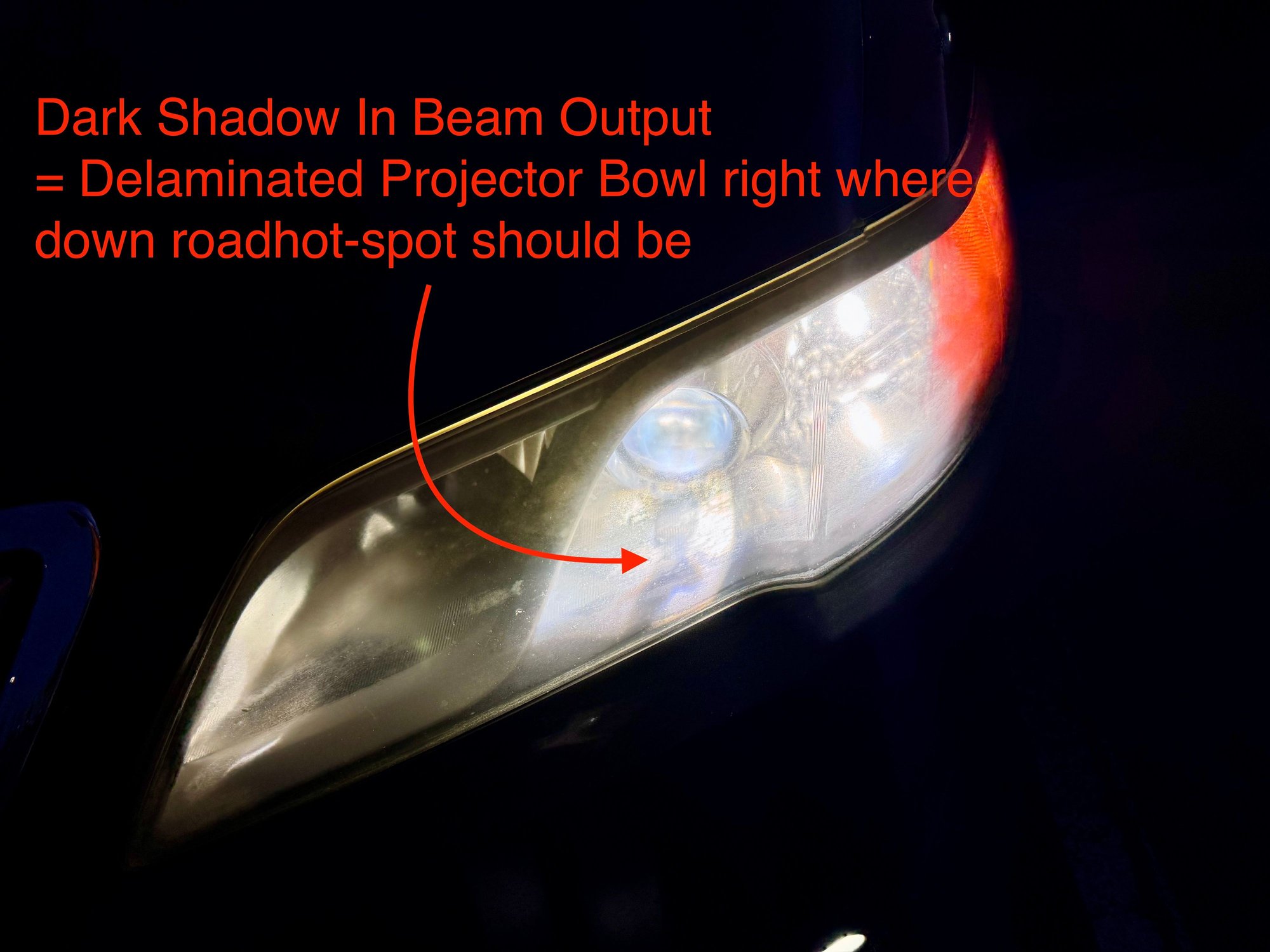

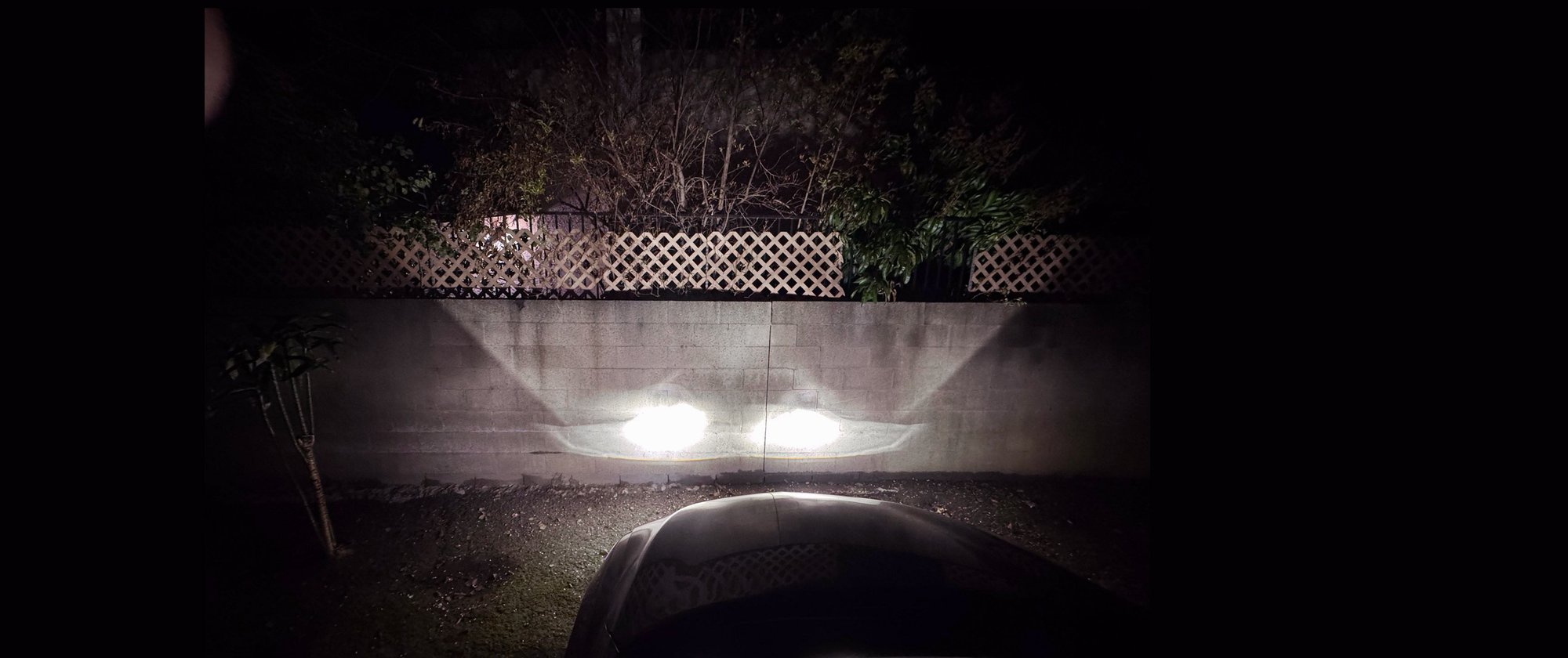

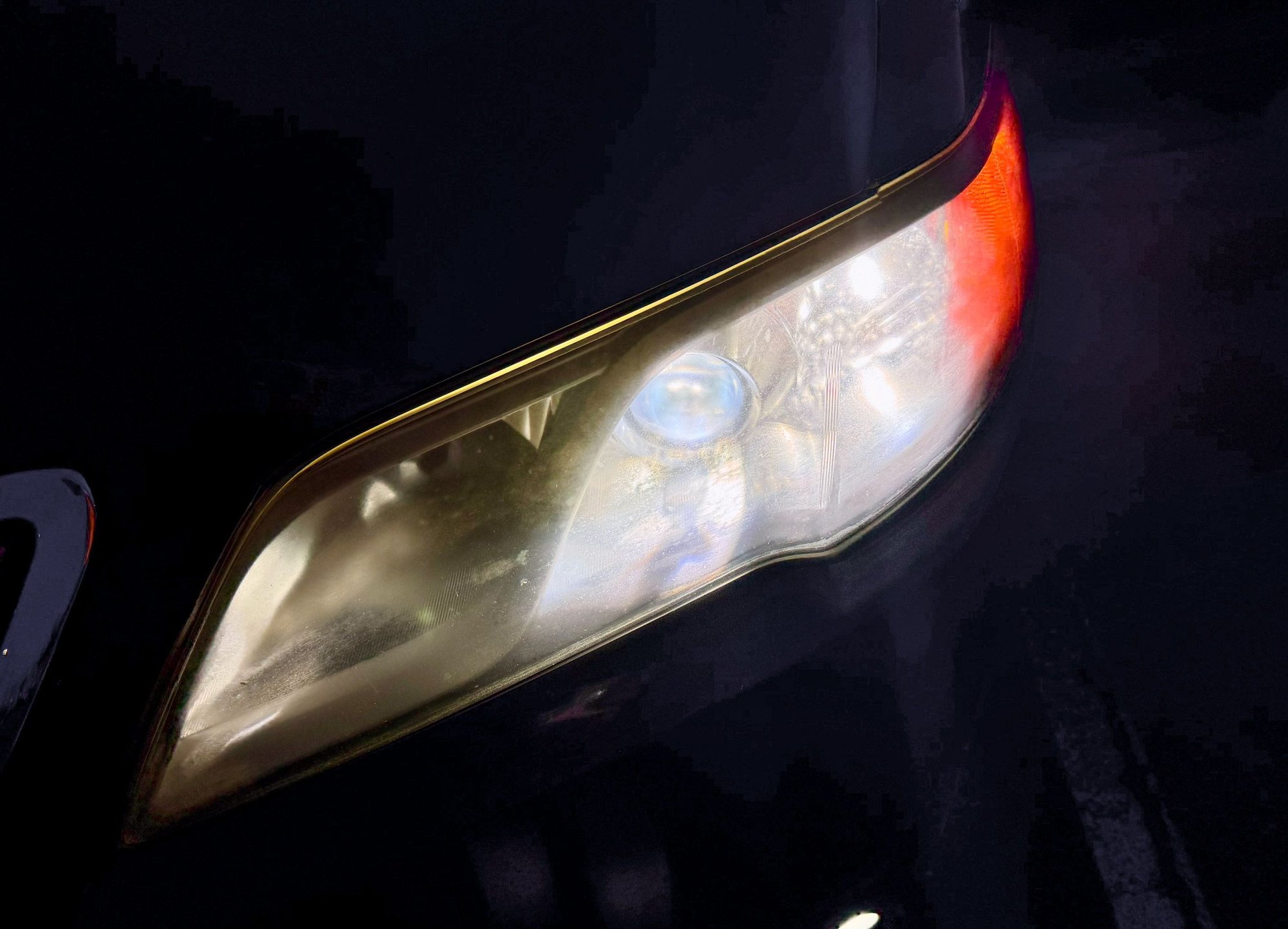

How shitty was the OE output before replacing them? Here we go.
The OE housings completely lost their center hot-spots since the delamination was right in that part of the reflector bowl. You can see it as a shadow of light in the beam.
That plus a crusty front lens results in a diffuse fuzzy beam with zero reach beyond say 50+ feet in front of the vehicle.
For what it's worth, I did polish these headlights last year with a Cerakote ceramic kit. And while they looked great for about 6 months, the protection quickly faded into what we see here.

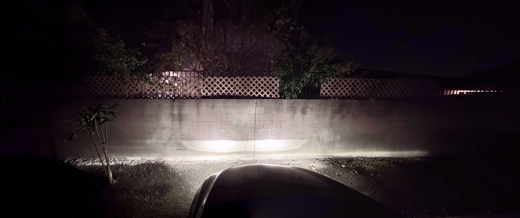

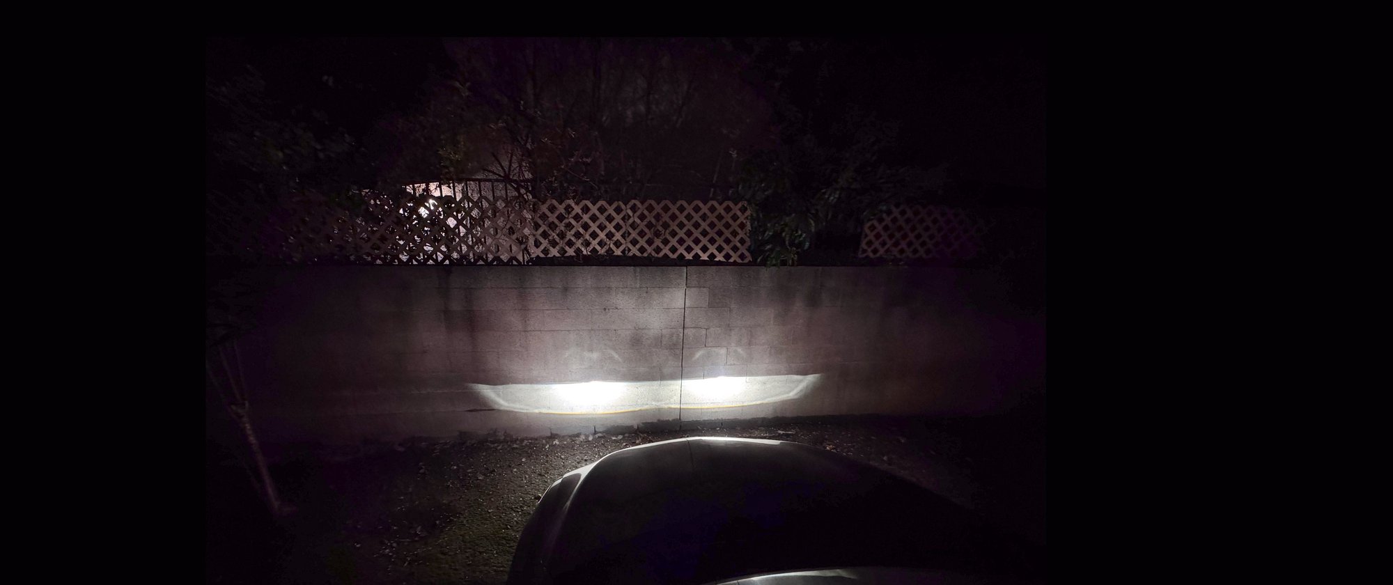

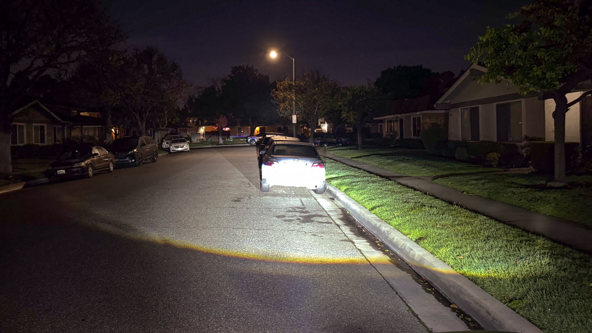

Here is a comparison with the low beams on & no fogs.
Stock Housings: Soft and fuzzy output, no cutoff.
Retrofitted: Focused down-road output, cutoff below windows and mirrors.
Now with the Diode Dynamic SL2 Pro Fogs on.
Stock housings + DD SL2 Pro Fogs
Retrofitted Housings with DD SL2 Pro Fogs.

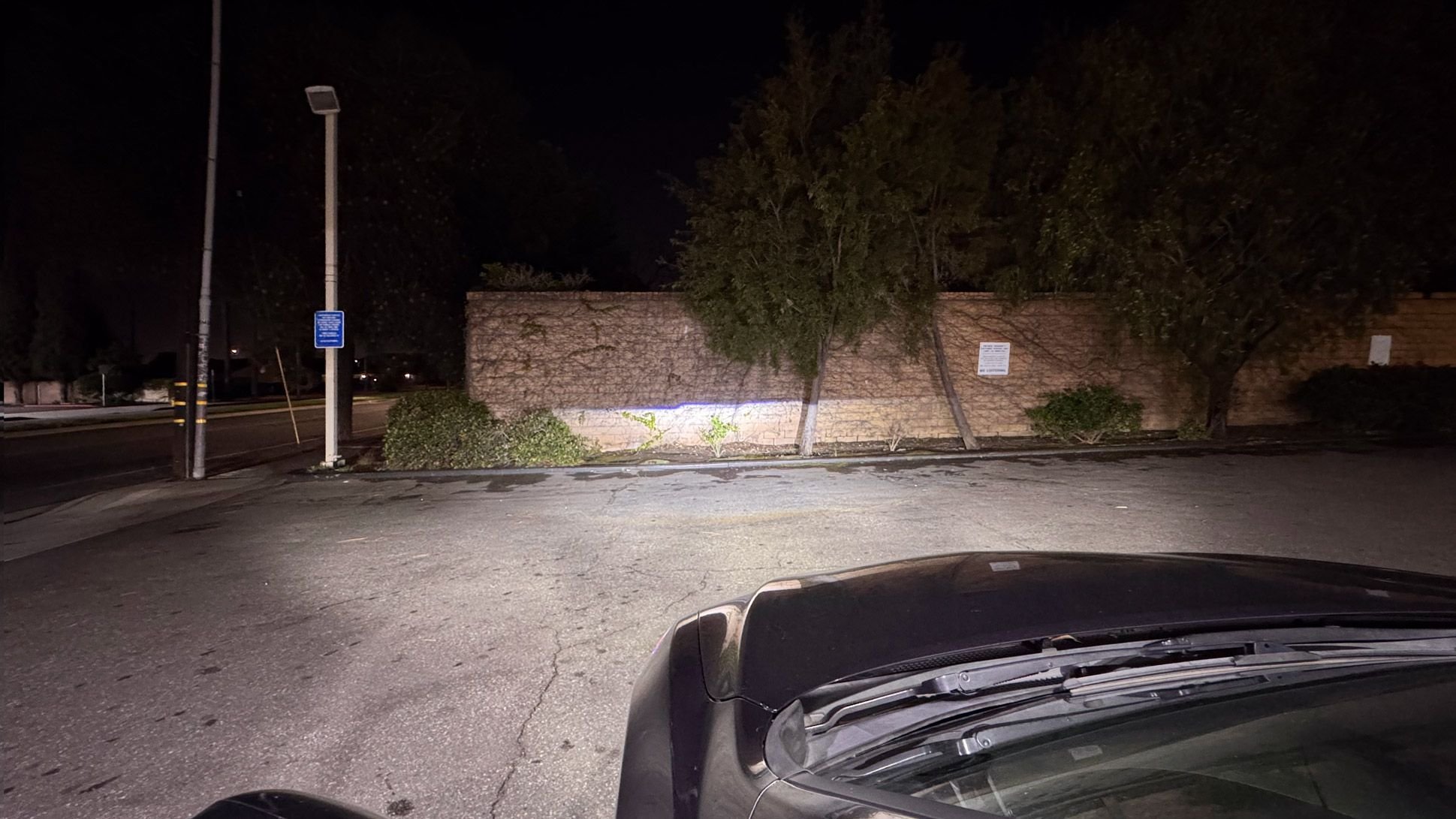

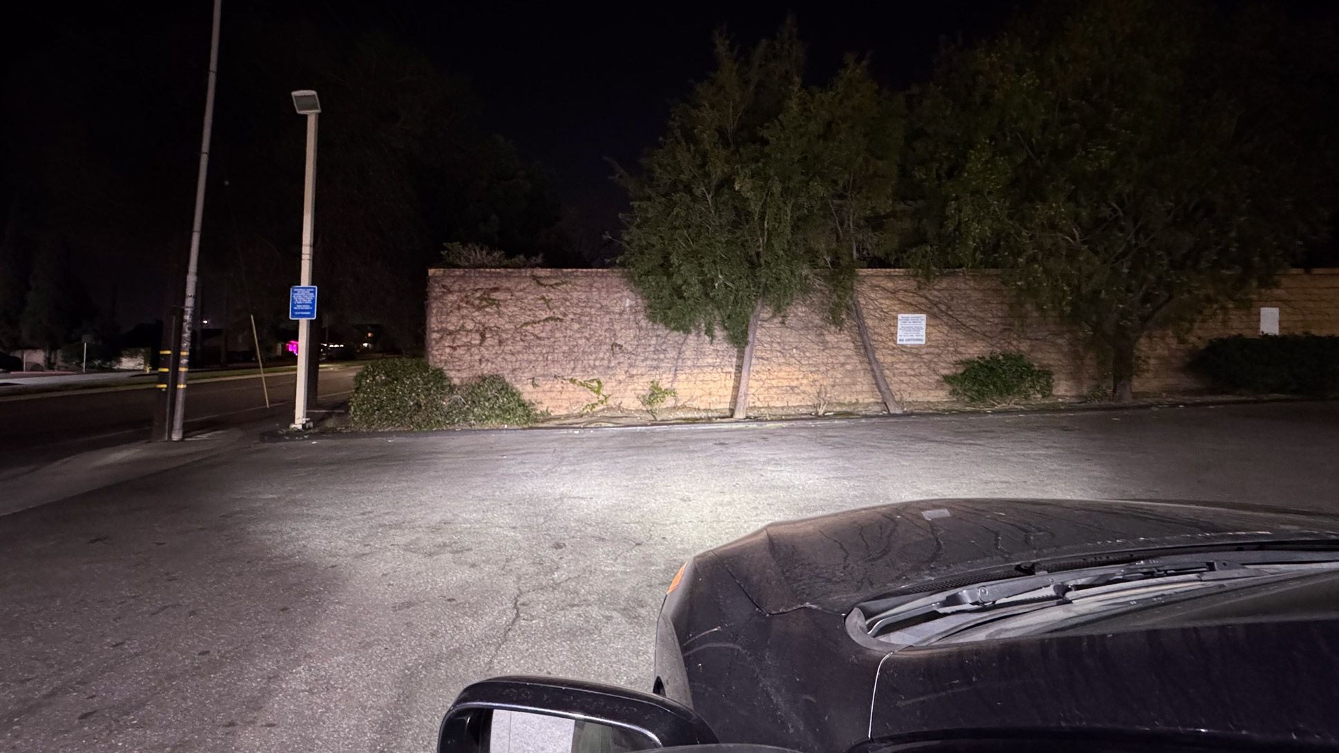

And a photo taken at the local gas station. Again with fogs on during both comparison shots.
Stock housings, fuzy beam with no cutoff. SL2 Pro fogs putting in work though!
Retrofitted housings, beam cut off is on point, and perfect color match with the SL2 Pro fogs.

DRL brightness when viewed down range.
Been using these headlights for the last 5 days as I've been working on getting the alignments dialed in. I'll add some more night/road photos later in the week if I can get to it.

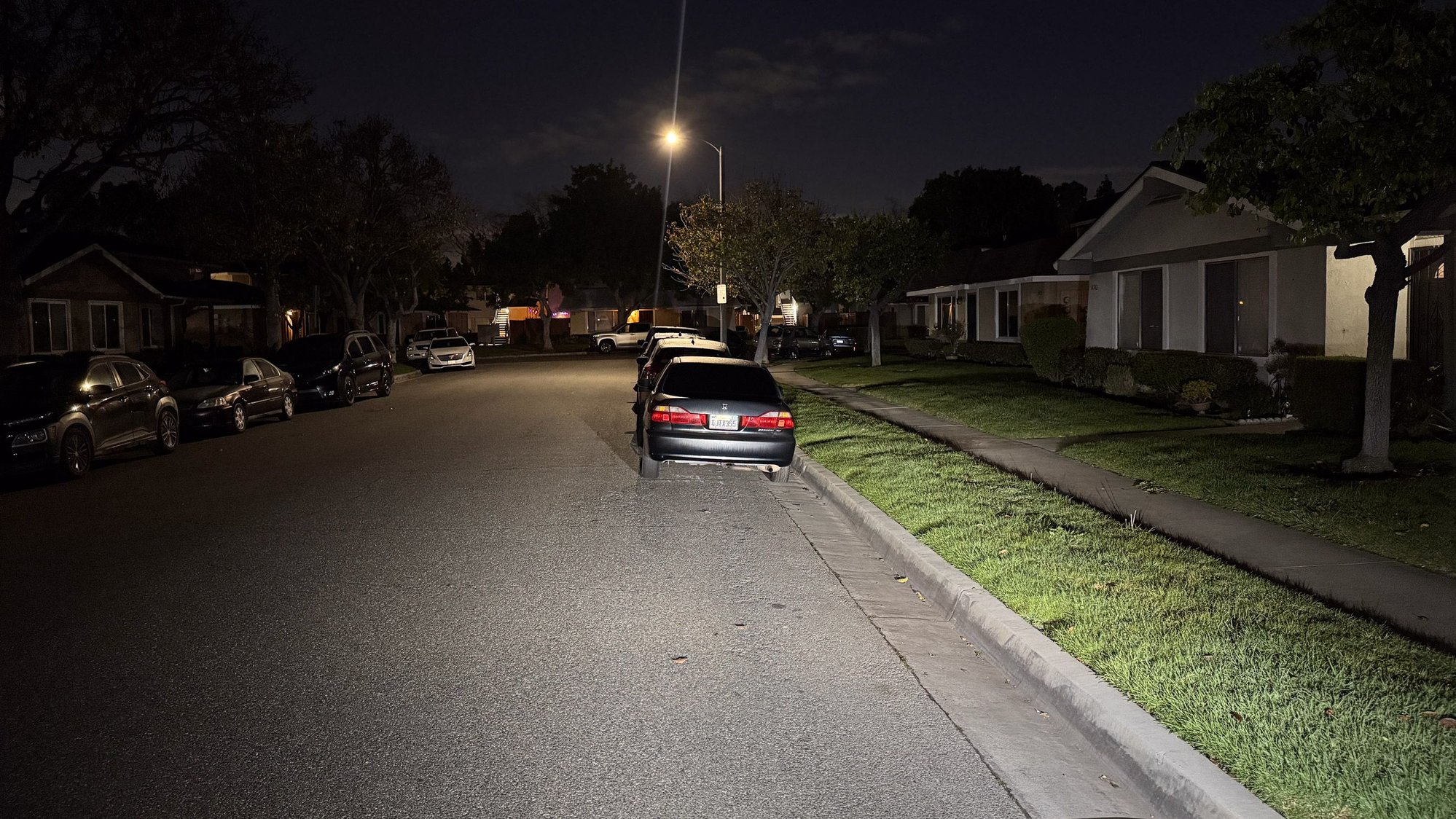

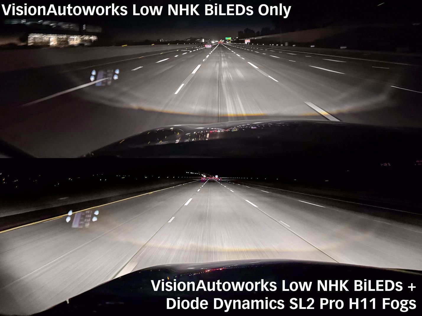

Alrighty, here are two shots from a midnight drive down the 5 on a trip from San Diego.
Slightly bummed that the top low-beam only photo was taken right as the car hit a slight bump, as noted by the angle of the yellow reflectors' light streaks on the K-rail.
But the lower photo with the fogs on was taken at a more level segment of the road, as noted by the level beam of light on the left side K-rail.
Now that the headlight beam is so clearly defined, it's obvious just how much this 2G RDX bounces up and down over road imperfections.

I have no particular use for the fog lights, but all you did with them is replace the bulbs, correct? So to get these lights, all I need is the (roughly) $1500, and then the willingness to install them?
This looks very nice, and I am giving it very serious consideration.
Thanks for the information!

Old Mar 4, 2026 | 06:38 AM
Thmanx's Avatar
Joined: May 2015
Posts: 432
Likes: 133
Yep, fogs were a direct bulb swap into the OE housings. The factory housings have a ridiculous wow beam, it actually expands 2x left and right of these photos providing a near 170* beam that you can see out the side of the driver side window into the k rail or ditch.
The headlights are just a full replacement, just drop the bumper, remove 4 bolts, and swap.

I have received the headlights, just waiting for a nice day and the time to install them. $1550 delivered; I am quite tired of the low light conditions of my stock lights. Although I haven't opened up the box yet, I just wanted to ask you: this package includes the excellent DRL results you have shown, does it not? I am new to this part, so I'm not sure of the specific advantage of the Diode Dynamic SL2 Pros. If I need to replace them to achieve those DRL results, I will order them right away.
I am asking before I open the product box only because I don't want to do the installation, then have to repeat taking the bumper off et al. in order to change the bulbs.
In any event, thanks for this information; I too will post pictures when I am done.

They come with a set of standard halogen high beams so you’ll want to order a set of 9005 Diode Dynamic SL2 Pros. Either from Diode directly or another 3rd party vendor that has them in stock.
it’s best to install the high beam bulbs when you have the housings off because it’s a real squeeze to get them in when installed when in the engine bay.
the bulbs include a little Alan Key so you can adjust the clock position of the base. This is important because our high beams lock in with a 45* offset that’s mirrored on each side. If you drop the bulbs in directly as is, the beam pattern will be all outta wack.
make sure you check, adjust, and lock the new SL2 Pro bulbs in the correct orientation into the headlight first so that the emitters are firing exactly to the left and right sides.
as for an affordable and great functioning white/amber signal bulb. I ended up going with these from Amazon.
Amazon Amazon
They fire in all directions evenly, and have a bright amber signal that didn’t require any load resisters.
lastly, make sure your Y adapter for the high beams click in securely. On my first install I accidentally bumped one of the pins out of the plug and didn’t have my high beams work on one side. I had to reseat the pin and make sure it was secure.
These 10+ year old blown AF OEM shocks will be replaced with a set of KYB's, and new Acura bits for all the suspension bushings and related components in the next few weeks.

Because down range visibility and even beam distribution.
The NHK M1 LED projector assembly in these headlights is designed specifically for headlight retrofits just like this. With 50 Low / 55W High of focused LED output power, there simply is nothing that a drop in bulb or even a set of brand new 35W HID bulbs could do to match the output of these NHK projectors. The luminous efficiency and wattage of these projectors beat anything you could install otherwise.
Also, these projectors are Bi-LEDs, which means when you flick on your high beams at night, the low beams projectors open up to full high beams projectors with insane output down the road and to the sides of a highway when in the back country.
Add a set of Diode Dynamic SL2 Pros to your existing 9005 highbeam reflectors, and effectively get quad highbeam output for the back country + perfect white DRLs in the day.
Even if you're driving in the daytime and just need to flash your high beams to signal someone in front of you, only the SL2 Pro high beams flash bright, keeping your projector's low beams off just like the factory.
It truly is an ultimate upgrade with no downsides and all benefits / added features.
