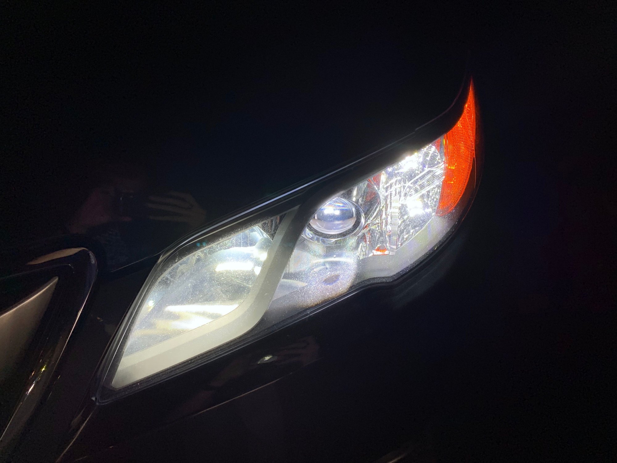

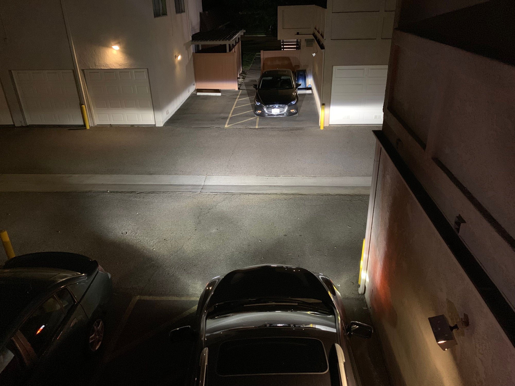

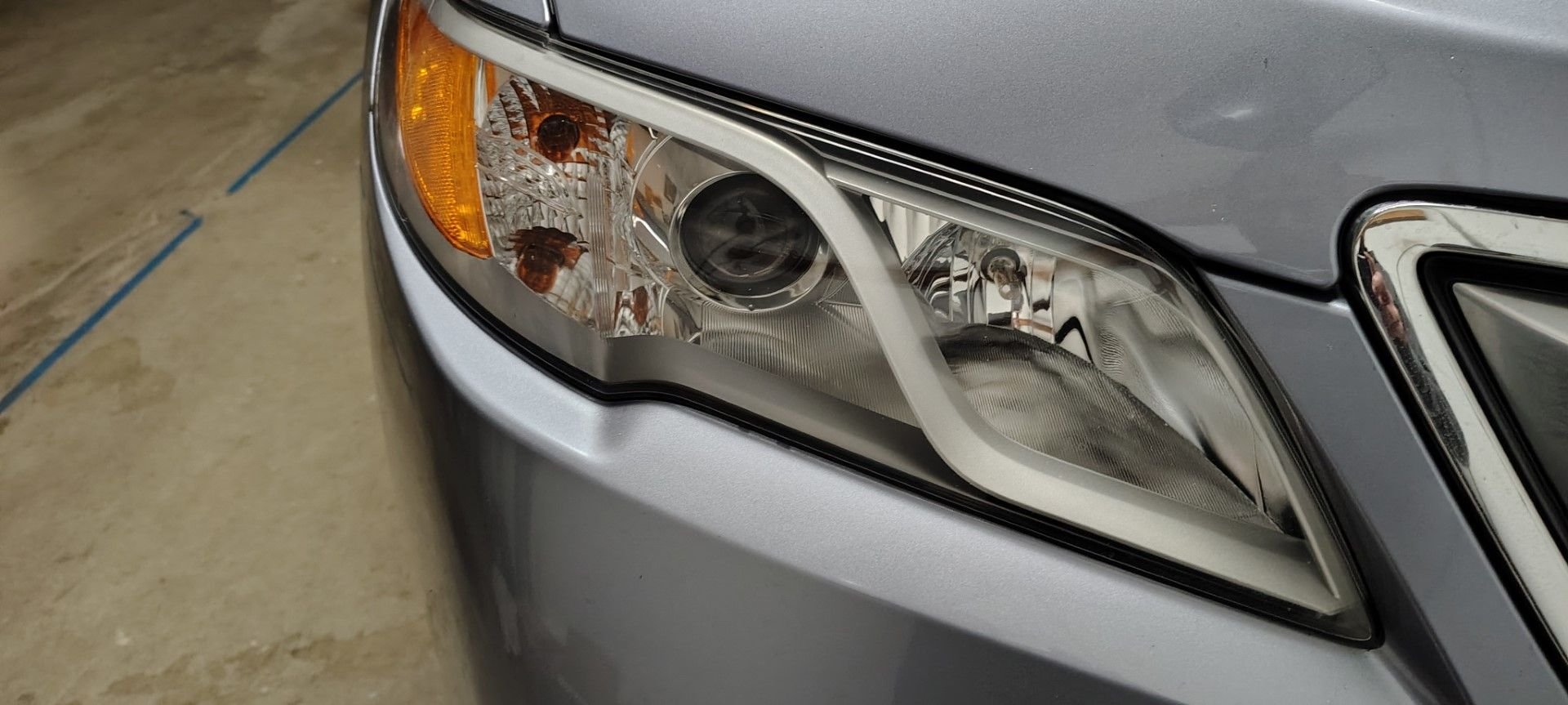

Is there a way to tell if the projectors are de-laminated? I am adding some photos. The "wall" test actually looks decent - still have pretty sharp cut-off. Visually, I can't tell any de-lamination, unless I am not looking in the right places.

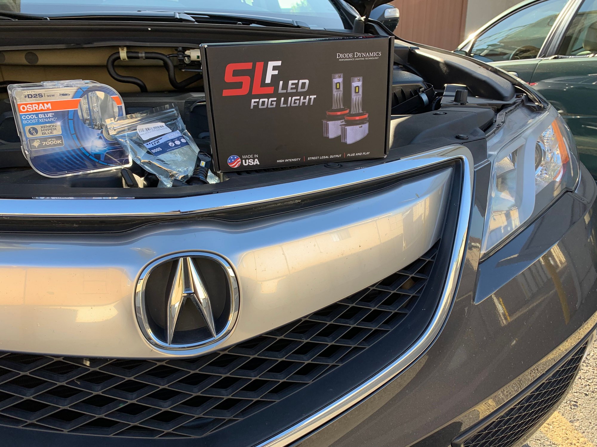

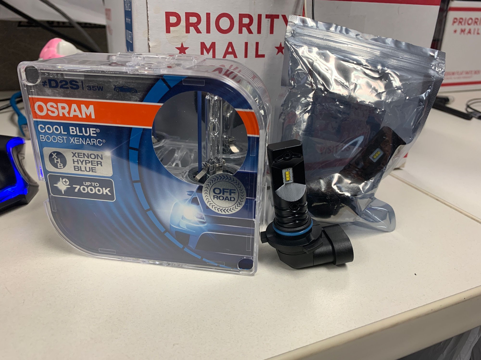

I replaced my bulbs back in May of 2019.
I used Osram Cool Blue Boost D2S bulbs, and Xenon Depos 5000K 9005’s for the DRLs. With Diodes older SLF H11 fogs.
The CBB bulbs were a nice neutral 5500K white in practice and you could tell the difference compared the the warmer tone the 9005 DRLs and SLF fogs had.
The Philips Xtreme Vision 2’s were not an option back then, if I were to recommend a set, it would be those now.
I’m much happier with the matching white points of the new SL2 Pro 9005s and H11 fogs with my retrofitted headlights.
but here’s the photos from then for reference.
the old Xenon Depo 9005’s had a fixed base, so you can see what happens when they were installed. The emitters were clocked 45* off. Didn’t effect much as far as DRL use, but the beam would not be usable (not focused or powerful enough) as a function High Beam.
