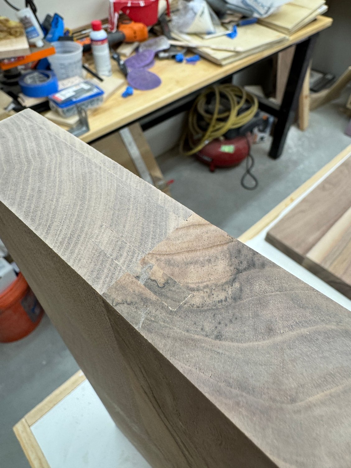

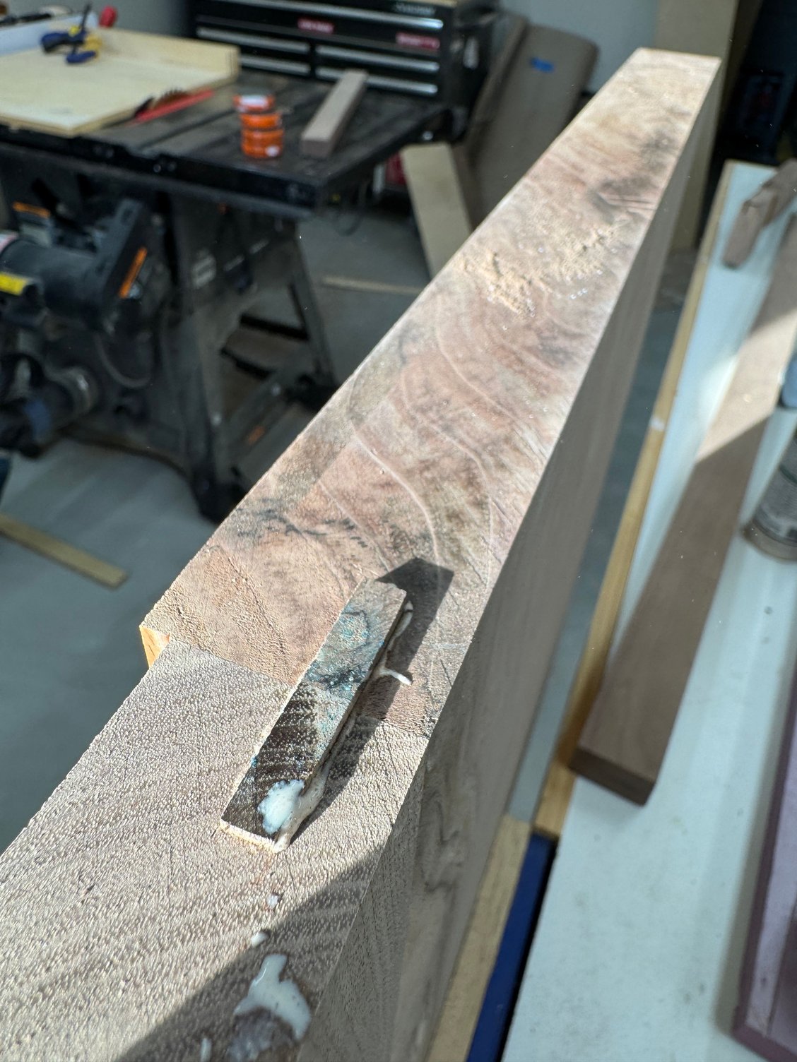

First up, we can't have a real project without a fuck up to fix. I had to extend the width of the slab a bit to fit the space needed so I added on a chunk of walnut to the back and used some dominos to align the top faces perfectly. In my desire to get this done, I wasn't keeping in mind where my cut lines would be for final shaping and cut right through a domino on the show side of this piece. Was too pissed off to take a picture but quickly decided that it's only a problem if I can't fix it so I routed out a 1/4" groove over the newly exposed domino, grabbed the off cut of the piece I just cut off, cut a 1/4" chunk out of that piece to match up as close as possible to this location, sanded the fit to be as good as possible, glued it in, and sanded it flush. You can hardly tell that anything went wrong.
This is the patch in place. I matched the joint location and grain pattern as close as possible.
And after sanding it flush. With the finish on, you can't tell anything is there.

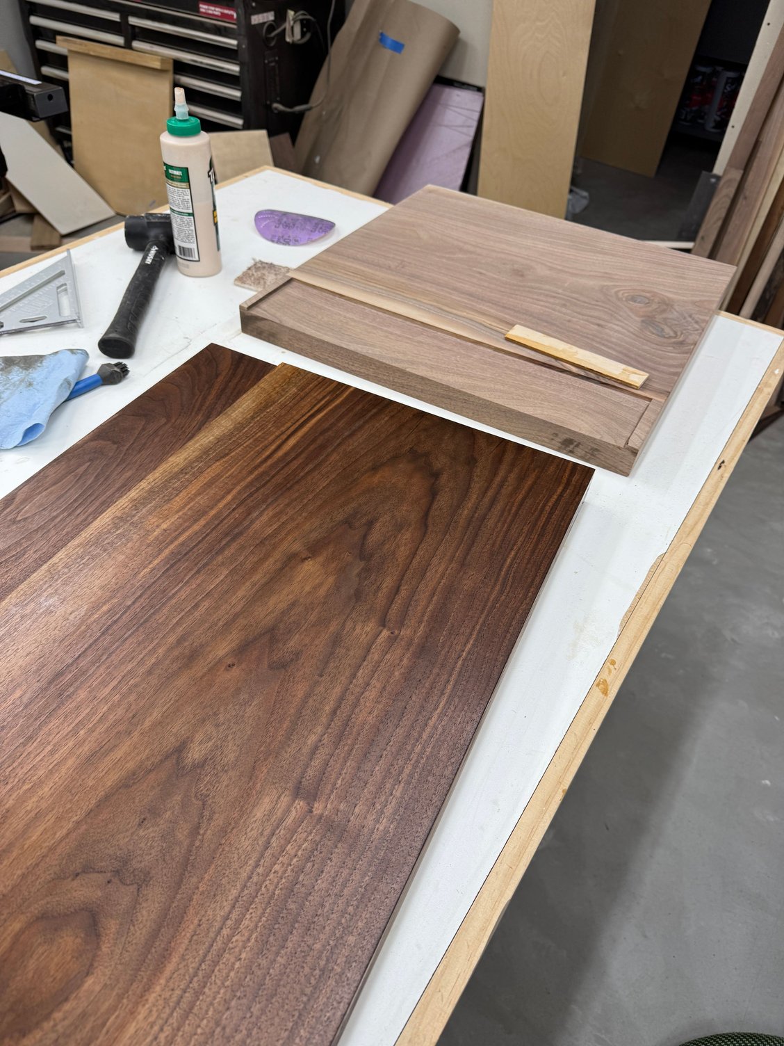

Once I got all the final sanding done up to 220 grit, I wiped everything down with a wet cloth followed by a tack cloth before finishing. This is the first coat of hardwax oil which is my go to finish for just about everything. You can see the finished bench (bottom) and unfinished countertop (top).

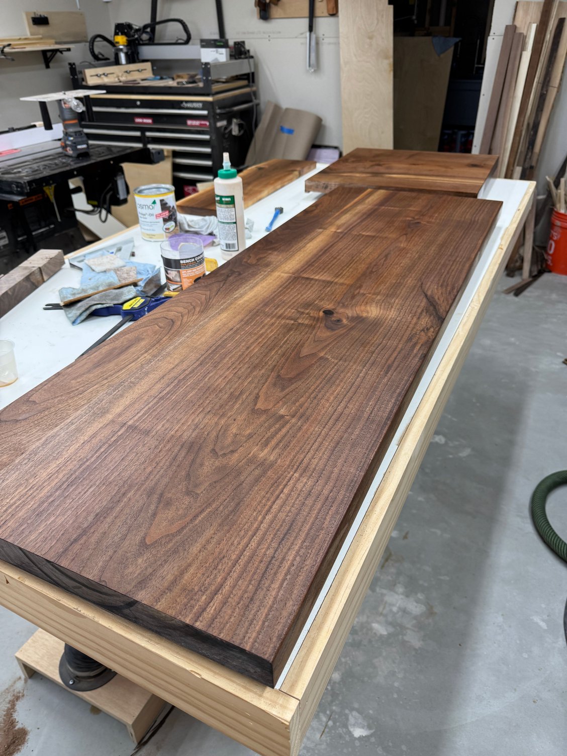

And everything finished with two coats of hardwax oil.

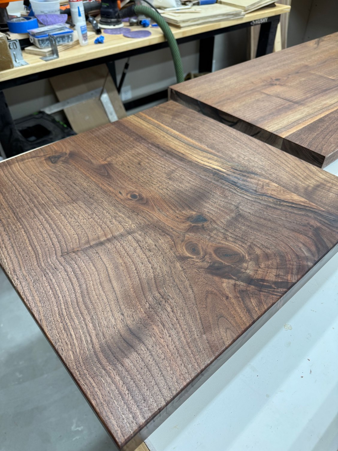

And a closeup of the countertop piece which, IMO, is the showcase part of the slab.

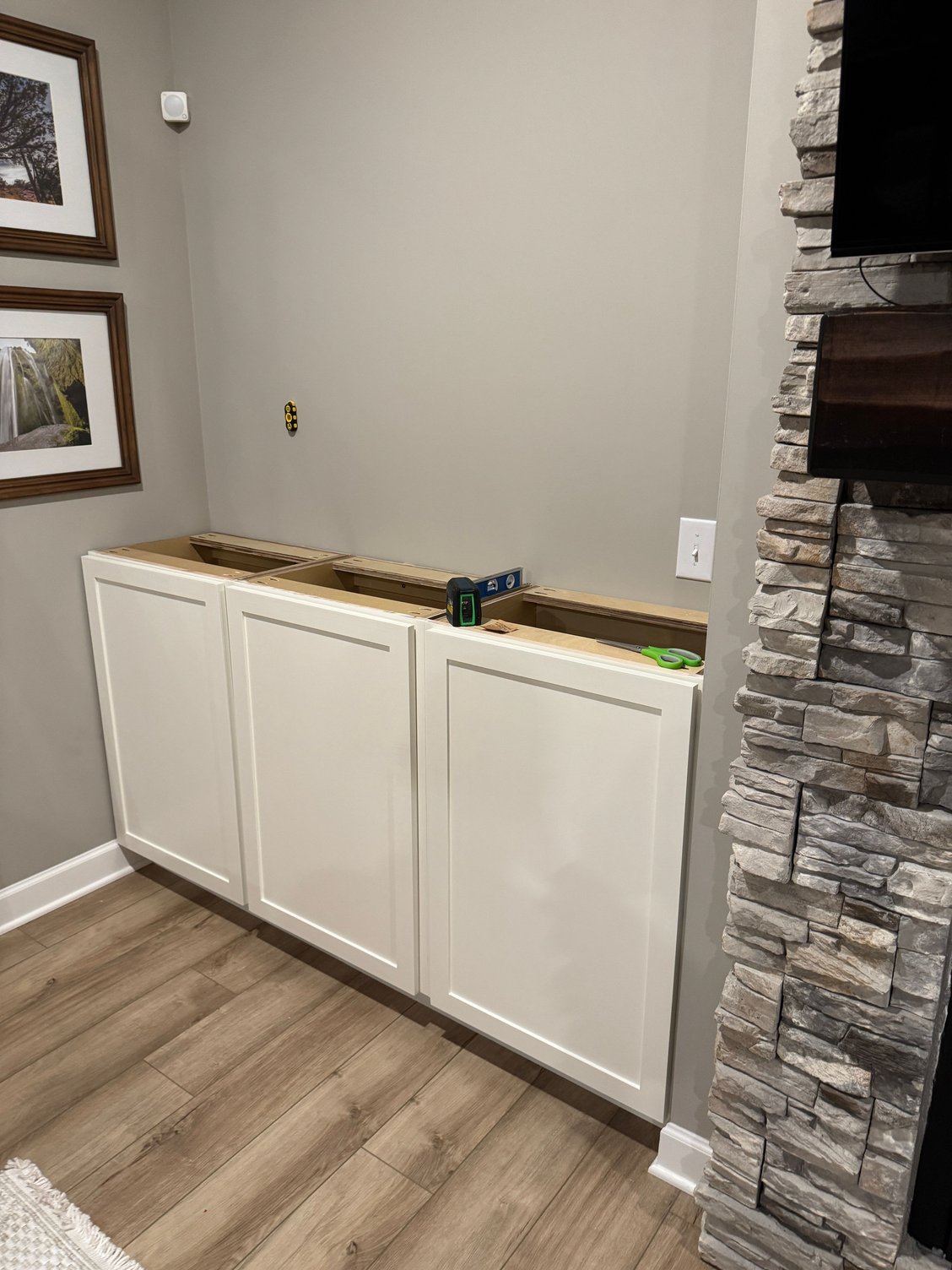

Just got my next cabinet built in project completed with these cabinets for next to my fireplace. This one was pretty easy and managed to knock out all of it in about a week with 3 of those days being painting lol.
I think that this was the one straight wall in my house that I didn't have to scribe to fit it in there nicely.
Next up will be to make the top for this, it's the same as the bench top I posted about before and actually a slab from the same tree. The good news is that one is already epoxy filled (did it at the same time as the last one) and rough sanded so all it needs is final sand and finish. I don't think I'll get as lucky on the scribing front for the top so that will have to get scribed to the back wall and cut to fit as well but I've gotten pretty good at that lately.

Those came out great. Although not a surprise really with the quality of your work. With all your cabinet making, you have inspired me to try my hand at some cabinet making for the wood shop area later this year.

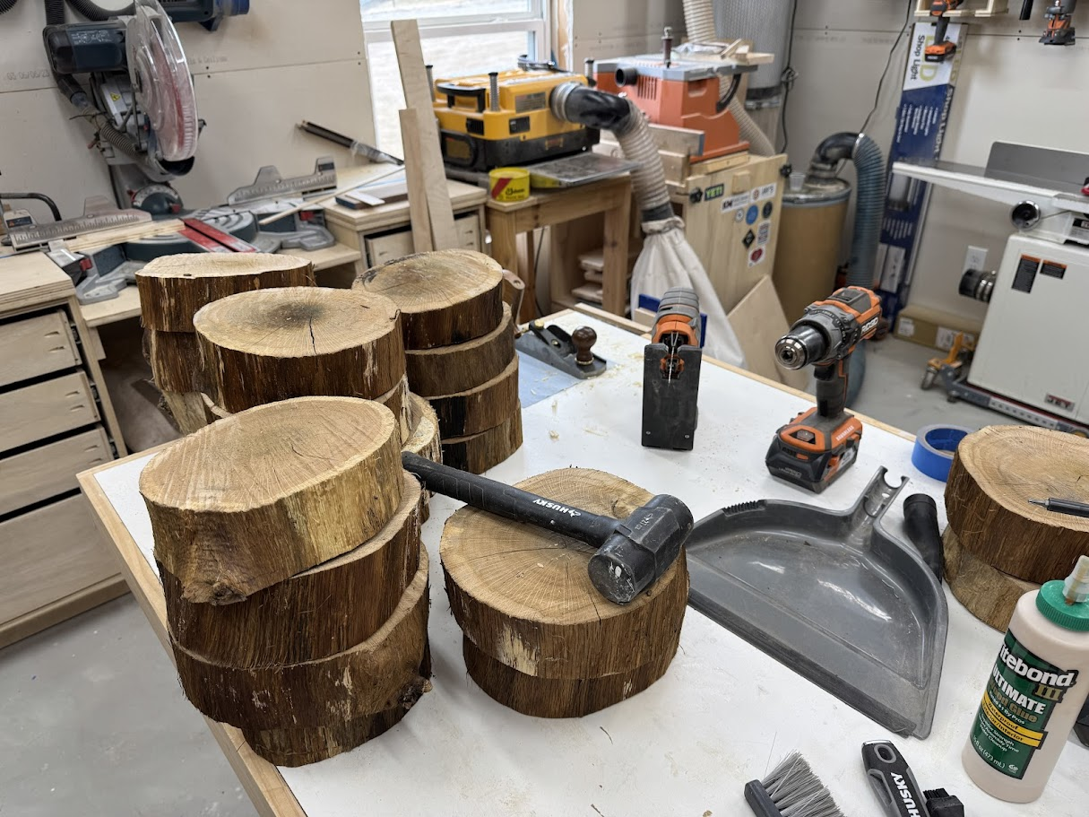

Starting a new kind of stretch project with this. Going to take all of these white oak cookies and weave them together into a table top and fill the gaps with epoxy. Will be my first run at doing an actual epoxy table so makes me a bit nervous for that...

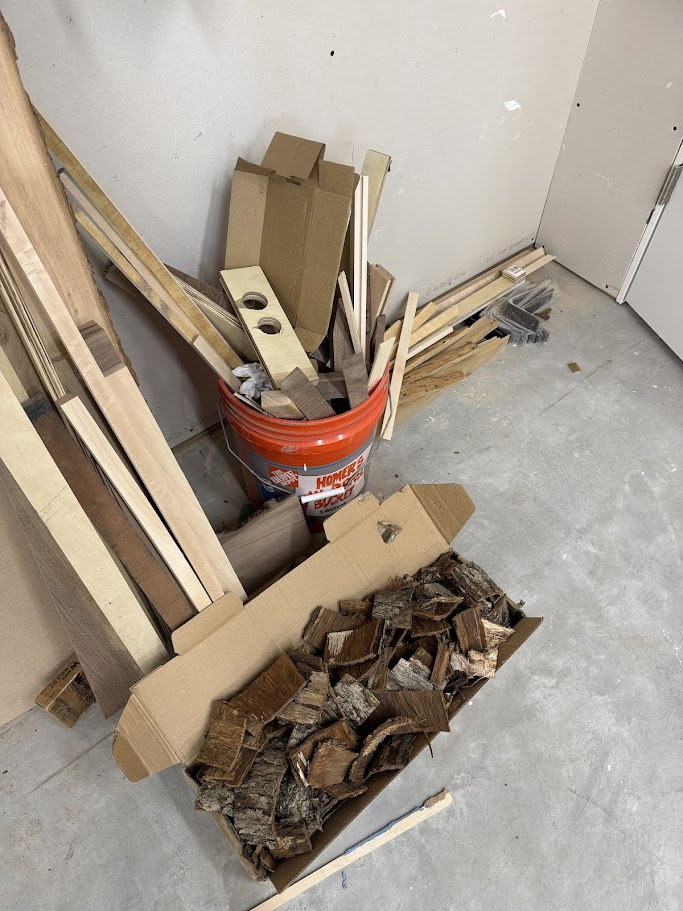

First step was to remove all the bark which produced a bunch of good stuff to burn lol.
As these were all cut with a chainsaw and are nowhere close to flat, the first step will be to flatten them so I made this jig out of some scrap plywood to flatten them all. Then I realized I didn't have a bit suitable for flattening things so had to order one of those and am now waiting for Bezos to deliver it to me.
After this we're going to make a YUUUUUGGEEE mess with flattening these. Guess I better empty the dust collector bin before I start lol.
