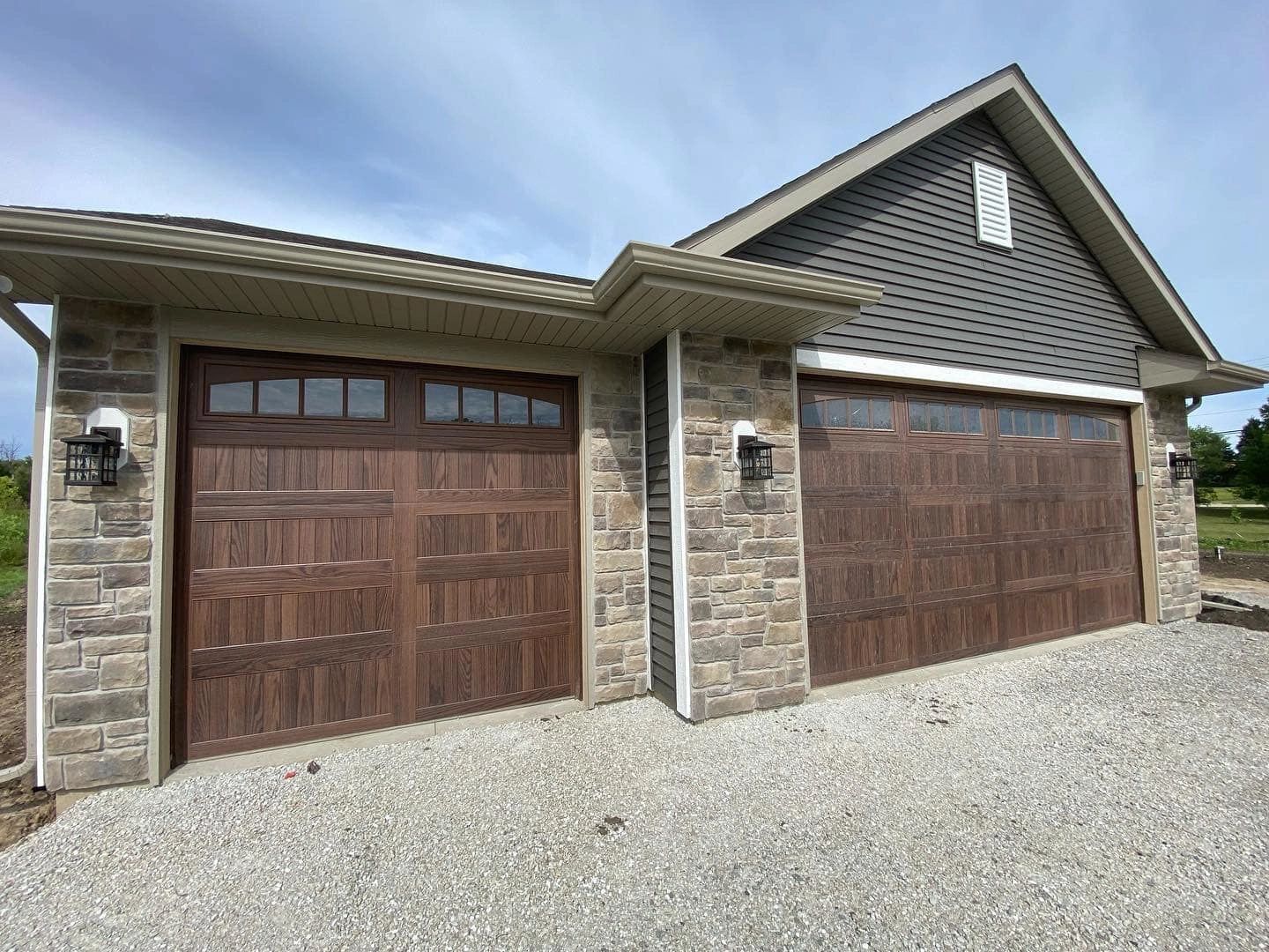

Hinge side of door would have to have an angle cut on the edge to allow it to open past 90° so that side may look a little weird but still better than a half cut trim board.
I like the darker tone for the stain.

What color are you garage doors going to be? I would try to color match the shutters to the doors.
Everything is coming together very well. Want to come to Wisconsin for a little bit and wire up a camera system for my place? I have no clue what I would be doing for that.

I was going to consider doing them brown but then I need all new shutters. So painting them a darker gray allows me to reuse the ones on the house for a while at least. Worst case I end up hating the look and make my own later on and staining them brown. Whatever color I paint the shutters I will repaint the front door to match. Eventually though I want to put in a fiberglass front door to match the garage doors.

Just bustin yer balls a bit. Those look good, and I think will look better in gray.
We had similar [windowless] wood veneered doors on our old house & never liked the dark brown that they were stained. We'd thought about re-doing them in dark gray or black before we ended up moving.
