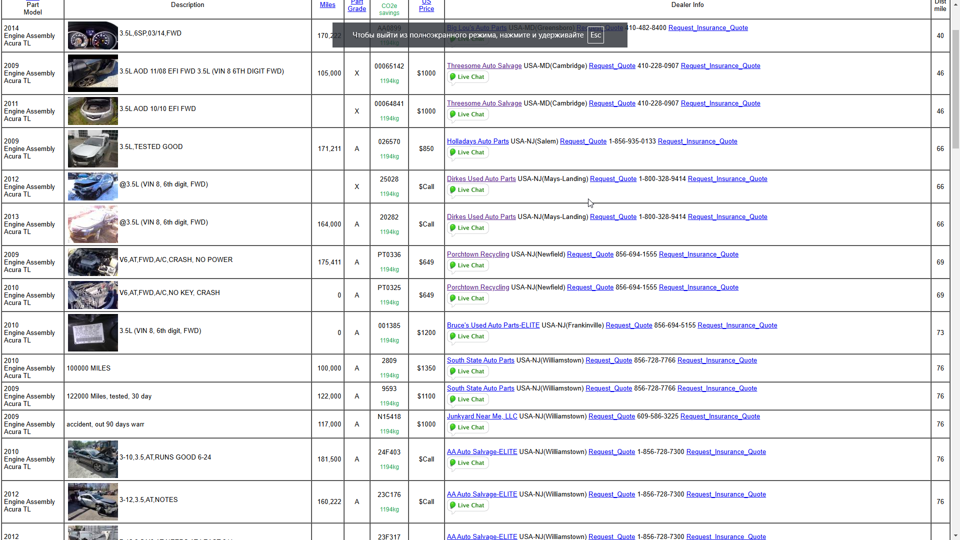

A junkyard j35z6 looks to be around 1200-1500CAD here as well but I have no experience buying a used engine... that kinda scares me. Mechanic is quoting 22 hours @ $125 shop rate, and $5k for a junkyard j37a4 so that's the ferrari price tag right there. He also gave me the option to replace just the heads for $6k... but I might just pull the heads off myself to see what I can see.
Here are the prices for these engines in our area.

Originally Posted by altair47
Congratulations, your mechanic is a scammer.
Regarding the used engine, the most important thing is to find out its mileage and VIN number, which is written on the rear head.J35Z6 are very reliable engines and it is very difficult to break them with poor maintenance.
I don't understand the pic, is that saying that on paper the swap is 11.2 hrs labour?
looks like my prices are similar. what info am I lookign for with the VIN? Or is that just a confirmation on the engine type and manufacturing date?
Yes, the standard for replacing an engine at a dealer is 11.2 hours, but if the car is older than 10 years, garages usually add 25% to this figure to have a reserve for force majeure and to earn money. On average, I spend 3-4 hours removing this engine, 2-3 hours swapping attachments, and 5-6 hours installing it. You need the VIN to verify the mileage and service history via Carfax.

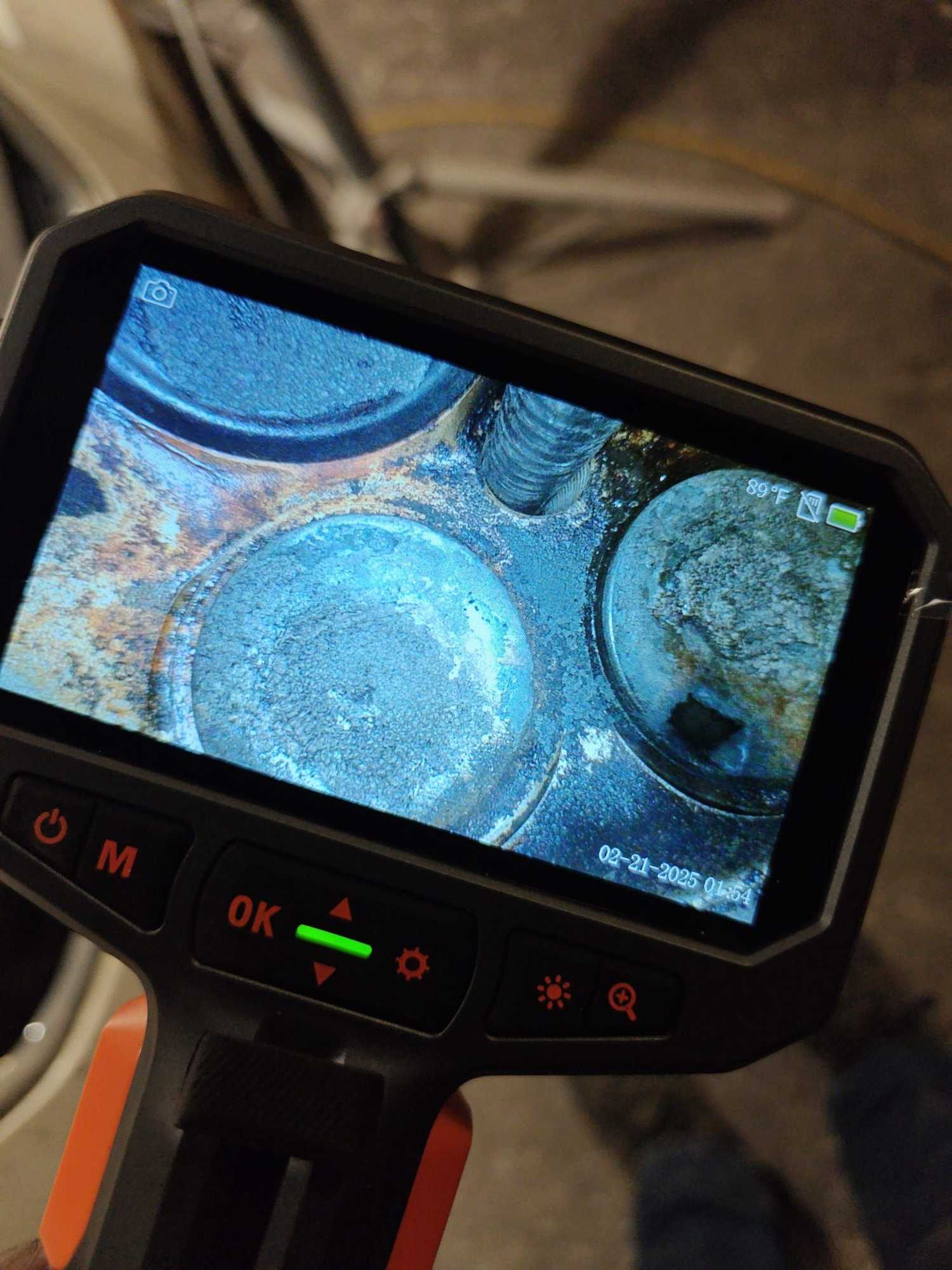

Ahh okay. Think I found my issue...

Also... do these look abnormally nasty for this engine or is this par for the course with the oil burning issue?
With your mechanic prices, I dare to assume that you will be replace the engine. Right?
What is the mileage on your engine?
I called a machine shop and got a price to rebuild each head for $600. So around $1500 for rebuilt heads and new gaskets? Plus fluids and my time to reassemble. Based on those pics does it look like thats a reasonable option? I have also been put in contact with another mechanic, a friend of a friend, who will help me swap the engine for $800 plus whatever the new engine costs. Which is likely the better option?
180k km on my engine
If it were my engine I would rebuild the heads but if I were paying it would be more expensive than replacing the engine. Replacing the heads would take as much labor as replacing the engine.
