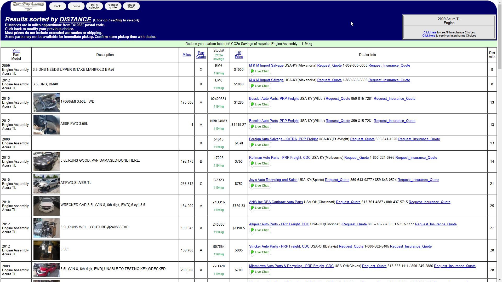

Originally Posted by wzamrine1
where's this one located. I'm in the process of looking for one now.
https://www.car-part.com/
What is your zip code?
41063
Here's a great option for $1200, give them a call, you might be within their free delivery radius.
Search Auto Parts :: Allgeier Auto Parts | Cincinnati OH
if you need it cheaper, then try this one for $750, but on the condition that they give you the VIN to check the service history and verify the mileage.
carthageautoparts.com strange, but this link does not work here, so just copy the address into the address line and then it will work

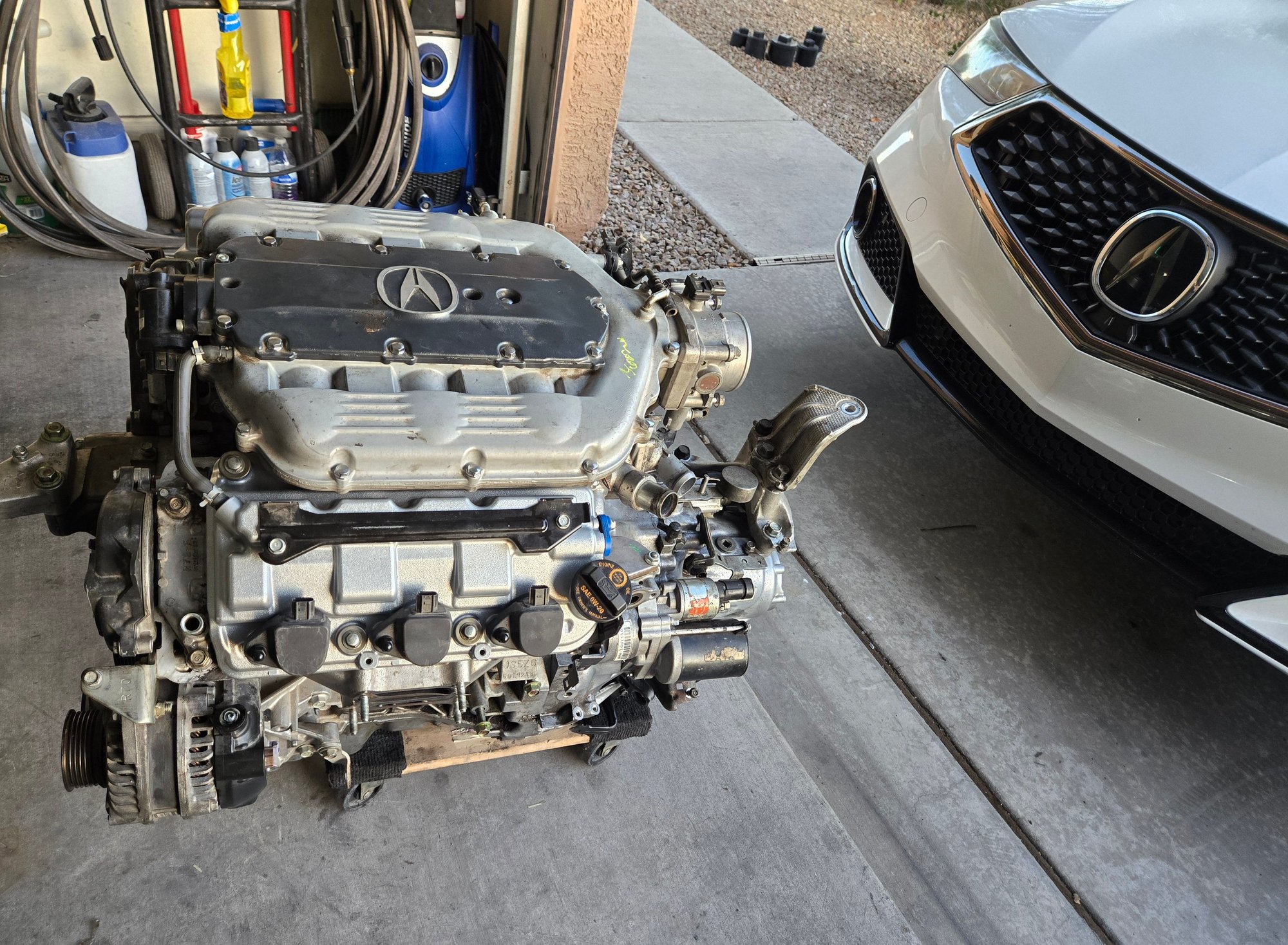

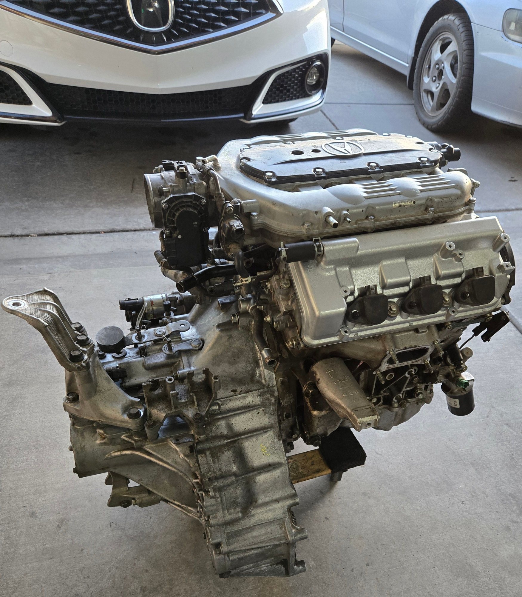

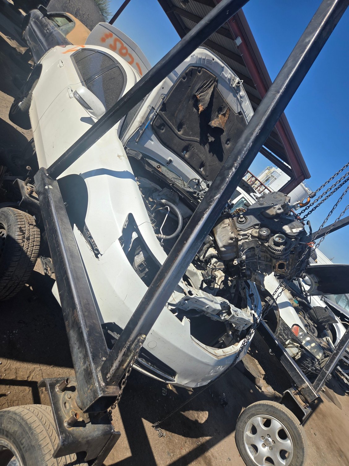

Tucson, AZ
Pulled the motor today. Was a little over $300 with a $57 core charge. So around $250 with a 30 day warranty.

For gee whiz reference i've had both a j37a2 and j35z3 in my 8th gen accord, which are very similar to the j37a4 and j35z6. I'm now working on a side project, 2013 J35z6 paired to a 2011 TL SH awd 6spd manual trans.
Few pics:

Dope! Where'd you find the Z6? Anything you have to inspect before you go all in? Just got a quote to swap my 3.7 for a used 3.7 - $9000 CAD so I might be cooked. Might have to look at doing this myself.

$9000 CAD? Is this a Ferrari? J35Z6 costs here $1200-1500USD + 12 hours of labor. This is a maximum of $5000CAD. Moreover, you can’t be 100% sure that a used one is no worse than yours.

A junkyard j35z6 looks to be around 1200-1500CAD here as well but I have no experience buying a used engine... that kinda scares me. Mechanic is quoting 22 hours @ $125 shop rate, and $5k for a junkyard j37a4 so that's the ferrari price tag right there. He also gave me the option to replace just the heads for $6k... but I might just pull the heads off myself to see what I can see.

Congratulations, your mechanic is a scammer.
Regarding the used engine, the most important thing is to find out its mileage and VIN number, which is written on the rear head.J35Z6 are very reliable engines and it is very difficult to break them with poor maintenance.
