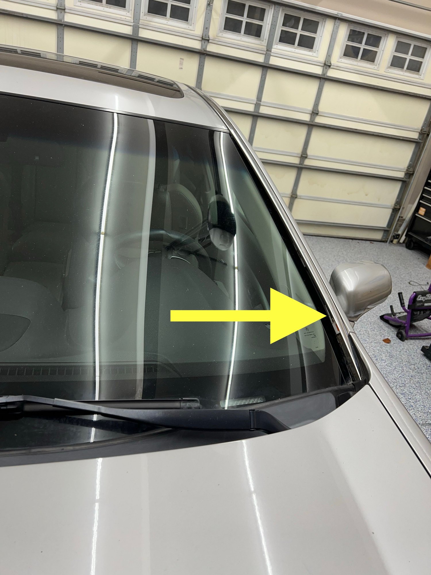

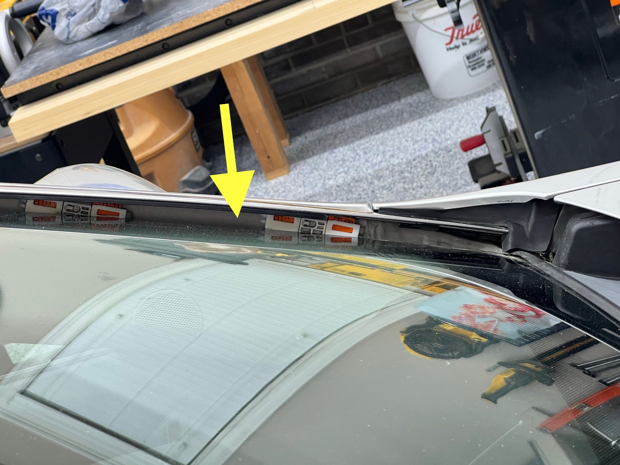

Looking for some assistance - The rubber between the windshield and the driver's side chrome drip molding on our 09 TL has disintegrated. This rubber appears to have been attached to the drip molding. If so, does the entire drip molding need to be replaced? If yes, Is this the correct part? 73163-TK4-A02. TIA.
Rubber has disintegrated and been removed, leaving a gap between the chrome drip molding and windshield.

Jun 10, 2025 | 09:49 AM

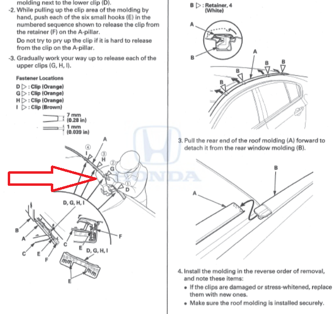

Quote: Looking for some assistance - The rubber between the windshield and the driver's side chrome drip molding on our 09 TL has disintegrated. This rubber appears to have been attached to the drip molding. If so, does the entire drip molding need to be replaced? If yes, Is this the correct part? 73163-TK4-A02. TIA.
Looking at the general area the yellow arrow is pointing to, on the image below,...
and comparing it to the partial screen shot Riboflavin's FSM's removal instruction (red arrow) below (taken from his DIY thread above), I would guess .

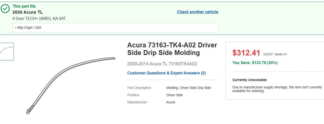

73163-TK4-A02 is the driver side drip molding and appears to be 'unavailable' on the Acura vendor website screen shot and 'discontinued' on the Honda website below, as well.
Therefore, if you need this drip molding, I would act fast & consider the one found on ebay below?
New Genuine Acura TL Roof Molding Drip Side Left (2009-2014) OE 73163TK4A02 | eBay
