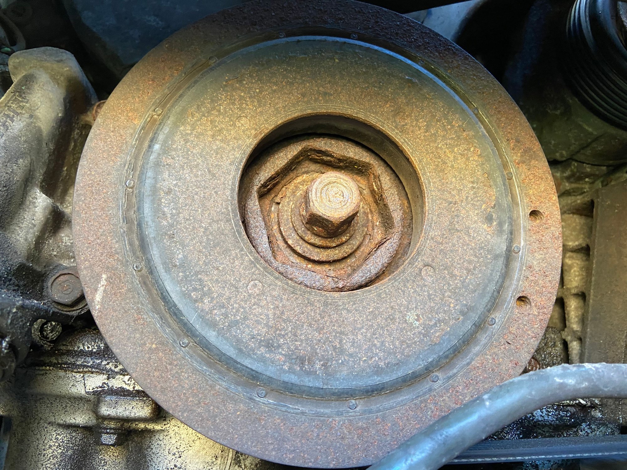

How does the crankshaft pulley look when the engine is not running? Can you share a picture of that?
Old Feb 12, 2023 | 02:18 PM
Jaypoo's Avatar
Joined: Feb 2023
Posts: 16
Sorry for the delay. Had to wait for better weather to get out and look at it again. Thank you for the diagram with the AC compressor labeled. That helps a lot. Attached are pictures showing the crank pulley, the AC compressor, and I think the idler pulley. Nothing seems amiss with any of them. I do notice that the AC compressor pulley looks newer than the other two I was able to find out that this car head timing belt kit done 15k miles ago by a reputable mechanic.

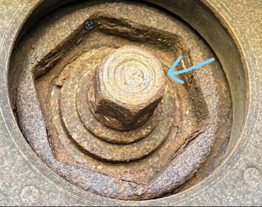

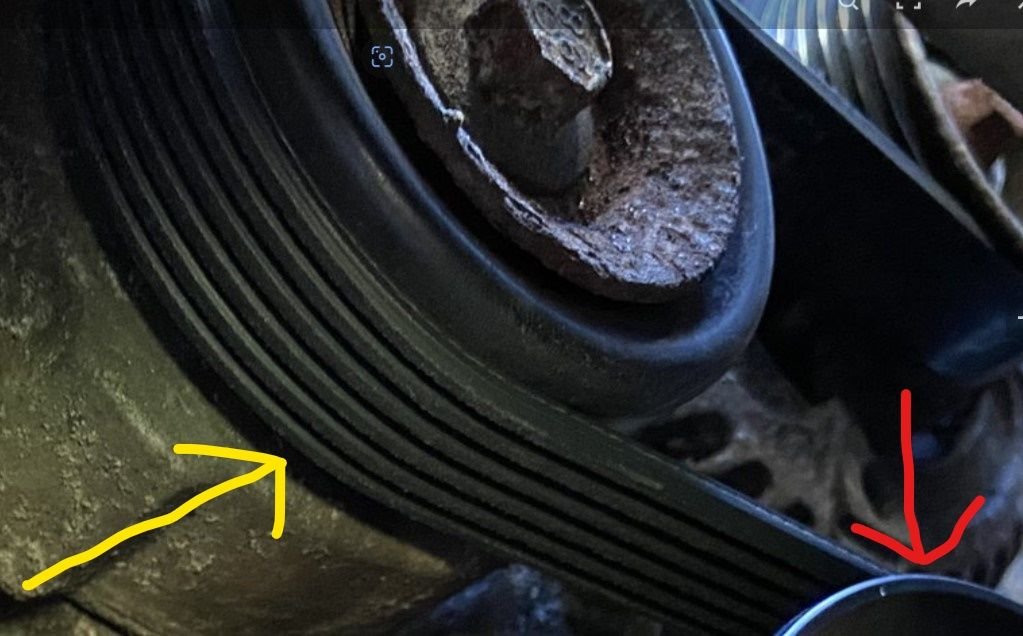

Just curious, you are sure the timing belt & supporting components were replaced?
I only ask because the crank bolt does not look like it has been touched in years? Maybe it's just because of the rust development, over the last 15K, from salty roads?
In addition, it does look like the power steering pump belt (yellow) has been replaced as well as the whole ac compressor (red).
A/C Compressor - 2006 Acura TL 4 Door BASE (NAVIGATION) KA 5AT (acurapartswarehouse.com)
I agree, it does look like it hasn’t been touched. My father in law owned the car. He’s not a car guy but he is very religious about maintenance. I spoke to his long time mechanic and they read me a list of all that was done exactly at the 200k in 2018. I can only assume they’re being truthful.
But the sound is definitely coming from oil filter adapter. Wondering if the oil pressure switches mounted on that could be the cause of the sound. I’m not losing any noticeable oil and no warning light.
