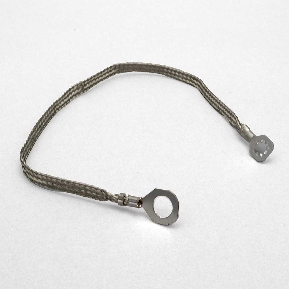

So I opened my hood today and noticed something interesting. I saw that some wiring was coming apart. Not sure what the function of this wire is and what is connected to. I drew a red arrow to show what I'm talking about.
My questions are:
1) What is the function this wire?
2) What is it connected to?
3) Why is the wire stripping?
Thank you for those who can help me find a solution to this in advance.

Ground.
looks like corrosion got to it.

yup...should be a copper/bronze color.
corrosion city.
Old Mar 15, 2011 | 08:55 AM
Find some 4 gauge wire and replace it.

You can buy grounding straps from auto parts stores too. Just measure how long you need it to be.

To make sure that the electrical parts on the engine have a negative current for operation. Unbolt the piece and replace it. I imagine that the Acura dealer will have one if you want an exact fit. Otherwise, any suitable ground strap will do.
Old Mar 15, 2011 | 03:40 PM
You can see the two bolts holding the ground.
if you take these two bolts off, the ground wire will come right off.
Replace it with another ground wire, or as JDA mentioned, grounding straps...

I was looking through oemacuraparts website and try to look for this ground cable. Can someone please confirm this is the right ground wire.
CABLE, SUB-GROUND
Part number: 32610-SDA-A00
https://www.oemacuraparts.com/index....WIRE%20HARNESS
Thank you.

that's one #9, but also #8 is another major one too (but yes the one you show in the pics is #9)

number #9 is the part number you posted, the
CABLE, SUB-GROUND
then #8 is another major ground for the engine on the OPPOSITE end of the engine/transmission (it kinda sits buried down below the intake tube), and considering the ground you posted looks how it does, this ground (#8) probably looks in the exact same type of condition also
and as mentioned, you can also just go get some cable and make it yourself, or buy an universal one, but considering the price for OEM direct fit ones, not really worth the hassle to make anything else fit
