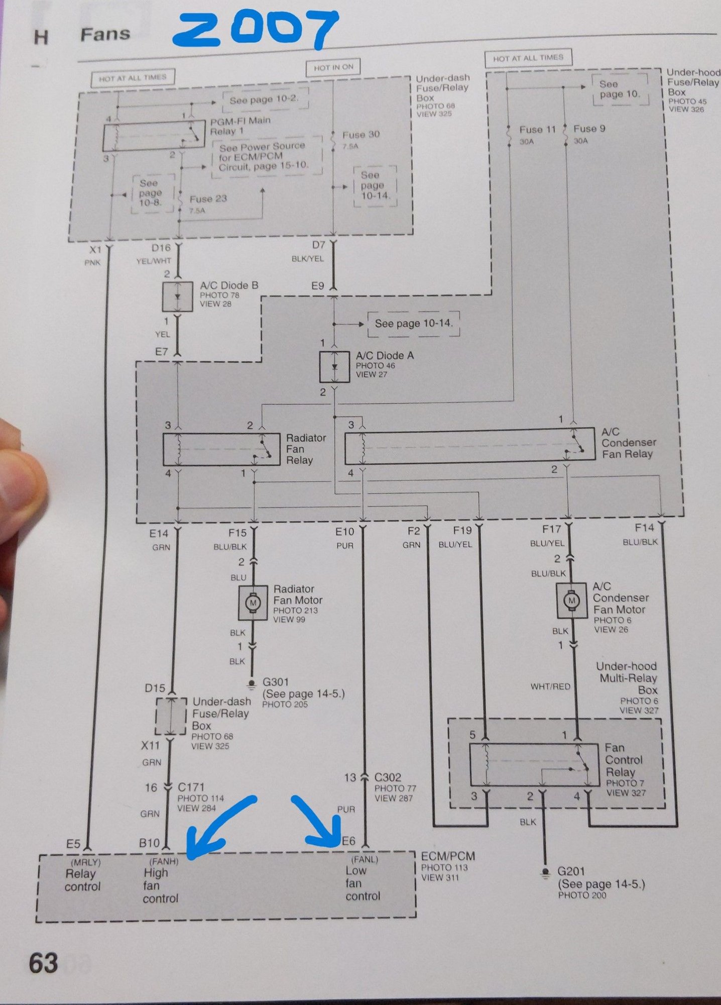

question should both fans be spinning when AC is on only my driver side spins when the AC is on the right doesn’t spin

if your car is cool, merely turning on the AC won't automacially turn on the Fans. But I think the AC MUST be On in order to have the 2nd fan turn on. Because per the drawing, there is a FAN LOW and FAN HIGH.
And the fans are not just "tied together". Both fans are controlled independantly.. And both FANs have different names on the drawing. 1 is Radiator fan and the other is AC/Condenser Fan.
This is for 2007 TL
Below is NORMAL operating temperature. It literally has never moved for Years... (Except during intitial start up)
2005 TL with a 2007 cluster

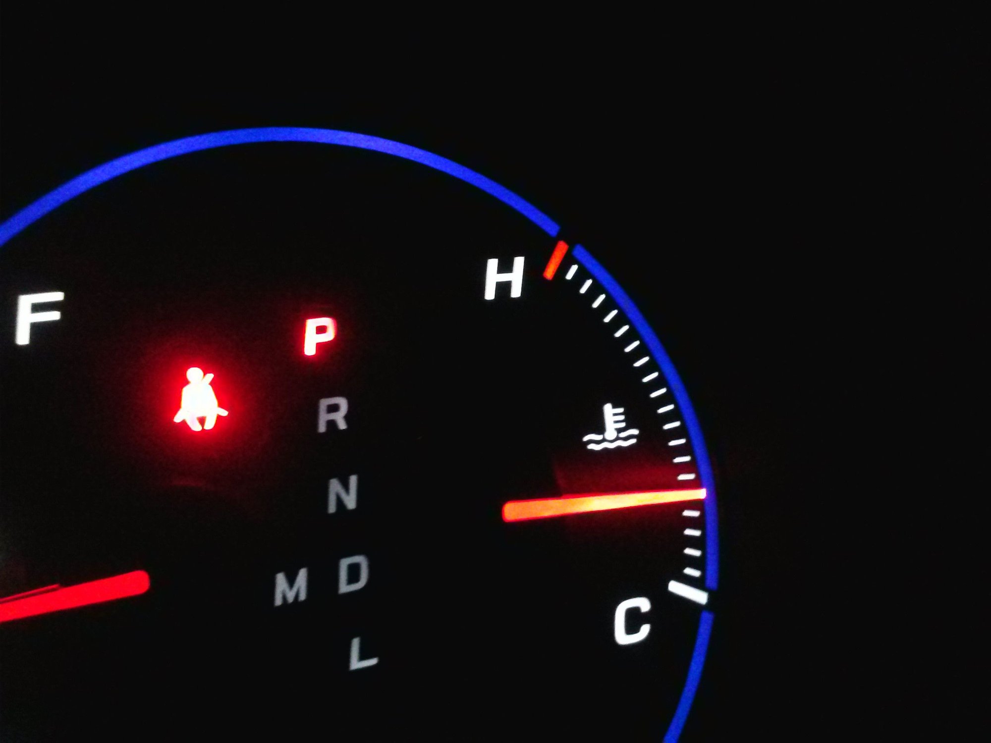

Old Apr 10, 2025 | 11:16 PM
Deadlocked3545's Avatar
Joined: Mar 2020
Posts: 16
My TL and TLS have always been at this temp
Old Apr 10, 2025 | 11:22 PM
Chad05TL's Avatar
Posts: 3,473
Likes: 190
From: Dallas
So what makes you think it's running hot?
Old Apr 10, 2025 | 11:49 PM
Chad05TL's Avatar
Posts: 3,473
Likes: 190
From: Dallas
these are pictures from wayy back many years ago when I had my old Speedometer. I had 54k and 73k miles. I have 135k now.
Both clusters (05 and 07/08) report about the same termperature..

that picture I posted is what my car is supposed to be at but when im idling with the AC on the temp will climb to 3/4 of the way

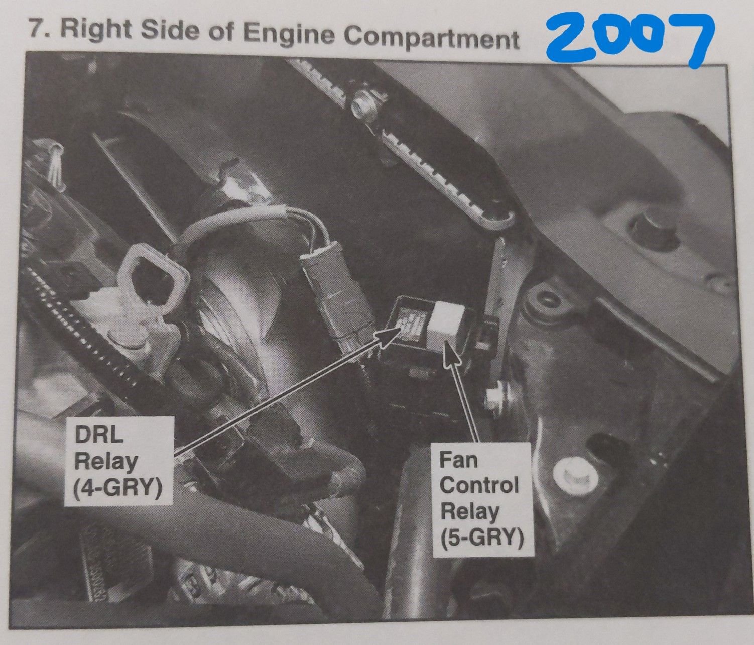

ok I see.. If it is getting this hot and the 2nd fan is not kicking on, then you may have a problem with that Fan or the RELAY.
As a test, you could do a temporary swap of the relay with another relay that you know is working.
Also, verify and/or do everything else I said above.

Here is something you may try before replacing the FAN. Swap out the "Fan Control Relay" with your base TL. But make sure the part number is the same. I do not know the part number.
This is photo #7 as seen on the diagram above.

i’ll do that as soon as I can before changing the fans out I appreciate it all the help

any check engine light? If so, have to read the codes first. But in the drawing below, I think the passenger side is called the condensor fan and the drivers side is called the radiator fan.
Make sure you have the right size fuse in Fuse #11. I cant read the drawing but it should say on the Underhood fuse relay LID.

oddly enough the Fan control relay had gone bad again probably just a faulty one. I replaced it when you had suggested it last time. swapped it again and the problem was fixed. I was worried for a sec
