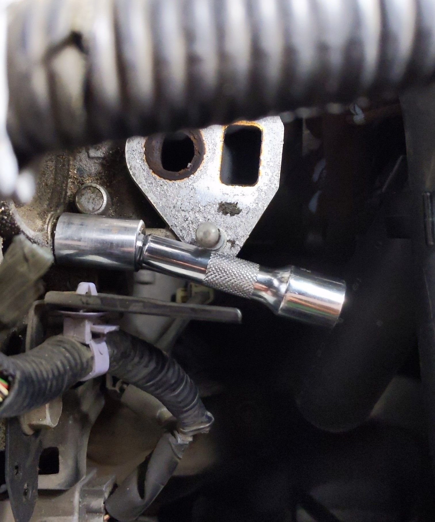

I just did my front cam cap seal and replaced the temperature sensor. It took longer finding a 12mm socket that was short and not too thick than anything else. I think a 15/32 socket may work ok if you do not have a 12mm.
I did exactly like like the Video with a few exceptions.. (The EGR comes off really easy).
After I removed the screws on the cam cap, I tapped the cap around the circle about 1/2 inch or so, just like the video.
But I used a large Hook on the bottom edge to try and pry it out straight.
When reinstalling the cap, I tapped it directly inward on the center of the cap very lightly with a hammer, so that I didnt force the cap in any picular positions and it went it pretty easy. It is not pressed as tight as a ball joint..
I also did not use silicone. I just used a little bit of oil that was already inside the cap. Just use you finger and get it wet, and spread it around the new o-ring.
The old o-ring was hard and didnt want to stretch off the cap. But the new one was very easily to install.
Note: 1 of the EGR bolts is right smack in the way. So I used an extension that has a "Rounded tip" so it swivels. I bought it at harbor frieght. (see pic)
