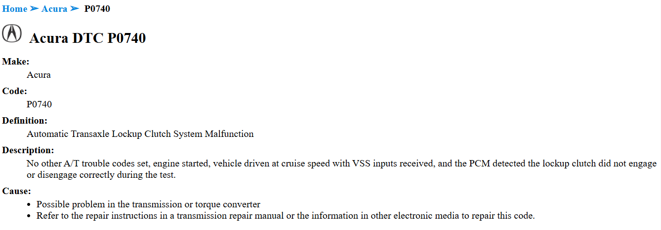

One way to narrow it down is in relation to the specific DTC's, pertaining to transmission malfunction, the ECU is triggering.
For example:

After swapping the solenoids there are no DTCs. Left on for a brief period of time, around 10 minutes.

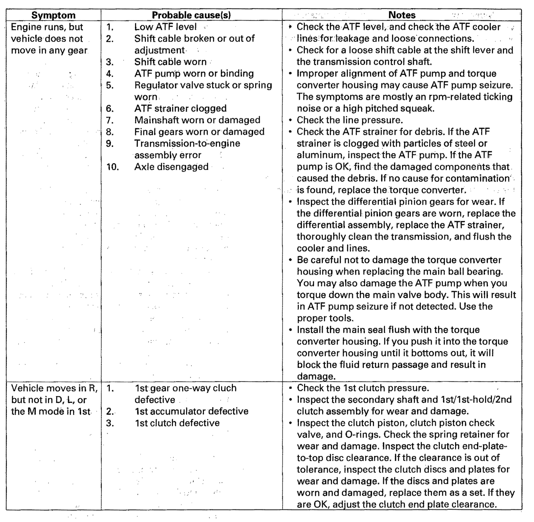

It sounds like a fluid pressure issue, have you checked the trans filter and the banjo connections for debris? Lack of pressure can be caused by worn out pump or debris blocking the lines. Makes sense why it would work fine after the car has sat, the debris will settle over time.
Dropped the pan about two years ago, fully swapped and cleaned.
Even the condition it was in was optimal. (roughly 240K, bought used)
Change in gear is outright non-responsive on a decreasing timeline. No errors.
Gamble on the computer before the filter.
We'll see, it will be reported.

Sounds like a bad ATF Pump, you can always check 1st gear pressure or line pressure to see if it goes down after the trans is warm. With 240K and these trans having issues internally on the hydraulics side, you got a good run. Sonnax makes good kits for rebuilding and fixing issues.
Perhaps, but this is another suggested outcome that only partially correlates to the previous response.
Wouldn't it be receiving a code in some of these conditions?
Changed the suggested filter at the same time as the pan filter.
Will poke around, but providing a link to your source would be great.
Thanks for your input.
