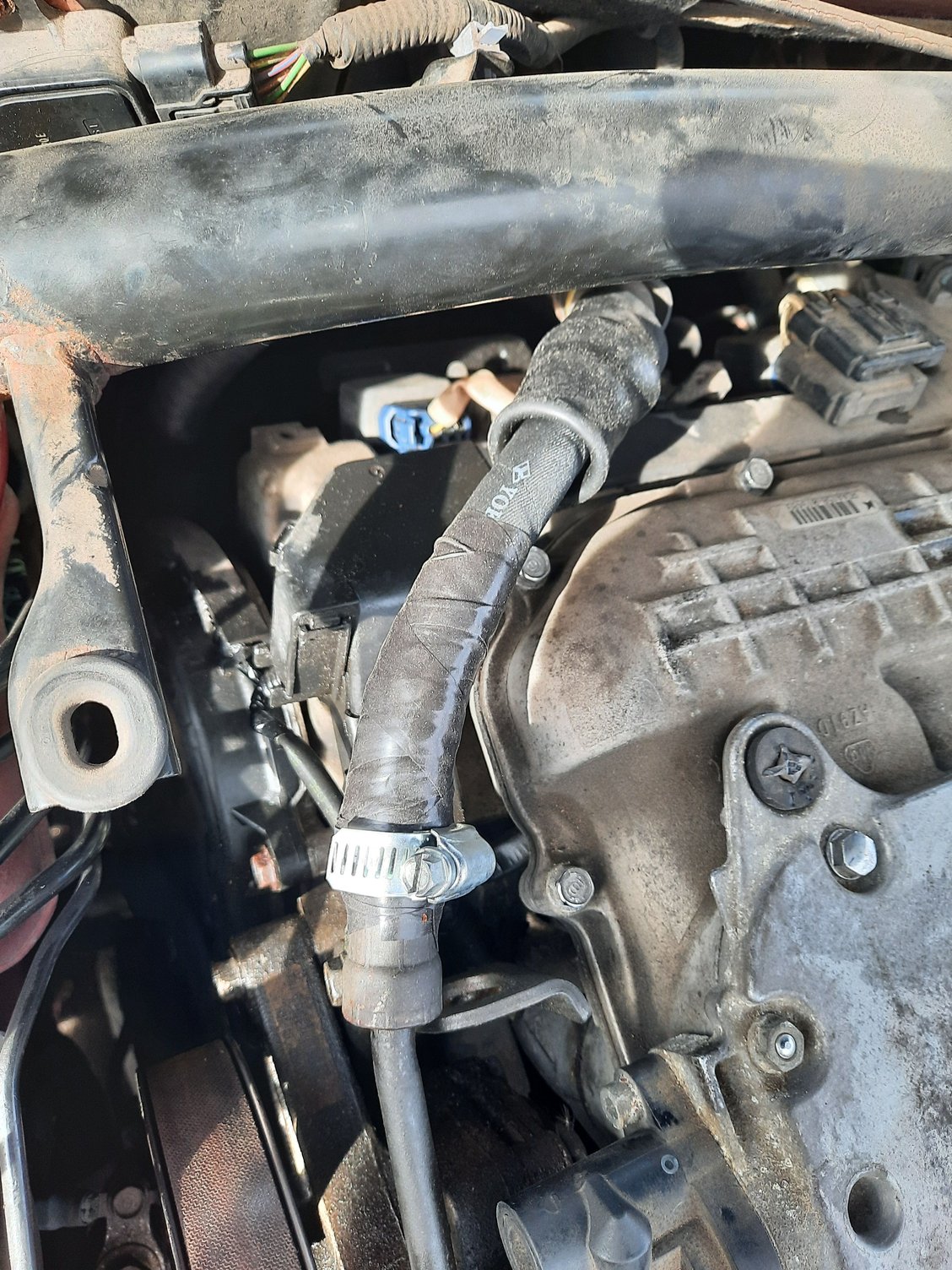

Did someone manage to patch it rather than replacing. It is leaking somewhere in upper area close to pump be it crimp fitting or hose itself. Patch maybe with tape? Maybe try to crimp metal fitting more with players? Rate of leaking as is right now need to add from below of minimum to little over max Honda power steering fluid every 5 weeks. When is below minimum pump is noisy.
What kind of tape could I use?

I guess if I go whit new hose I can go Sunsong from Rockauto for 36$. At youpull it is 6$ per foot for such hose and it would be 30$. Do not wort dig there for 6$. Other option at rockauto is Edelmann for 65$.

Don't bother trying to patch it. The high pressure side of the p/s system will blow any patch you try right out, even when using things like metal hoseclamps. Ask me how I know...
I generally like Edelman for aftermarket p/s stuff. Worth paying extra for quality.

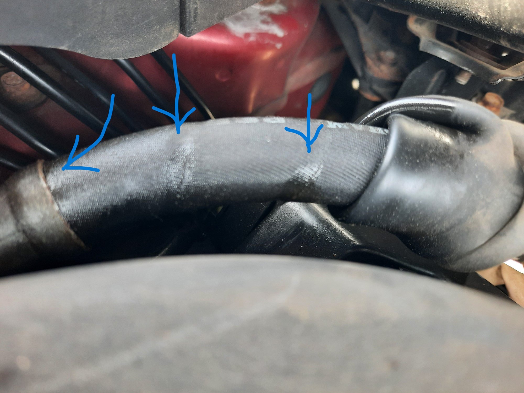

Cleaned that area of hose yesterday and checked today after driving and it look like leaking on 3 points.

Wrapped it with "Rescue tape" silicone self fusing. After 4 days it leaked somewhat but much less. Add one more wrap today. Open to leave it slightly leaking, would not fix. Just interior of that rubber sleeve that is around pipe get somewhat wet, nothing dropped from pipe down.

At some point you'll have spent more time patching that pressure line than it would have taken to replace it. Just sayin'
Edit: p/s fluid will eat the rubber on your serp belt. Don't let one problem cause another.

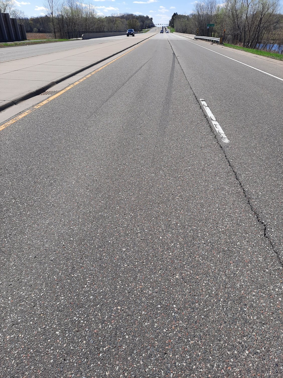

This s what happened past night. Was in left line (red line) other car little in front of me right line (blue line). Doe (green cross) tried to pass road but blue line car was on way and simply froze in my line and looked at my car. I was like 65m/hour. Stepped at brake to maximum and just slightly turn the wheel to left, maybe 5 degree. But it was enough for car to go all square across street with front wheels up at medium area. So far look that didn't brake anything but it was hard hit when i jump medium. At last doe manage to escape. Another deer was at side, another green cross.

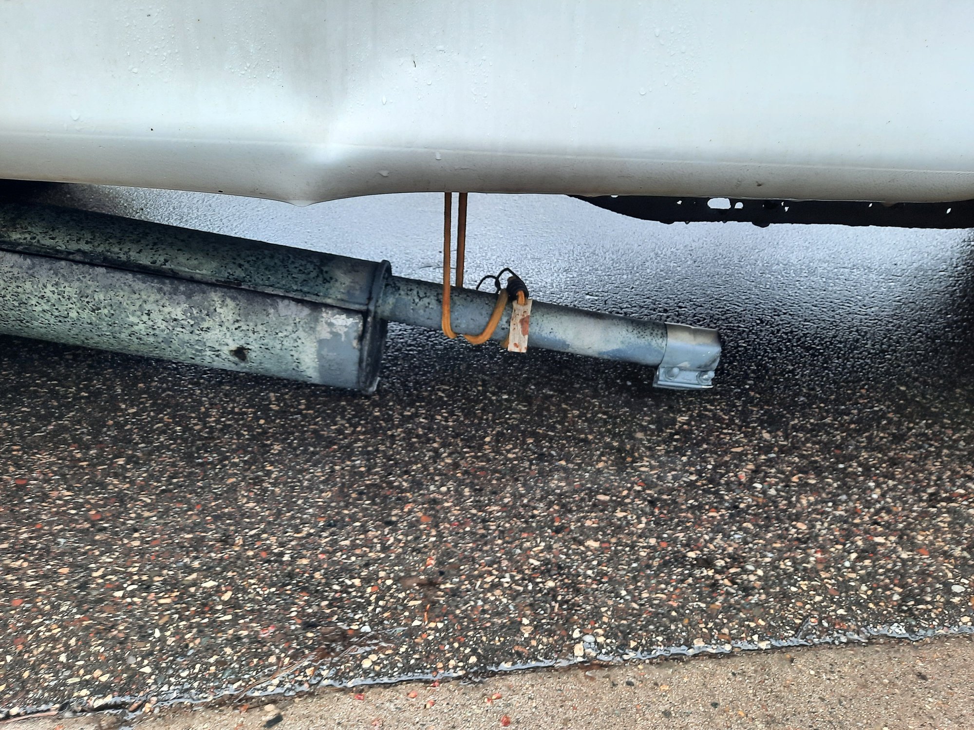

6) Past Saturday I did drove pickup from project in huge rain on highway. I hit puddle and water hit my exhaust muffler. Because I didn't thigh enough exhaust band clamp and muffler is hold by some wiring that I installed to hold muffler part of exhaust from band clamp to back fall off and I had to stop at highway in huge rain and work at connecting muffler to frame just so much that I can go out of highway. Did so went to local bar for 3 hours and temporary attached muffler to frame better than in photo and fixed that at home next day.

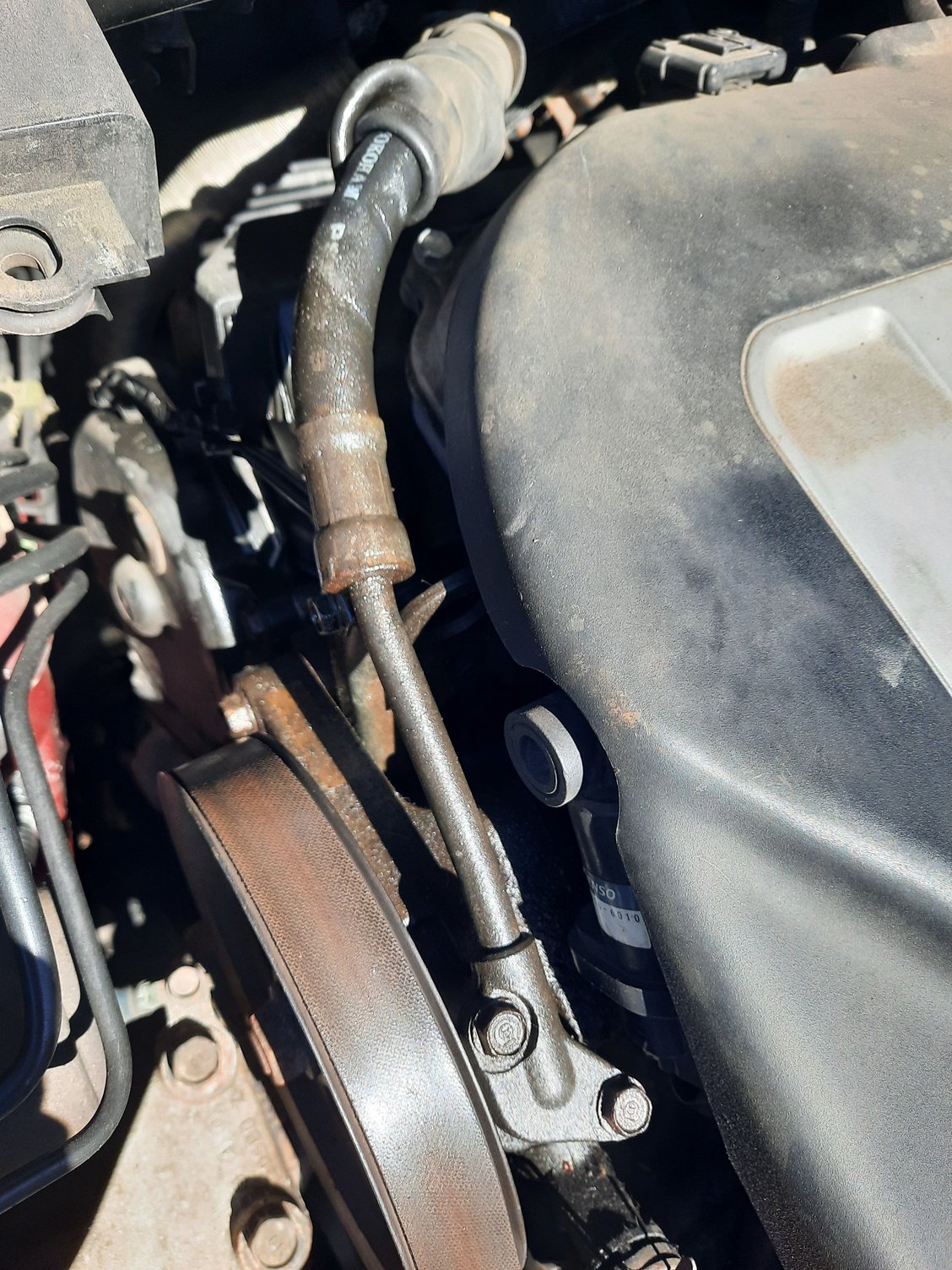

Power steering hose is leaking even after second wrap of it. So will order new and replace. Will just go at youpull to see what is there. Like to take parts there because if I will brake something I do it there not on my car. Leak is not so big can wait for new part.

What is that yellow cap for. AI say it is for temporary to prevent dirt come in when installing hose. But cap look smaller in diameter than that hose flare nut.
