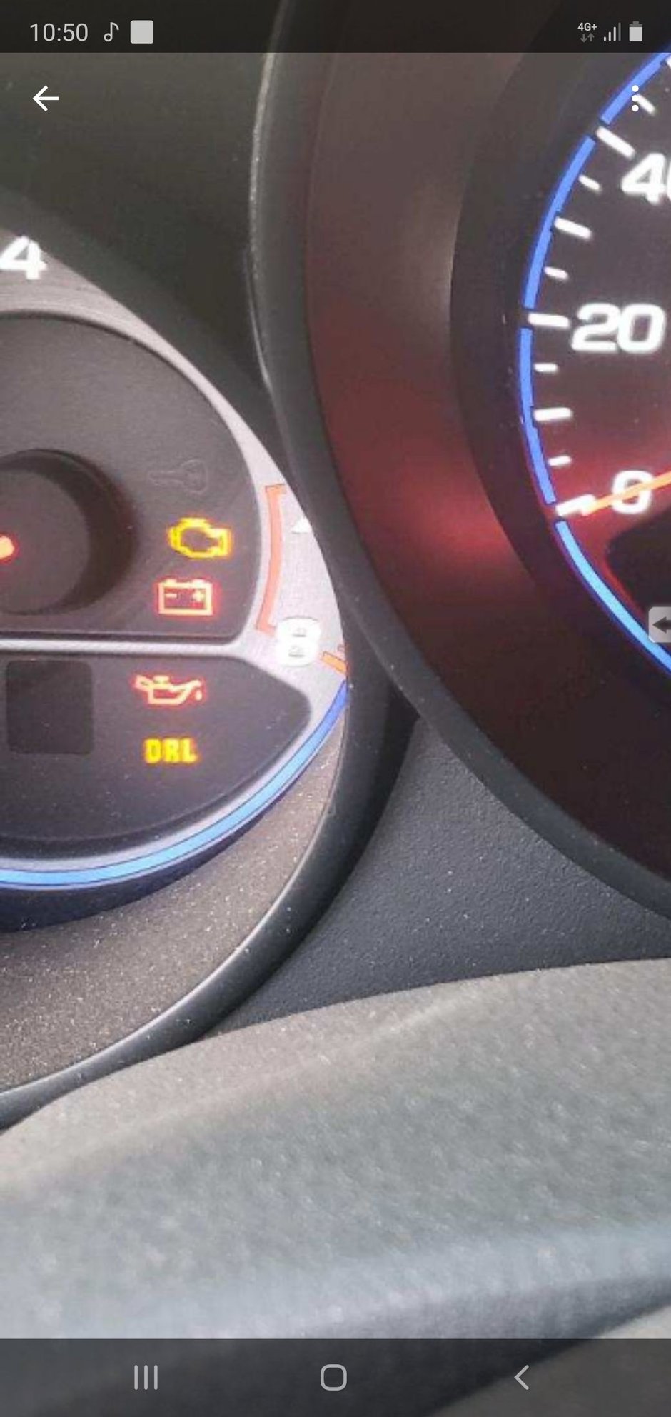

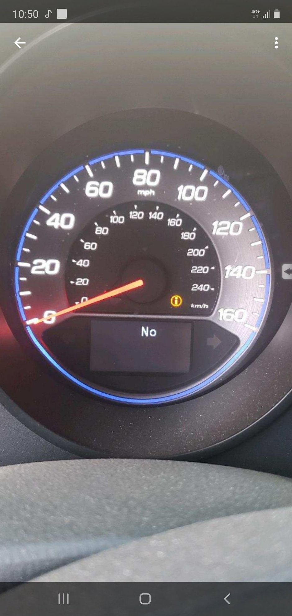

Sorry took so long.
Here is the infamous No dash, never thought an engineer would implement that lol
Also a couple of other lights i noticed, check engine etc. Odd because when i ran the odb nothing showed up except for the dlr, if i remember correctly

Thanks a ton for the replys guys, took me a while to get the picture because car is at the shop still fixing stuff. Ok the lights notification is cool because headlights are melted and getting replaced. Definitely going to fix the brake issue, i actually bought a 2007 parts car for this at an auction, well second one even because i didn't know 06 and 07 are not compatible with some parts, the first one was a 06
. Wire harness, engine, tranny and who knows whay else.

They say so much about Japanese attention to detail, and yet they didn't even center the "No" properly hah.

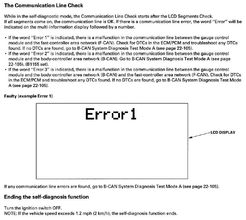

Guess gauge cluster must be not happy for some reason. Perhaps it can't communicate with other modules. If you have bi directional scan tool, try to talk with it. Did it came from another car? Or did you replace anything else, like micu, ecu, etc.?
Try using self diag. You are mostly interested in communication line check.

Thought it was funny as well. I wonder if OP can scroll through the other menu options..

Ya, funyy for sure, no not centered lol Ok i will try to communicate with it, i got all the cpu stuff to change out if necessary still in the parts car. I will try to push the dash cluster buttons to see if scrolling through is working, i would assume 'No' lol

Was driving for the first time in a while for smog and after a few miles the car started to hesitate a lot and a bunch of lights on the dash turned on even air bag lol , i thought it was the tranny slipping because of the way it wasn't shifting into second and then would shift hard although when i let off the gas completely all the lights on the interior would dim and begin to fade completely and car almost turned off, so i thought maybe the battery cables even though the battery had been sitting for over a year thought the alternator would bypass that for some reason , anyways a bit of wiggle on the cable partially fixed that, still happened though. So i sanded the inside of the part that clamps around the positive thing on the battery because cables looked fine, and what do ya think about this. Then the infamous 'no' is gone and can see everything normal again! funny because i was on my way to the original mechanic to have that looked into, not no mo lol

That's typical when there is a voltage spike or drop. A dead battery can kill even a new alternator as they are meant to top off battery and not fully charge. Add some distilled water to your battery too.
