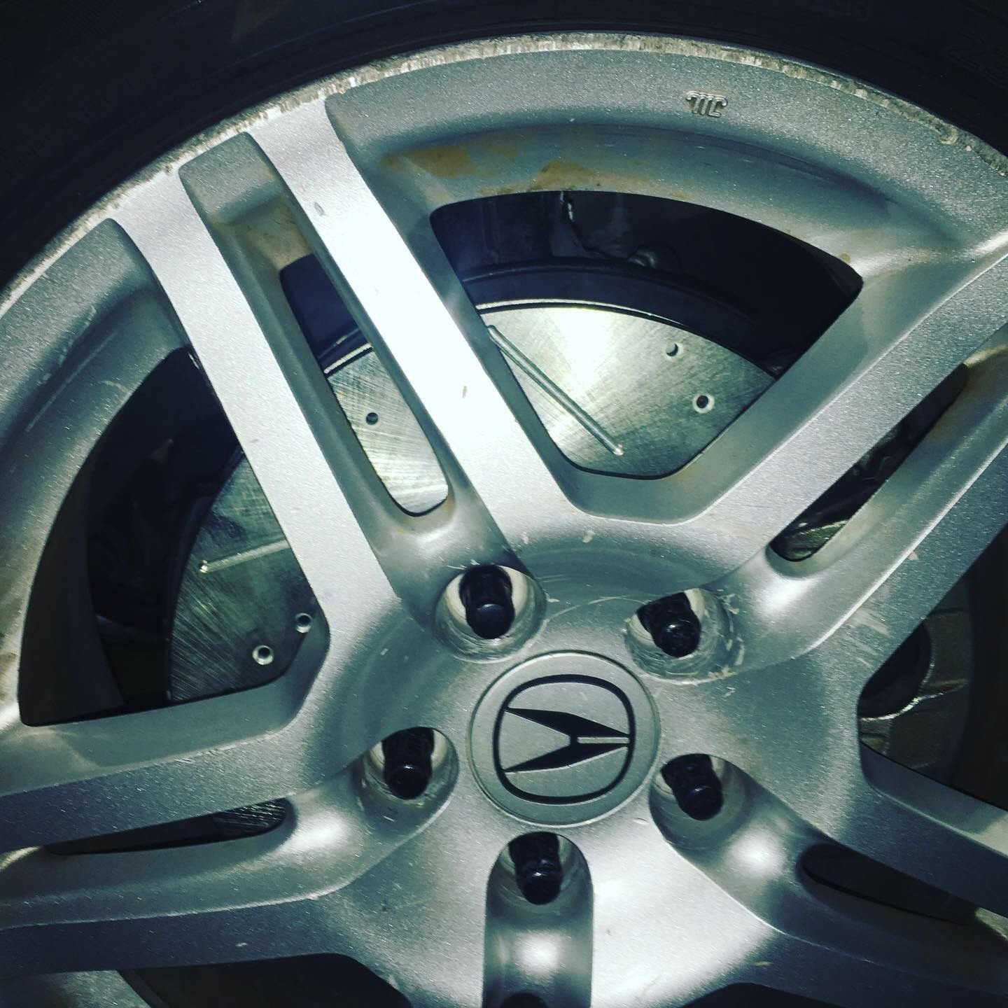

Old Feb 7, 2019 | 01:28 PM
3rdGenTLlowlife's Avatar
Joined: Aug 2018
Posts: 32
From: Dallas, TX
Almost done
Front coils in and adjusted HIGH. 2.55” and it’s still scraping a little. Backs will be in this weekend with new hubs and ball joints. Getting an alignment next so my new tires don’t die. Got the front drilled and slotted rotors and new ceramic pads in, they’re super quiet. The injen intake is doing wonders on gas 26 mpg city when I take it easy. Here’s a couple pics
New rotors and tires
Raised to 2.55” measurement on tein street advance z
New wheels and tires
