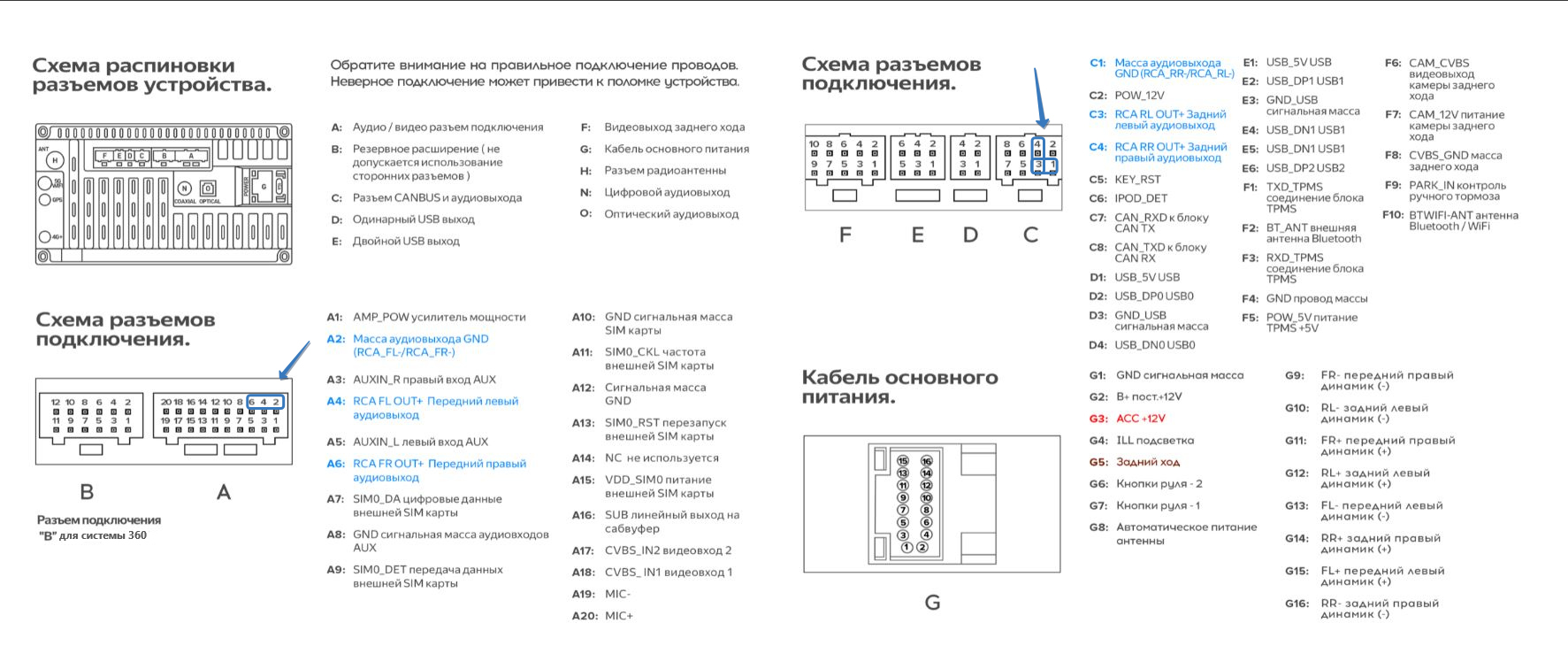

LED Replacement/Switching Cables
LEDs Replaced
​​​​​I finally got around to replacing the button LEDs to white. I wouldn't recommend this unless you're good at soldering but it is possible. Components are very small and it was almost impossible to remove the original LEDs. These use 0603 SMD LEDs (bought some on AliExpress for $3). I have the board marked with + - for you guys if you want to try it for yourself. I used low temp solder paste to not risk damaging other components. You have to remove the back (5 screws, only the ones attached to the back plate only) then 6 screws holding the board in place which you can move to the side (the mic cords are ran through the hole in the PCB on the right). Be careful when lifing the back off, lots of ribbon cables and it's not fun if you break one.
LED board/Buttons
LED side of LED Board
0603 SMD LEDs
New LEDs (ignore the bad soldering job)
​​​​​Updated Cable (20 pin)
After doing some research, I discovered that our units could use different cables since these are generic FYT devices. I bought one off AliExpress with the sub output and mic. The downside to this one is that it doesn't have the SIM card pinout. However, there is also a sim slot in the back of our units that you can try to use alternatively. There is still just the front outputs, no rear (oddly, 2 x front outputs for some reason but same pins). The rear channels are in the 8 pin adapter that has the canbus. I have another harness coming in for it. Sub output works with our units, pins seem to be correct as I expected.
New cable
Old cable (Original that came with it)
Old cable attachments
New cable attachments
New cable attachments closer
Sim slots
Sledgehammer_01 (04-20-2024)

Awesome, I knew there had to be outputs for the sub and rear channels, just ordered the cable.
I know its a lot to ask but would you be willing to draw the pinnouts for the connectors so we can all see where the sub out, and rear channels are?
Thanks
Thanks
Luckily for us, it uses the same pinout as other UIS7862 FYT units.
Why are the rear channels labled ASL and ASR and not RCA RR, RCA RL? Those abbreviations are typically for Automatic Sound Leveling and Auto Sound Reduction, have you confirmed that those pins are outputting low level audio for the rear channels?
Only the 20 pin has come in so far. The 8 pin should be in soon. As for the pinout sheet, it came from 4pda so most likely translated from Russian. The other pinouts that's in mostly Russian has them labeled as RCA RR, RCA RL.
I really doubt these units have ASL or ASR, especially since other units with these boards use those pinouts as RR and RL. I am obviously going to check the output when it arrives and will get back with the results to verify
The following 2 users liked this post by icemint.asa:
mariusz439 (04-21-2024), Sledgehammer_01 (04-20-2024)
