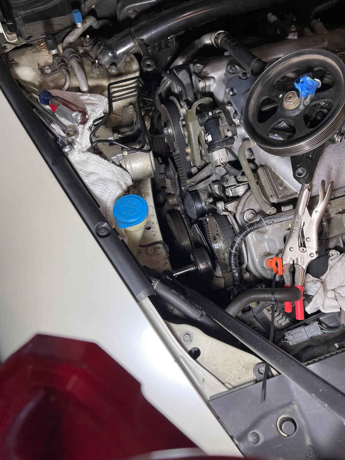

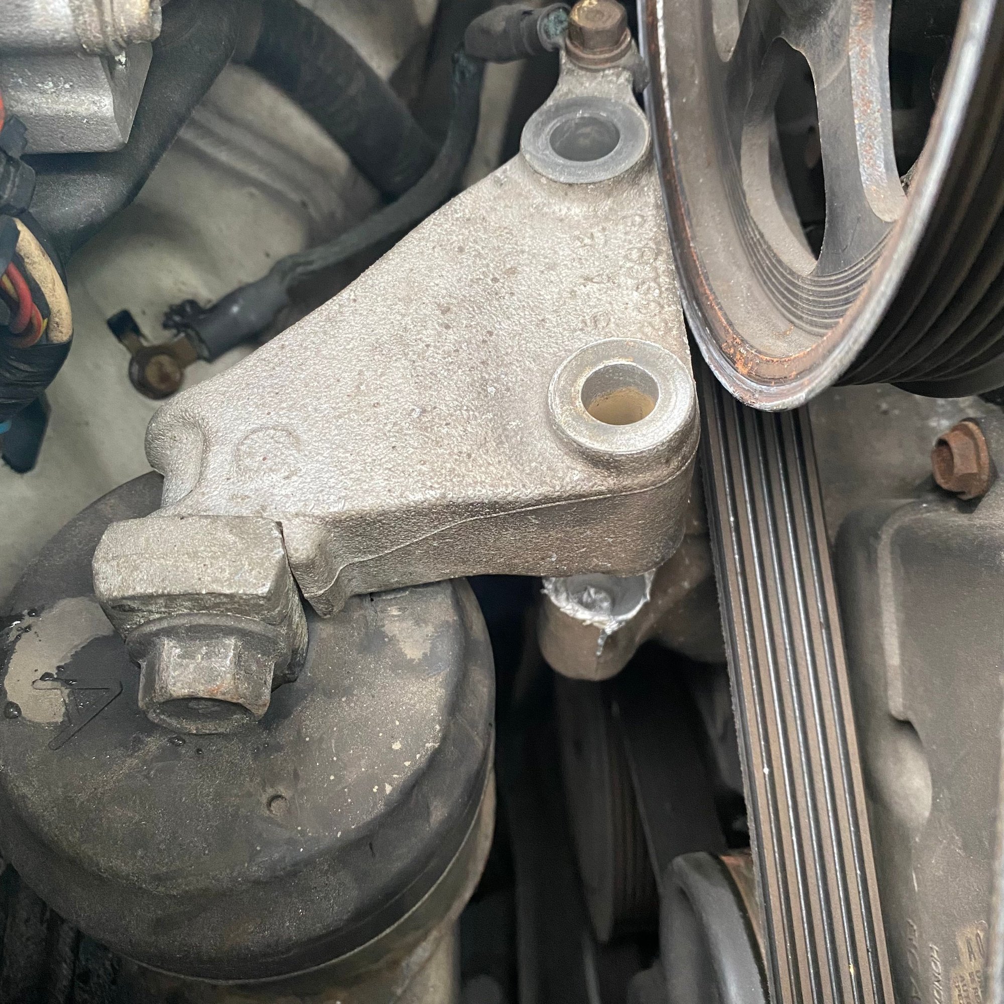

So my side engine mount has come loose, the bolts came right out of the threaded bracket below. As you can see in the picture, the bolts (which are fine) are out of the bracket, and that top bracket is ok, but the bottom part with the threads is obliterated. Has anyone ever replaced this? Simple procedure or does it require removal of the accessory belt?
2nd image is after I removed the mount itself and the top bracket. Can't seem to figure out how to get that bottom part off, I'm hoping it's not part of the engine block??

Looks like #5 engine side mounting bracket (11910-RCA-A00) is needed. Those thread ends look pretty trashed.
Cylinder Block - Oil Pan for 2006 Acura TL | Acura OEM Parts
Car-part.com might have one if you can find a salvage TL local to you?
Need to remove bolts #29 & 30, through the WP assembly, to get it off.

Pretty sure you need to take the timing belt covers off as well. Or at least get them loose.

...and the bolts are fine?
My brother would drill them out and run thru-bolts with washers and lock nuts. But he's really cheap...

steel bolts over torqued on aluminum bracket probably. there is a pretty low torque spec on those.
long bolts with a nut will work while you source a replacement.. just be sure to use same strength or greater bolts and nuts. i've had to do it on an old motor that someone ruined a bolt hole on the engine side mount. ran it for years. shouldn't have to drill it unless its cross threaded. use the same thread pitch and the nut will grab it at the bottom.

I repaired the threads on mine. Definitely verify the threads on the bolt if you go this route but I am fairly confident they were M10x1.25 (M10 is usually M10x1.5 so it is a fine thread bolt). I used a heli-coil style threaded insert. It's been over a year so I can't quite remember the details, other than I had difficulty getting a drill in there to drill the hole. I either removed it, removed whatever was in the way to be able to get the drill in there, or just ran the tap in without drilling. Other than the initial trouble drilling it wasn't terribly time consuming/problematic and it's held up fine for probably a year and a half now.
Those threads look pretty trashed though, if you are considering a repair vs replace I'd definitely ensure the holes aren't larger than the drill diameter for the heli coil.

I replaced the bracket your talking about, I removed the belt, power steering lines, power steering pump and the Power steering reservoir to access it. Also had to remove the top timing belt splashguard to get to those bolts.
