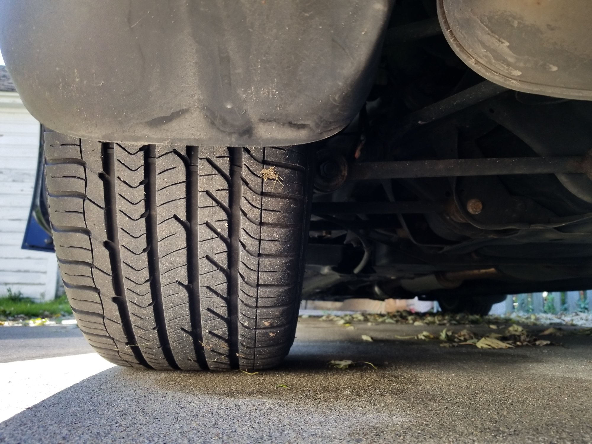

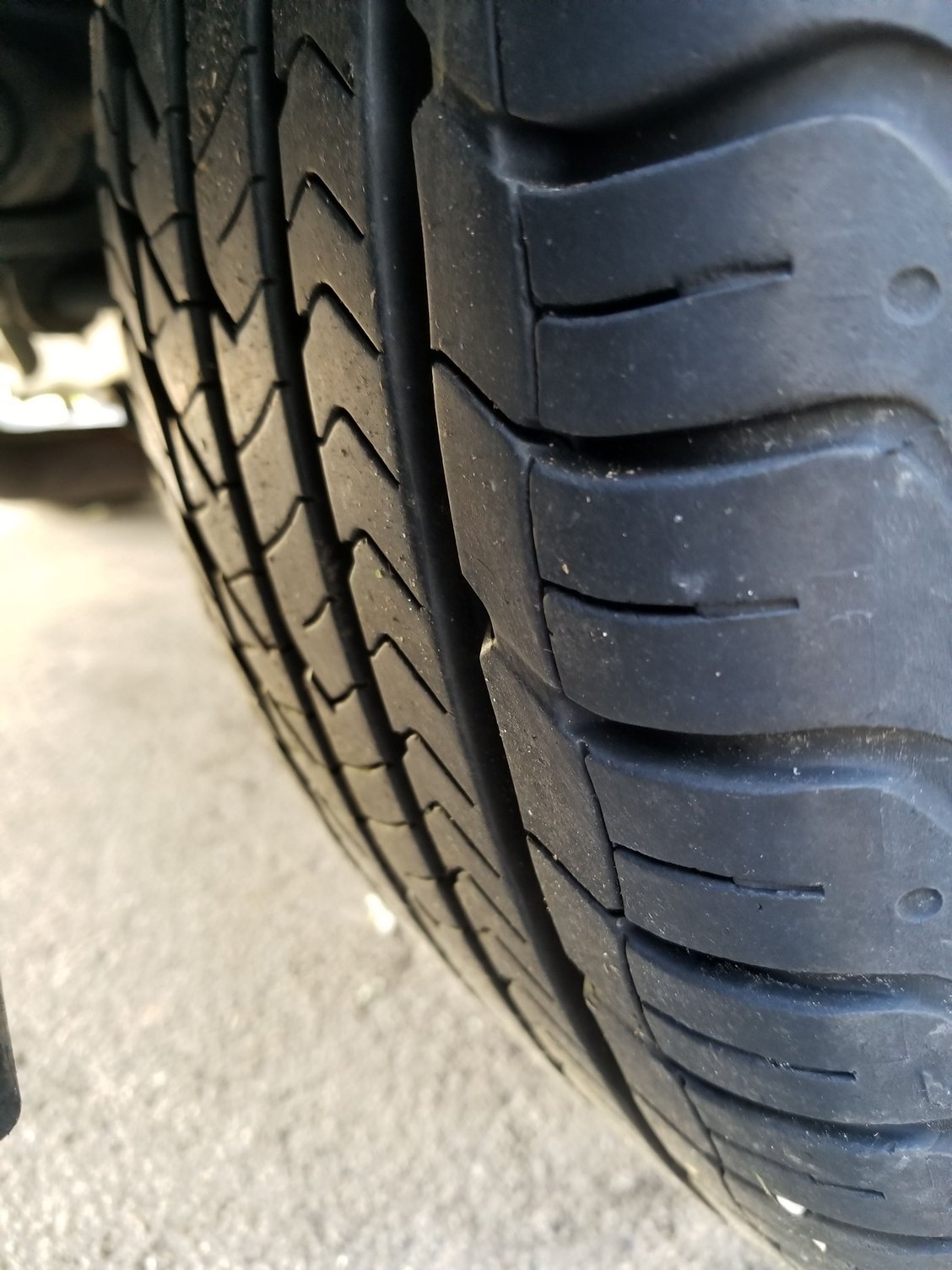

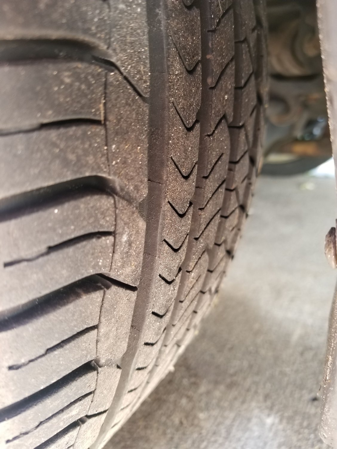

well show us what your tires look like so we can make a better determination

Here's some photos of the tires

Here's the pictures of the tires:
Old Oct 16, 2018 | 01:32 PM
Posts: 48,312
they don't look too bad, possibly just minor negative camber.. Do an alignment if you haven't yet and i bet you'll see you'll need to zero our the toe and just minor (maybe -1.2 - -1.7 in camber.

I'll post whatever the shop does xD what am I not seeing? To me they look like normal tires in good shape

My old tl would not go back into spec due to camber. I suspect it was due to the old springs not having as much push as they used to but I may be wrong... Ate my tires pretty quick. Your dont as bad as mine were though.
