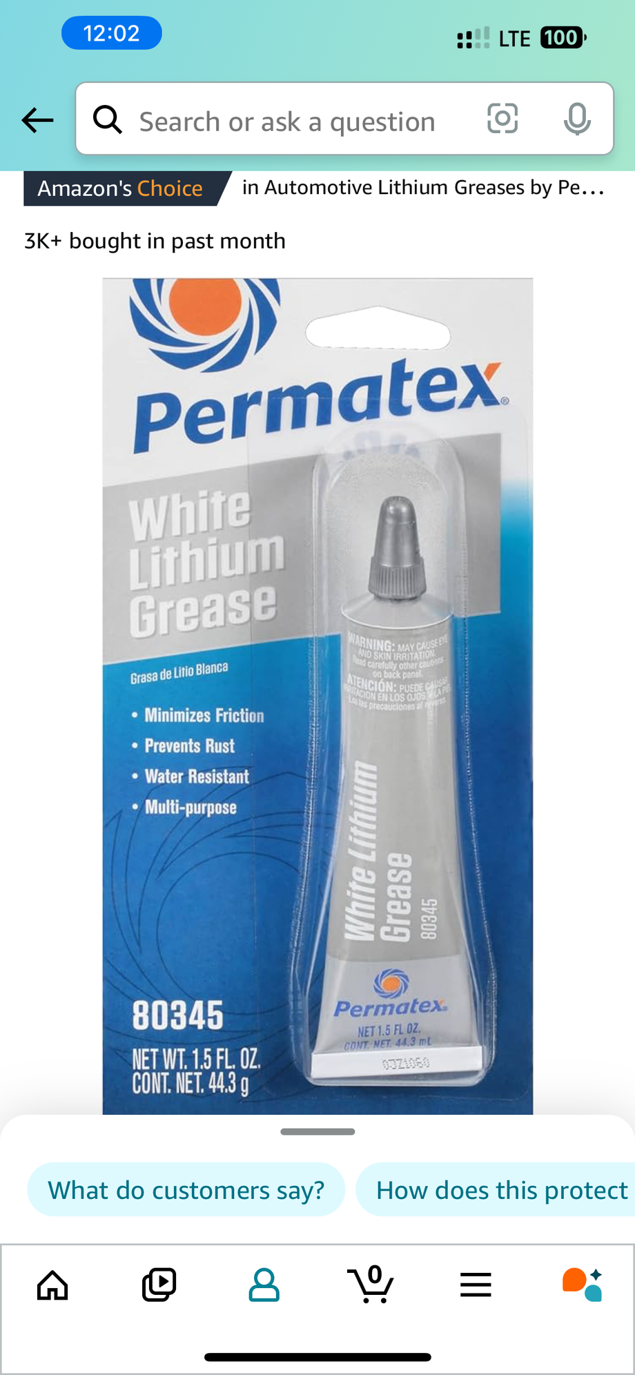

What lubricant did you use for the actuators? I have plenty of silicone spray, but I typically use that for any kind of liner.

I'd prefer Shin Etsu Silicon grease over lithium based formulas for applications on plastic. I bought a tube many, many, years ago to do the same job on my mirrors. Works great on all manner of things in the car especially keeping weather seals supple. Also keeps them from getting stuck to the door jams in wet/freezing conditions if you are in a cold climate. It's available on Amazon and one tube is a lifetime supply. But you are prob fine with what VictorTL pointed out. I think you will just get more uses out of the Shin Etsu.
