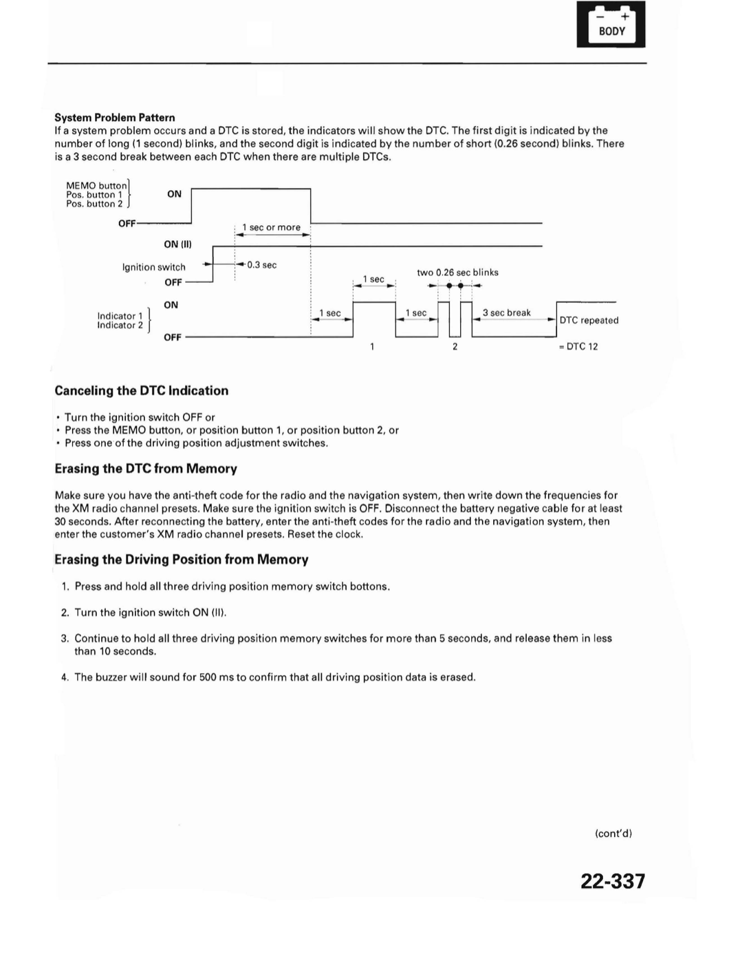

There's nothing in the Owners Manual or the Service Manual that I can find to address the annoying issue.
Any other ideas short of disconnecting the battery, running around the car clockwise three times, hooking up the battery and running backwards around the car counter-clockwise three times??

Welp, I went through the remote process, which worked for the remotes unlocking doors, etc, but there was no change to allow setting change or recognizing Driver 1, 2...so back to the drawing board.
