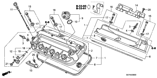

2007 Type S 5AT, currently with 204,011. Daily driver. I am going to have the whole timing belt/water pump work done again in June. Using the Aisin TKH-002.
I DO have a valve cover gasket leak that I wanna have taken care of at the same time. So my question is...do I go with -
https://www.oemacuraparts.com/oem-pa...er-12341rcaa01
or
https://www.oemacuraparts.com/oem-pa...Y2LWdhcw%3D%3D
Old Mar 25, 2023 | 05:19 PM
Posts: 48,312
I would replace the spark plugs seals alongside the Vc gasket so I would go 2nd set.

the 2nd part you provided is a set with spark plug tube seal as well. I would replace the spark plug seal as well, don't forget to pick a fresh set of screw and rubber grommets that hold your valve cover as well.
As me how i know lol.
Ok I gotta ask then. Can't use the old ones? I can't fathom finding the part numbers for those...I'll be getting the https://www.oemacuraparts.com/oem-pa...Y2LWdhcw%3D%3D but you suggest more?
Old Mar 25, 2023 | 10:53 PM
truonghthe's Avatar
Joined: Jun 2008
Posts: 7,967
Likes: 1,702
#14 and #15 is what you need, you can reuse the old one however the rubber grommet are prone to leak oil. Plus the screw are very brittle especially on the front bank where they subject to constant expansion and contraction do to the a/c fan/ radiator fan blowing on them.
You will break couple even torque to factory spec. I snapped 2 on my red one and hell with it that I am lucky that I bought entire new set, from then on I never reuse the old one.

Actually would this be wiser?
  1. Gasket Set, Head Cover
    $85.28
    Part # 12030-RYE-A01
    2x $42.64
  2. Bolt B, Head Cover
    $17.14
    Part # 90012-P8A-A00
    2x $8.57
  3. Bolt A, Head Cover
    $79.52
    Part # 90010-P8A-A00
    8x $9.94
  4. Washer, Head Cover
    $50.40
    Part # 90442-P8A-A00
    10x $5.04
I guess my question is don't bolts A and B already come with part 90442-P8A-A00, certaily looks as so. And the quatity says 10, same total as bolt A and B.
Old Apr 1, 2023 | 01:05 AM
jeffstlnote's Avatar
Joined: Aug 2018
Posts: 566
Likes: 172
From: Springfield, Missouri
Yea...I don't think I need #4 as bolts A and B come with them - duh my bad.

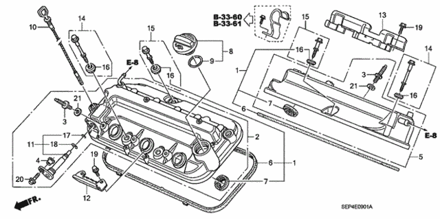

Are we sure on that 100%, because this certainly looks as if the bolt comes with the grommet. #15 in the diagram...I'm talking about https://www.acurapartswarehouse.com/...206MT&filter=()
Old Apr 1, 2023 | 02:15 PM
truonghthe's Avatar
Joined: Jun 2008
Posts: 7,967
Likes: 1,702
if you purchase #15 it will have the gromet pre installed.
Old Apr 1, 2023 | 03:14 PM
Joined: Aug 2018
Posts: 566
Likes: 172
^This is what I was wanting to hear and eventually found out. Thank you very much @truonghthe

Took a little nap this late afternoon (getting up at 3:05am M-F will cause that) and wanted to share something, thanks again to @truonghthe by the way,
So I will be doing the whole valve cover gaskets replacement.https://www.oemacuraparts.com/oem-pa...er-12030ryea01
And replacing all the bolts as well.
Bolts needed are the following -
https://www.oemacuraparts.com/oem-pa...er-90012p8aa00 x 2
and
https://www.oemacuraparts.com/oem-pa...er-90010p8aa00 x 8
The reason why I am kinda posting this is in case anyone wants to use the original bolts BUT change out the rubber grommets. Both of the new bolts come with the new grommets on.
The grommet itself https://www.oemacuraparts.com/oem-pa...er-90442p8aa00
So in my opinion if you're needing or wanting to do this, just buy the new entire bolt vs having to mess with getting the new grommet on. It's like $4 more per bolt, and just way less of a hassle.
