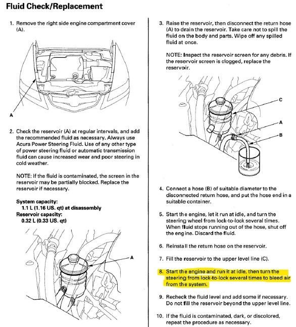

Originally Posted by PgLgGrg
May have been from me disconnecting one of the PS hoses to make space.
Perhaps, as a result of disconnecting one of the P/S hoses, air was introduced into the system?
Did you bleed the P/S system of air when everything was put back together & topping off the fluid?
Refer to step #8 below:

What did you do fix this? Just change the belt or?
And as for potential air in the system, I did bleed it yesterday when i changed the fluid. But still a little stiff when stopped and still have the whiny sound, but only prevalent at 3k and higher RPM
